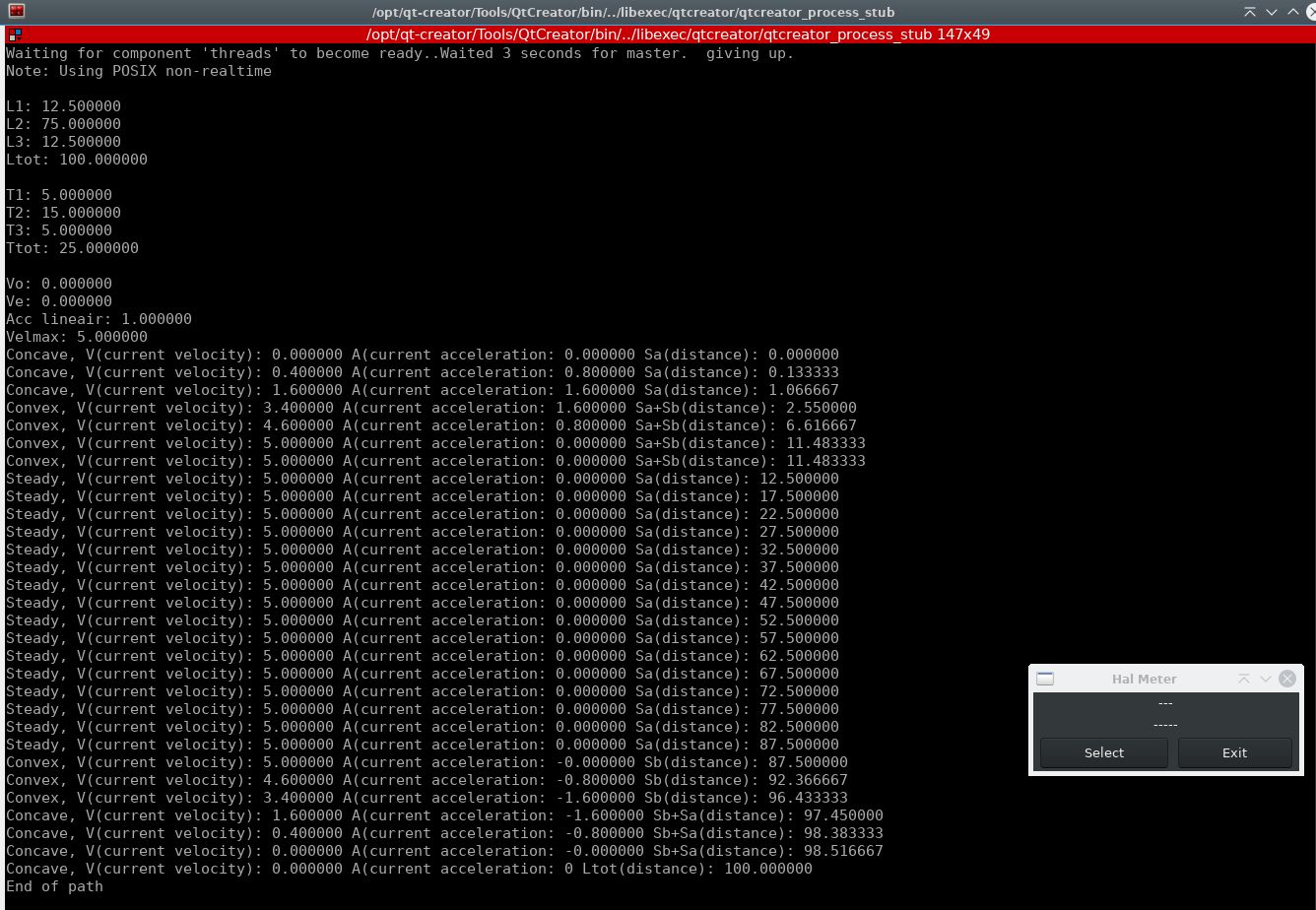

The problem of c coding or mathematical knowledge is solved.
Attached a component that uses a scurve header only library.
#include "scurve.h" to your component or c code or c++ code.
I think with this example users can retrieve all the info related to the scurve's acc, dcc, timestamp points, etc.
For interpolating on arc's just give the arclenght to the function. And then interpolate the result to the arc bow.
This can be done by % pathlenght interpolation.
The output is printed with rtapi into the terminal. This is done by setting the debug to 1.
The function call from the component, wich is a line (path) of 100mm :
Rtapi result :

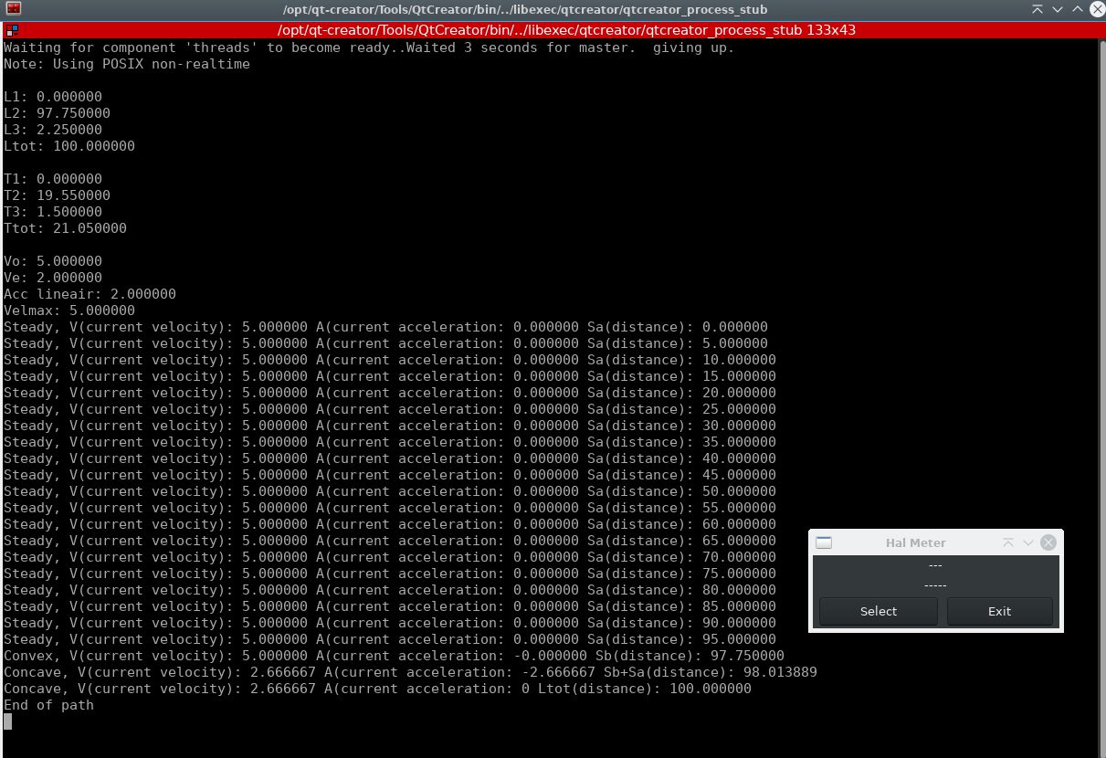

Now you can imagine what to do. Just play around with the code.
It has jerk, initial velocity and end velocity implemented. It has also a sampler if max velocity can not be reached.
Attached code is a "c kernel style" derivate from my original work at : github.com/grotius-cnc/S-curve-motion-pl...g/releases/tag/1.0.1
scurve(5, // velmax
1, // accmax
0, // vo
0, // ve
0, // xs
0, // ys
0, // zs
100, // xe
0, // ye
0, // ze
1, // time output resolution in sec, for example 0.001 is a point every ms
1); // debug 0 or 1Rtapi result :

Hi Arvidb,
Thank you for your reply.
I think you have to look at "V+=Traject.initialVelocity"
The plotted graph's at github show everything is printed ok when using vo and ve parameters.
If they where not ok. I would have seen that.
I spotted and repaired a rtapi print output with empty value's when T1, T2, T3 are 0.
Now it print's only when T1>0 , T2>0, T3>0.
Initial velocity and end velocity are just working. It was printing a empty value at line 0 of the rtapi print output.
So it was looking like a bug.
Here a function input as :
Mention the output resolution is quite low at a 1 sec interval.
scurve(5, // velmax
2, // accmax
5, // vo
2, // ve
0, // xs
0, // ys
0, // zs
100, // xe
0, // ye
0, // ze
1); // debug 0 or 1Mention the output resolution is quite low at a 1 sec interval.

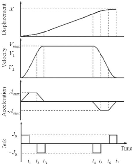

Hi Arvidb,
Rendement is like "the effectiveness".
I made a short video about the scurve graph.
user-images.githubusercontent.com/448801...7d6-c7dcf68d7db7.mp4
The grey line is now showing time versus displacement for point in x direction, to simplify it.
Point x is from x0 to ~x100mm in the video.
(ellipse = scene->addEllipse(T, p.x*-1*scale, 0.1, 0.1, GreyPen);
scale=0.15;
This is how it should look like :
In a normal situation we see a displacement as in above graph.
When doing exotic's we can end up with so called "kink" in the displacement curve.
Arvidb, In your point of view this "kink" is a bad thing? I don't have something like it's a bad thing.
scale=0.15;

Is it a idea to avoid this "kink" with a algoritme?
Are you able to implement your example in the qt code?
Do you have an idea how the lecture dealing with this "kink" in the curve, you would expect researchers have dealed with this
before?
It's quite hard to imagine when the velocity curve looks ok and the acceleration curve looks ok.
There could be a kink in the displacement curve in some "exotic" cases.
[edit] After some experimenting it occur's when intitial and or end velocity is not zero.
And that this "kink" is in fact a infinite acceleration stage. When using a 20Kw servo it could result in a machine shock.
