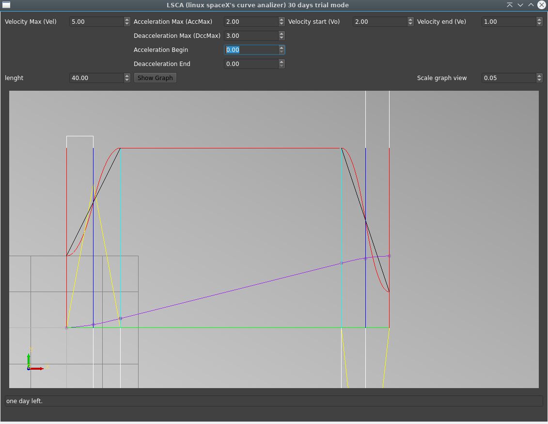

21 Jun 2021 06:26 - 21 Jun 2021 09:35 #212549
by Grotius
Replied by Grotius on topic LinuxCNC S-Curve Accelerations
Hi Arvidb,
Nice work. I will study your code soon !
I found the in-accuracy of the displacement value's.
I was calculating the (total) lenght's and (total) time of acc and dcc path's wrong for the scurve.
After a code modification all output value's seems correct now. The output is double checked with various formula's.
When studying the (new) attached document (paper), i came to the conclusion the used formula's are identical to the paper i first used.
Then i thought, the displacement in-acurracy problem has to have a different origin.
A sample:
a video : user-images.githubusercontent.com/448801...954-a2350cc98fdf.mp4
For download:
1. hal component code with s-curve library as header only lib
2. qt c++ project
github.com/grotius-cnc/S-curve-motion-planning/releases

22 Jun 2021 17:14 - 22 Jun 2021 17:26 #212703
by Grotius
@ Rmu,
If this linuxcnc repro is working out of the box, wich i don't know at the moment, would be helpfull.
Then a diff to master will tell us what has to be modified for the scurve implemenation.
@BesPav,
There is no real scurve math inside. It looks like they hide it somewhere else.
I am working on a hal component that includes the scurve implemenation.
The user can request values for a certain timestamp. And it also gives other important values.
It is in fact a complete implementation of the first paper i posted before.
I think it will also be usefull to soft start spindles etc.
velocity start=1
velocity end=0
acceleration start=2
de-acceleration end=3 (machine can stop quicker)
A output example with halscope : user-images.githubusercontent.com/448801...a56-f8b83324c0b9.mp4
