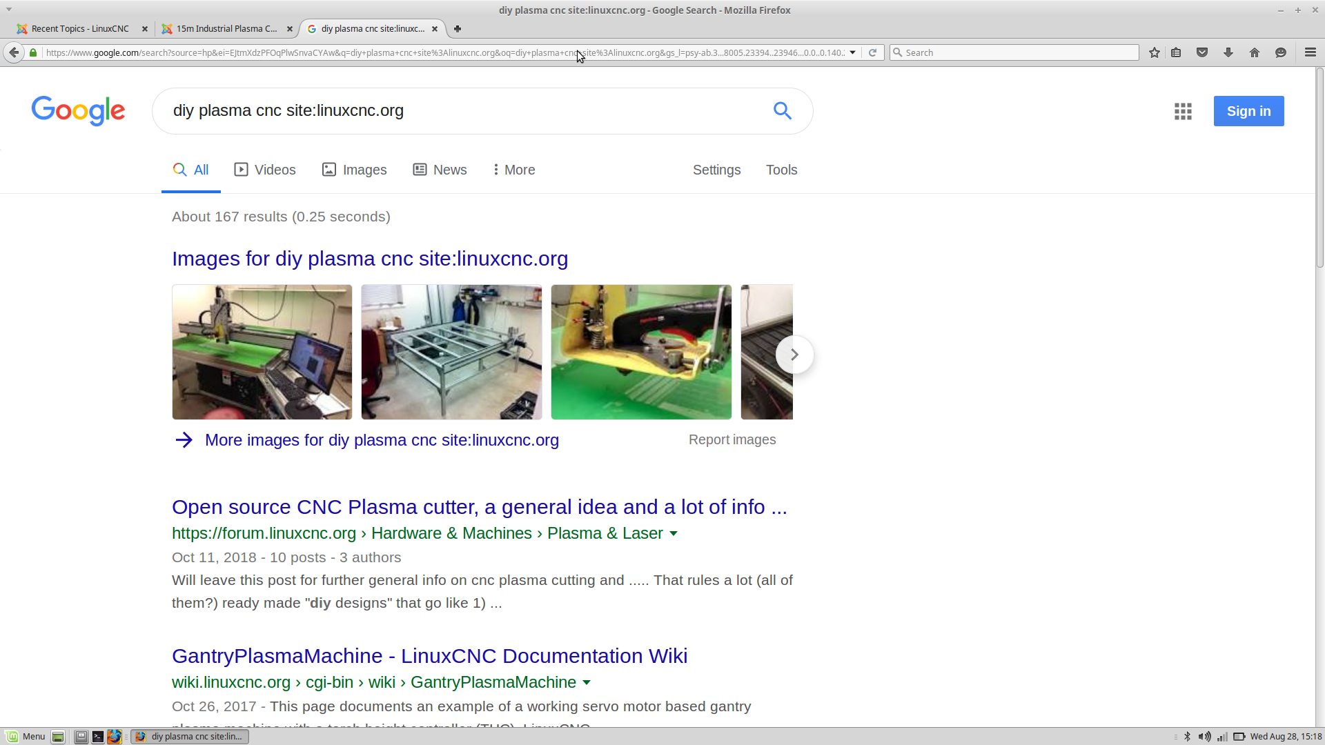

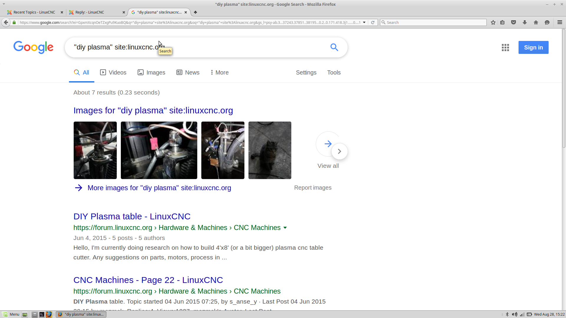

- Posts: 21980
- Thank you received: 7480
28 Aug 2019 15:24 #143452
Replied by tommylight on topic 15m Industrial Plasma Cutter
Use google hacking, that is a thing and google teaches you how to do that, just search for it.
Example:
to search for anything related to DIY, plasma, cnc, only on the Linuxcnc.org site you type
diy plasma cnc site:linuxcnc.org
results:
To search for the exact sentence use
"diy plasma" site:linuxcnc.org
results:
Same goes for files, like
diy plasma cnc filetype:pdf
etc.
