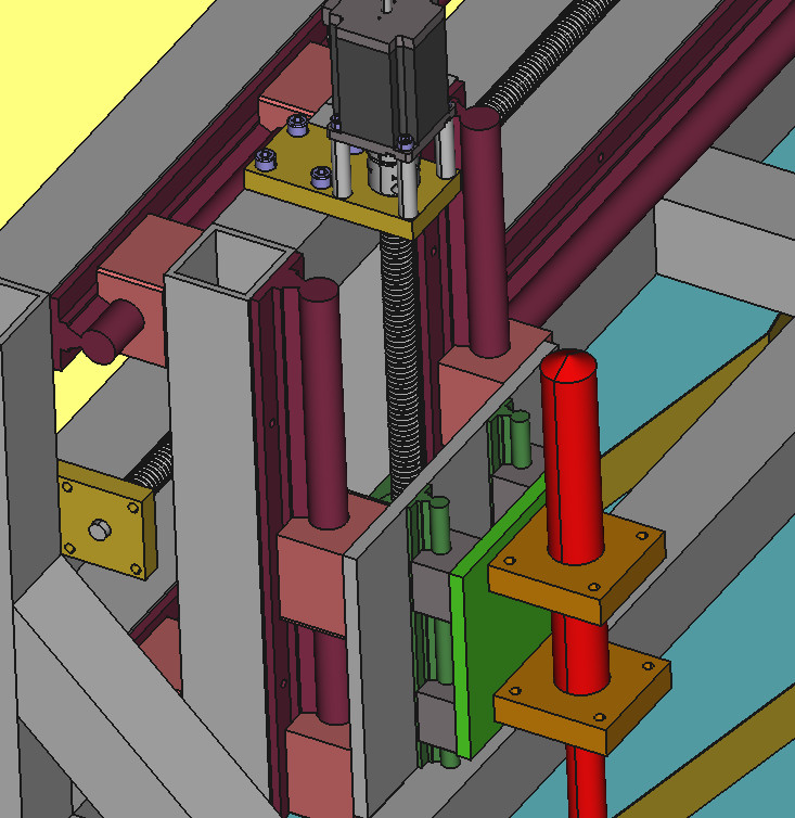

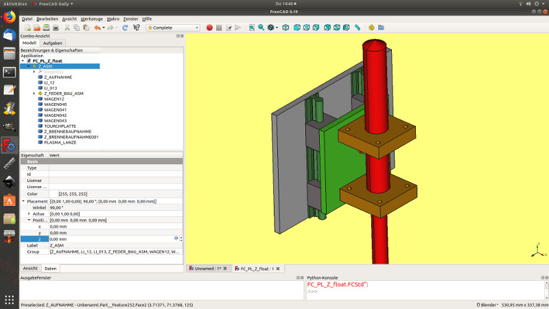

There are plenty of options, and you can build your own floating head in half a day, using drawer slides with ball bearings. Built plenty of them and they do work perfectly ( well untill some of that fine dust gets to those balls, then some major leaning is needed ) granted you turn their slots to the back side to prevent the above. Find a hydraulic repair shop, there must be one near you ( there are 2 in my town with 110000 people ), they have shafts at any diameter in 6 meter lengths, so get 1 meter of 14 or 16 or 20mm shaft at around 30 to 40 euro, should be enough for a Z axis plus floating part ( floating part needs about 1 cm of movement, just enough to trigget the floating switch or sensor ), find a shop for bearings as they must have linear bearings for round rails/shafts, get 8 of them at 5 to 7 euro a piece, and a switch, 4 aluminium plates at 10 to 15 by 4 to 6 cm with 3 holes on them, allthread or a 20 to 30 cm long M6 or M8 or M10 screw, and in a day you have a fully functional Z axis with probe.
That makes 2 options, both cheap and very quick with hand tools and a bit of persistance.
And just in case you think that drawer slides are to thin or to flimsy, get two of them and mount them at 90 degrees to each other, you will be amazed at how stiff that becomes.

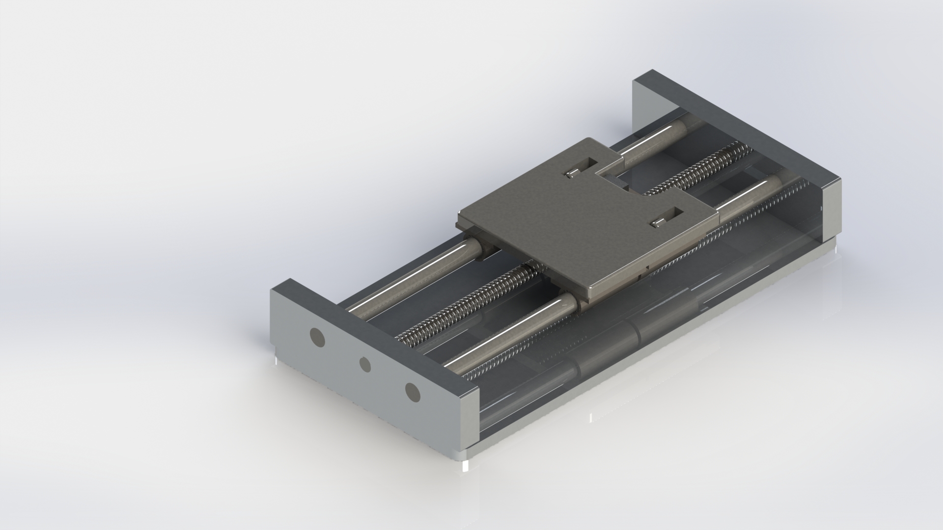

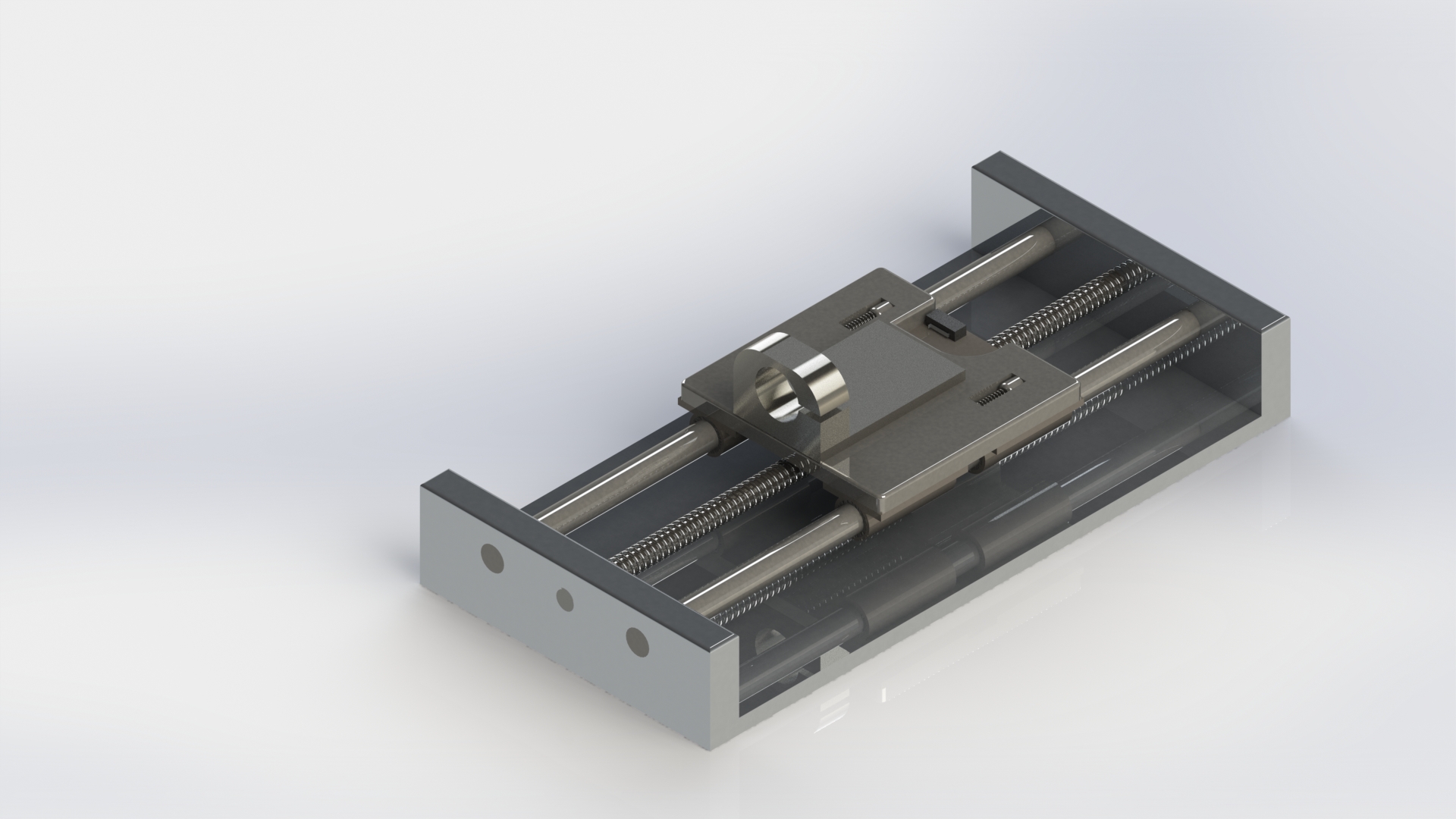

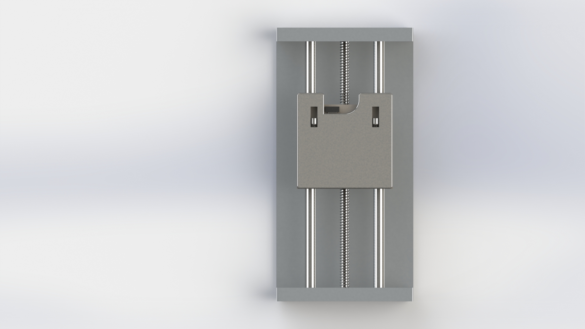

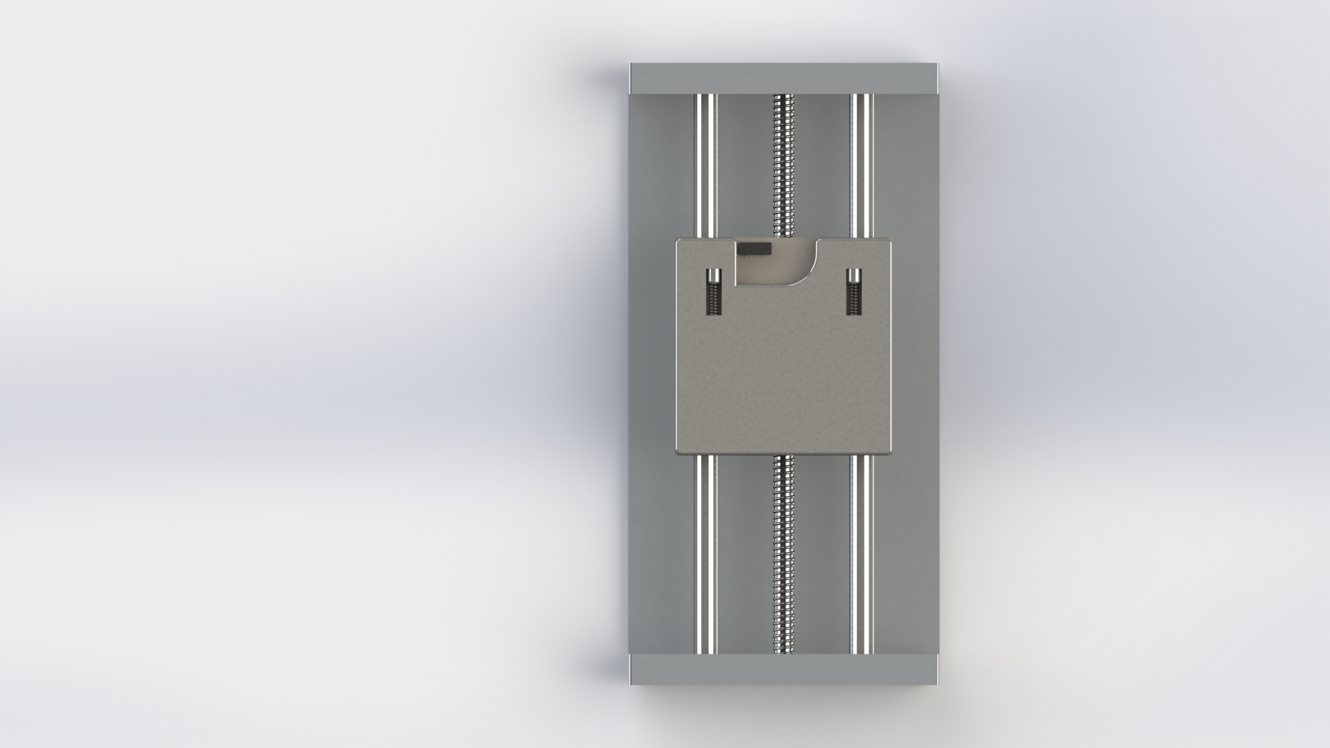

05 Sep 2019 09:50 #144226
by Jarman
Replied by Jarman on topic 15m Industrial Plasma Cutter

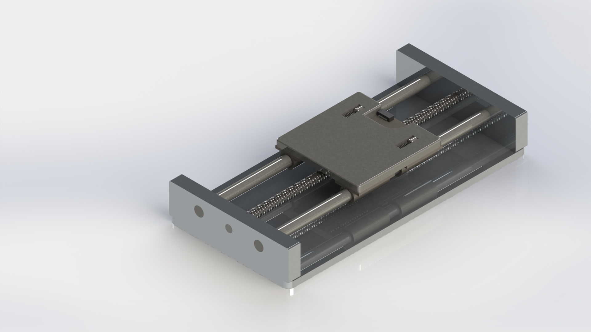

Hello everyone, just an update.
I'm in the process of building my z axis following a similar design to this:
www.veloxcncrouters.com/xz-za-series
My design will look a bit like this:
The idea is that the floating head is on the same set of rails as z travel, using a spring loaded system (the plate with floating head attached is only connected to the bottom 2 linear rails and can therefore slide over the top 2 rails and trigger a pnp switch).
I am now wondering about the x axis that the z axis sits on. If I want 1.25m of x axis travel how much extra space should I allow for sensors/switches etc. on either side? Do I need home/limit on both sides? And how much should the X axis overlap the Y axis on each side? Just the width of the linear rails it runs on or more?
Thanks.
Thanks.
