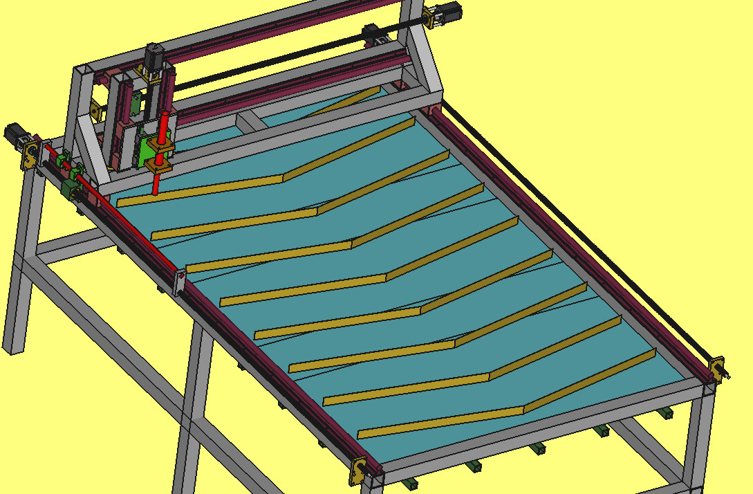

let me upload mine Monster
sorry it is 15MB
its very cheep it uses TR20x4 spindles no mashining needed they fit the Block bearings UCP
ok the speed is limited to less then 3m/min
but on total mashine cost of 1600euros for 2x1m its ok
including s-Cutt 50 and watertable Tb6600 Bob5A 24V 2Nm
sorry it is 15MB
The following user(s) said Thank You: Jarman

Looking into motors, I have heard that servos are better for this kind of size but am not really sure why, are they much harder to rig up than steppers?
Should the Z axis be steppers regardless of X and Y?
Also, assuming servos are being used, am I right in thinking that I can get away with: 7i77, 7i92 and THCAD - 10. Could these interface with steppers as well if steppers are used for the Z axis? I'm thinking the 7i92 could?
Is there anything else I would need (control panel kind of stuff) other than the motor drives? Any interface for controlling the torch? (current?)

Ohmic sensing would be better for you but you still need a floating head with a floating switch in case the shield is dirty and does not make proper contact. To make one have a look at how Rod or TheFabricator and some others did it, there is plenty info on this forum.
My advice on motors, use steppers. It is your first machine so try to avoid complicated stuff as much as you can, you can replace them later if you see the need for it. You can also use servo motors with step/dir control as that would not complicate things more than normal steppers, but if you are willing to go the distance the 7i77 with analog controlled servos would be best and more complicated to setup/ tune and isolate properly from interferences.
And it is not a requirement to have a stepper on Z axis anymore, that was only for the toma_thc config before i also added support for servos on all axis and THCAD.
