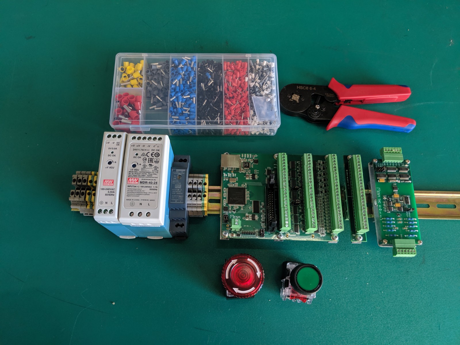

Well, that sounds like it would work then. One thing I have learnt is you don't need much hardware. Here is a 7i96 with everything you need. I would just add another THCAD to this for ohmic sensing.
So one option would be to mount this and the LAM drivers and their power supplies on the gantry. Say you were going with 70 volts with their system. you could put a torroidal power supply in the middle of the table where your torch lead enters, all you would need to run to the gantry was a 55 volt (approx) AC power lead, the torch and a network cable up to the gantry. The PC could live anywhere within the ethernet 100 metre maximum limit.
When I built my table, all my sensors and switches were mounted on the gantry anyway.
It will be interesting to hear Tommy's thoughts.
