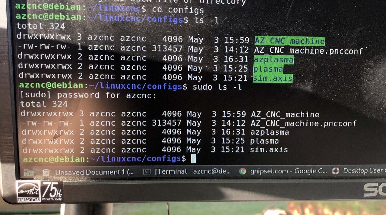

Yep I found that topic. Got it working. And moved on to configuring my plasmac and I set go through the steps and it set up the configuration, I try to open it through a terminal command and I get permission denied. I figure it has something to do with trying with a bash command, how do I go around this. When open linuxcnc my configuration are not showing up either

Replied by tommylight on topic Z axis
Most probably you have run the configurator with "sudo", and that is not good, nowhere is the use of sudo mentioned in the configurator user manual.
Open file browser, right click on linuxcnc folder, click on properties. On the next screen select the permissions tab, set all to read and write.

05 May 2020 00:42 #166701
Replied by rodw on topic Z axis
So do you have any configs under
~/linuxcnc/configs ?
Also from the command line, in that folder type sudo ls ./*.*
If that shows additional files you have a permissions issue so you will have to use sudo to give yourself read, write, execute permissions.
If not, you might have set it up somehow in an invalid folder that you don't have permissions for (eg not in your home folder).

05 May 2020 00:59 #166702
by motal2004
Replied by motal2004 on topic Z axis
So in configs when I type ls
I get azplasma , plasma , and sim axis, and my original file AZ_plasma_machine.pncconf. They are highlighted.
When I do sudo ls the same configuration come up not highlighted

05 May 2020 01:03 #166704
by phillc54
Replied by phillc54 on topic Z axis
Try
ls -lPlease Log in or Create an account to join the conversation.

05 May 2020 01:16 #166705
by motal2004
See picture

05 May 2020 01:22 #166706
by phillc54
That looks ok, assuming the config we are looking at is plasma now doDo not use sudo for anything unless it is absolutely necessary. It is a bad habit to get into.
ls -l plasma/Please Log in or Create an account to join the conversation.
