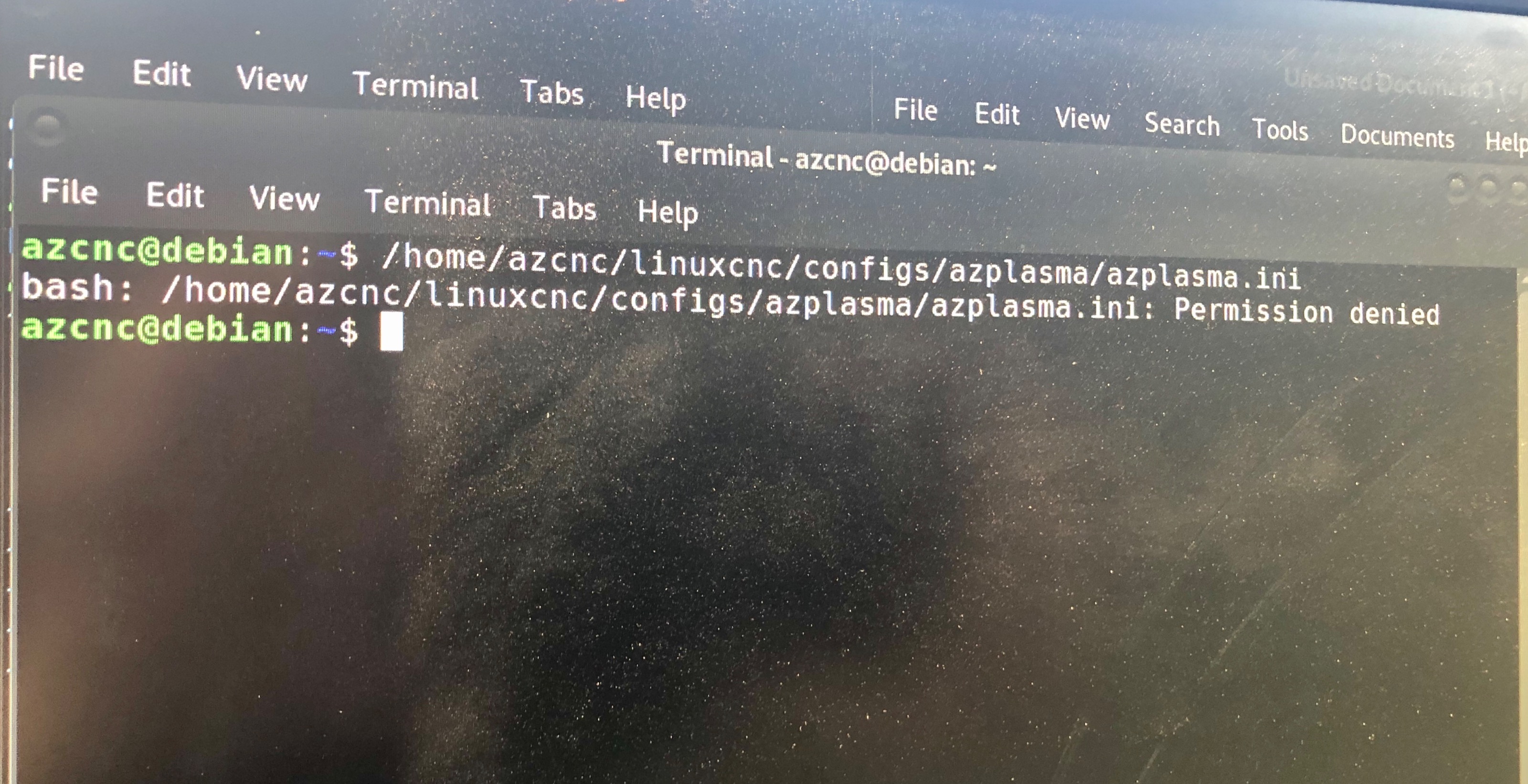

Can you try again from a terminal and post the errors.I try to open it through a terminal command and I get permission denied. I figure it has something to do with trying with a bash command, how do I go around this. When open linuxcnc my configuration are not showing up either

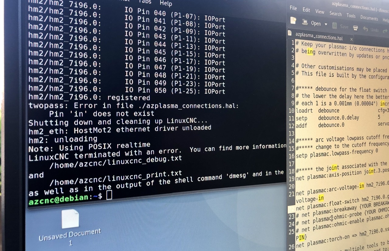

This is what I get from terminal. See picture
I would copy paste but my web browser is saying address unreachable.
- phillc54
- Posts: 5711
- Thank you received: 2100
05 May 2020 01:39 - 05 May 2020 01:41 #166712
by phillc54
Replied by phillc54 on topic Z axis
You need linuxcnc and a space in front of that.
Edit: something like:
linuxcnc ~/linuxcnc/configs/azplasma/azplasma.ini
Last edit: 05 May 2020 01:41 by phillc54.

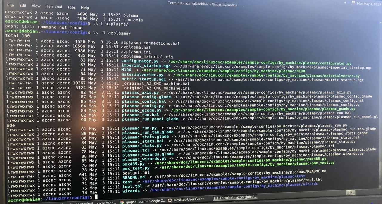

The “~” in The manual threw me off i’m getting somewhere now see picture. I’m trying to find this “in” pin
- phillc54
- Posts: 5711
05 May 2020 01:49 #166714
by phillc54
Can you post that file, you can click attachment at the bottom then drag and drop the file.

05 May 2020 01:55 #166716
by phillc54
In this line:you have an extra "in"
"~" means users home directory
net plasmac:float-switch hm2_7i96.0.gpio.004.in in => debounce.0.0.in"~" means users home directory
