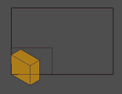

Just for info.
For opencascade i have a new example for linux users : github.com/grotius-cnc/occt-samples-qopenglwidget
- made linux compatible.
- It has widget overlay.

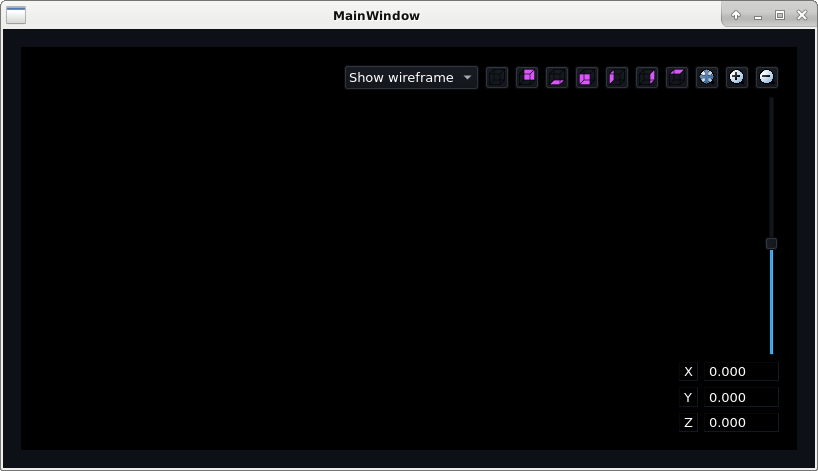

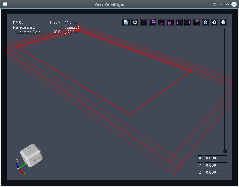

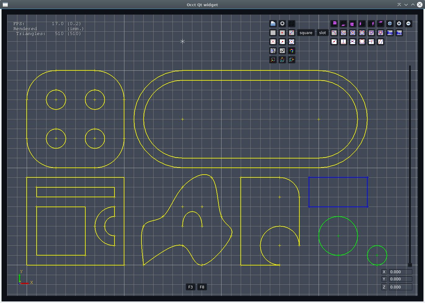

I coded some more and finally came up with this template desgin.
The nice thing is, it tracks your current mouse position onto the objects.
It is based on graphical gui design. Has qt widget overlay, and has some additional menu options.

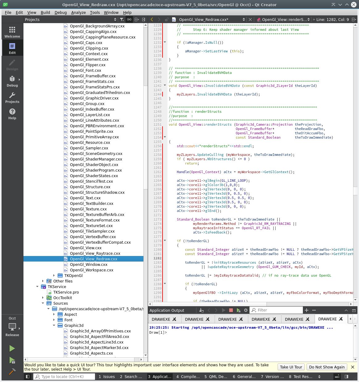

The past 8 day's i did a OpenCascade Hacking Course.
The result is zuperrr satisfying.
The problem was as follows.
With Opencascade you can draw nice things, like 3d models, gcode, cad data etc.
This is all done trough the opencascade c++ api.
In some scenario's you want to do a direct OpenGL function call from Opencascade and render this to the screen.
Haha..
Problem... You guess.
An exotic direct opengl call could be this project : github.com/grotius-cnc/qt_3d_mouse_ray-tracing
It is used for ray-tracing. But you can forward the lcnc gremlin gui in this way. Lots of scenario's need
direct opengl commands.
You can not draw a opengl core coded line, point etc with Opencascade.
But after some investegation and source code modifiation
i could draw a line's in opengl trough the opencascade interface.
Source code :
Now i will make a permanent hook into the source of opencascade. The opencascade lib is now compiled as qt project.
The new Opencascade.deb archive will have this opengl core code hook.

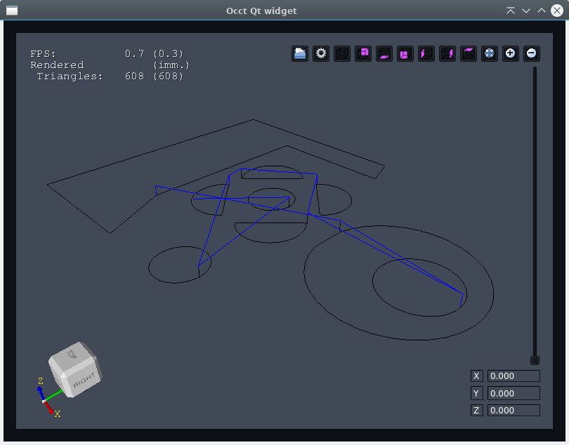

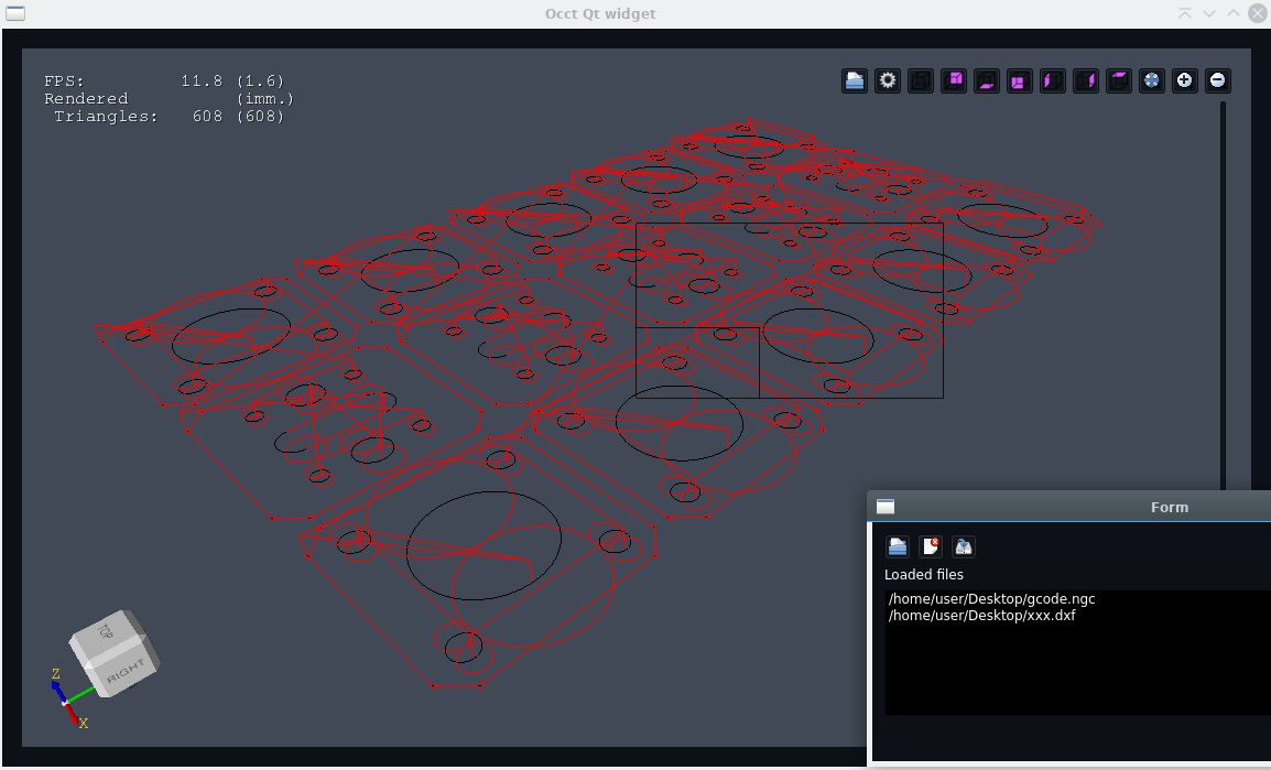

Ok this works. It can now export some different filetypes.
It looks like a gcode ripper : www.scorchworks.com/Gcoderipper/gcoderipper.html#split
I had to dive into the cad arc angles a little bit. In opencascade the angles differs a bit from the autocad angles.
Now that's solved. For example. Autocad radians 0 = east position. Opencascade works a little different.
export stefile solid (.step) to dxf (.dxf)
export gcodefile (ngc) to dxf (.dxf)
exporting a dxf to ngc will have no value. It has to be organized, and a dxf is far from organized.

The "glXGetCurrentContext()" comes from the glx.h file wich is included by installing :
$ sudo apt-get install libgl1-mesa-dev
how could this new knowledge help to create a realy good and fast realtime path.
I tested program's over 1000.000 lines a few weeks ago. This is usable to preview toolpaths.
This will explain how to setup this type of shapes.
Currently building a sketcher app.
