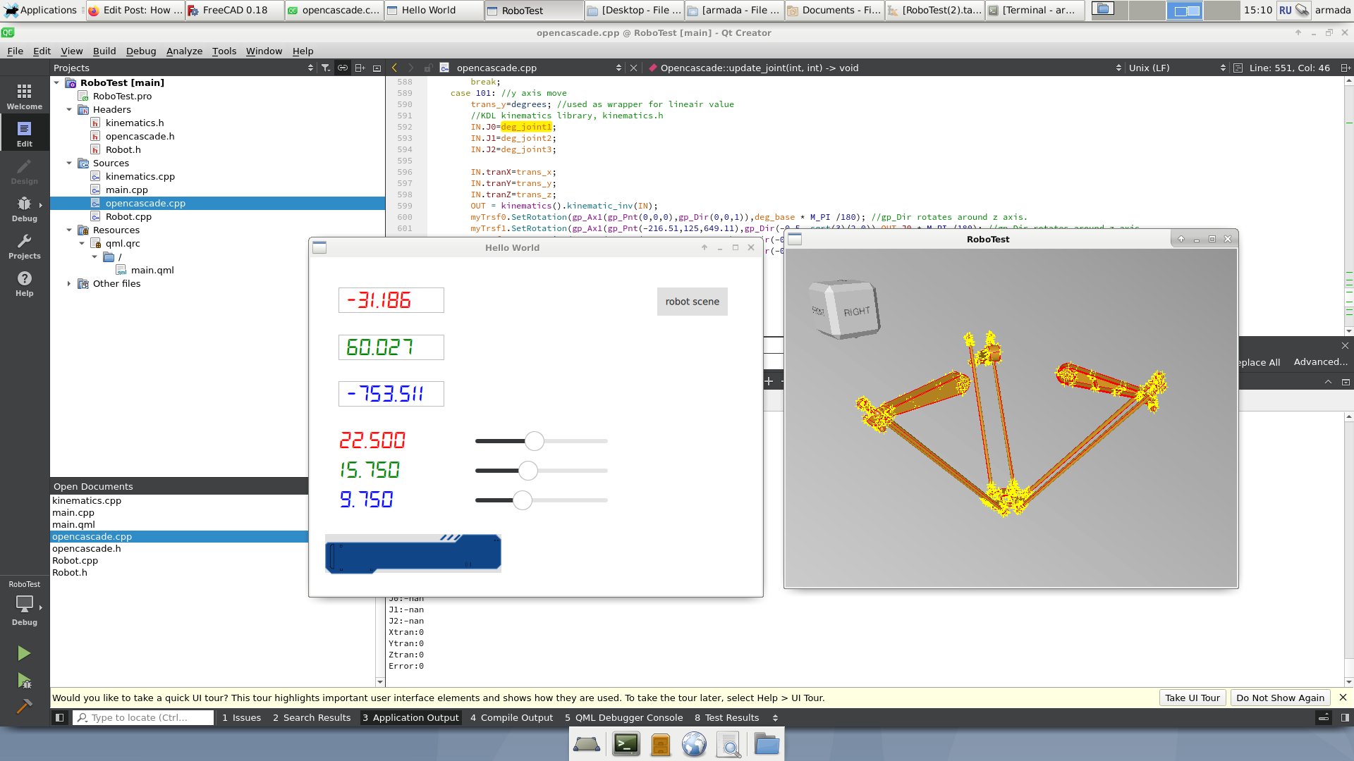

Just leave the opencascade.h untouched.
I want to connect slider to 3d model, but this string crash all compile
Ah. This make sence.
For example how to connect a button, the .cpp file :has a slot in the .h file:is controlled by the .qml file :
Personally i never pass argument's in button's themself. Qt has no interface for this. But if above example works it's ok for me.
For a slider you have information like a float value for the slider value. It is no string value !
You just use a float value. Hal has no double value's present.
For info : It's not always a good idea to use onClicked. the "on" is used by qt internals.
Try to integrate the slider function first make it work in the cpp an h file.
Pass some value's with the existing buttonpress function.
After that create the connection to the qml.
void Robot::onClicked(const QString& in1, const QString& in2, const QString& in3)public slots:
void onClicked(const QString& in1,const QString& in2,const QString& in3);
tButton {
robot.onClicked(input1.text,input2.text,input3.text)
}Personally i never pass argument's in button's themself. Qt has no interface for this. But if above example works it's ok for me.

I connect slider to interface. It counts in both directions. But if I use opencascade function - project is crash.

In the main.cpp the opencascade is named occ.
In main.qml you create the robot scene by calling :
So for passing the slider values to occ it would be something like :(calling that from your qml code)
What you did is calling a c++ opencascade function directly. An sich this is no problem. This methode can be used, but not alway's.
Why not then?
Opencascade has to be initialized, started etc before it can be used.
Normally this is done once in a program loop. For c++ :
Then in your program you call a function like :
Then it will show no error.
I hope this give you an idea how to handle this. In the beginning it can be quite confusing. But when you have practiced
a little more, you will begin to understand how things work in c++.
P.s.
Very nice to see, you are using qt design studio.
Can you tell us your experience with this program? Is it nice to use? Is it difficult?

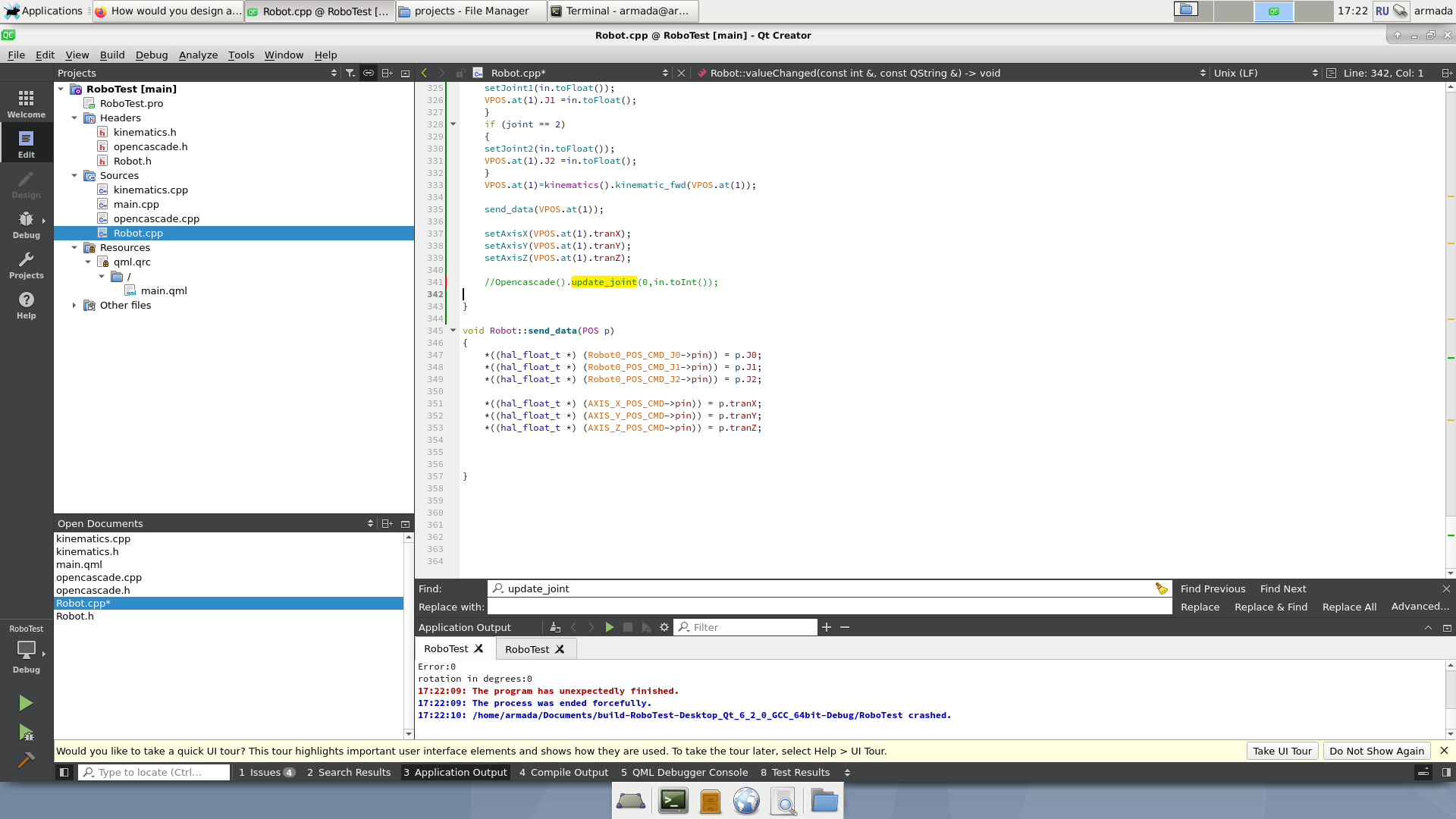

I thought of doing this, but as soon as I start writing in Robot.h:
include <opencascade.h>
project not compile
project not compile

You can add the code to your project.
Mention creating the slot signal in opencascade.h and then call it from qml with : occ.yourslotsignal()
Now you can happely go on with coding !
In the main.qml:
Opencascade.h:
Opencascade.cpp:
And your robot is moving !
You have to check your model rotation-translation yourself.
You can look at this function to rotate your model. It's based on a quaternion. But first try to get it correct using the
existing example.

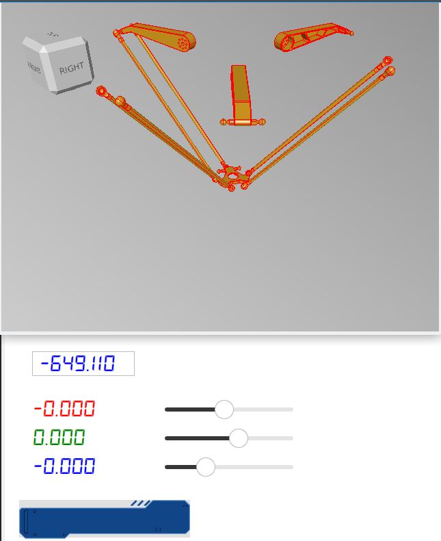

Thank you so much.
I know about rotation problem. I think I can do it
How you can hide yellow cross?

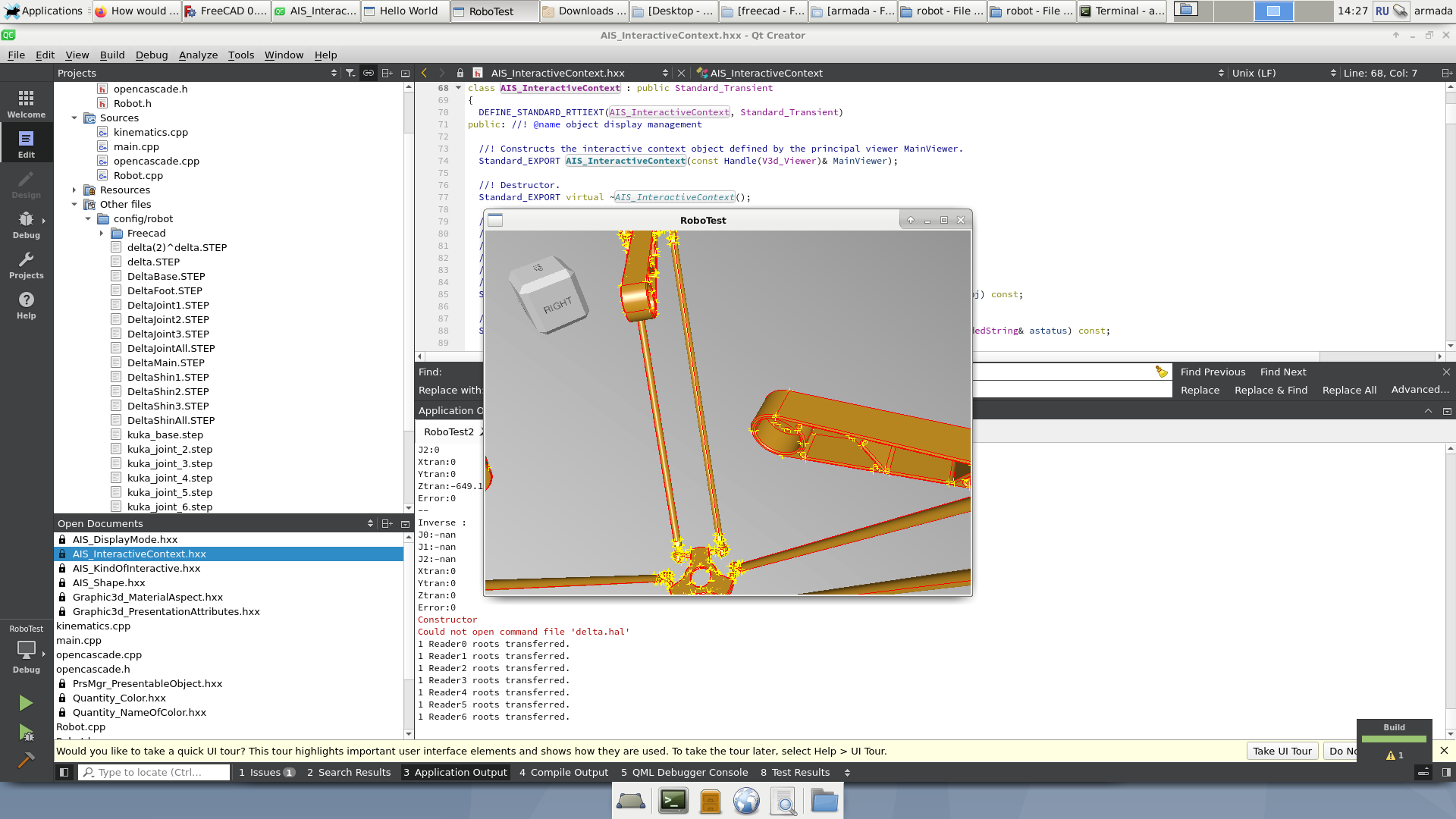

For reading a stepfile, there are different options. Try this example :
PS Can you check "LinuxCNC S-Curve Accelerations" topic
If you have problem's with a nice motion output. Try to integrate a stepgen component between your motion command and
motor drives. The stepgen component can finetune the acceleration-deacceleartion very nice.
