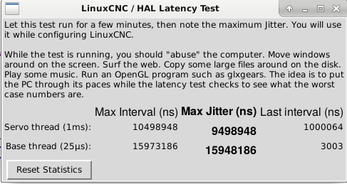

I did a linuxcnc latency test for my home pc :
The conclusion that i took from this test is that this pc is not usable for linuxcnc.
The bad latency can be related my current kernel 4.19.0-0.bpo.9-amd64, i needed this kernel to support the displayport.

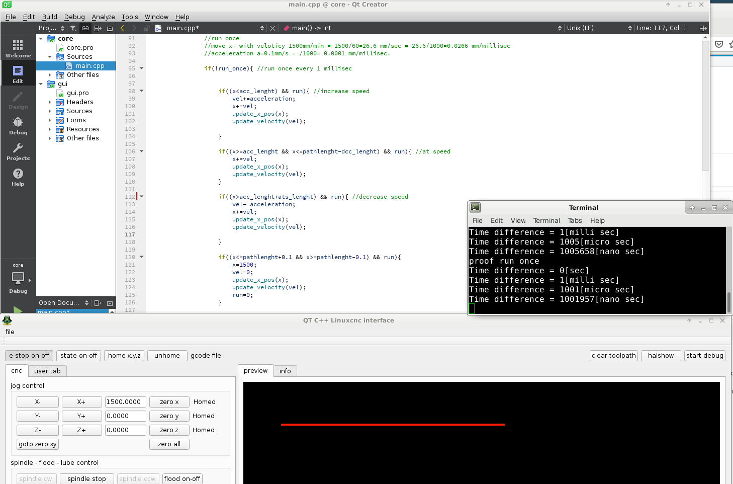

I did a short test to run a real time app on this bad latency pc. Its programmed to do what it can's within 1 millisecond.
The output was not as bad, the code between the spoiler is executed 16 times within 1 millisecond.
Now this is a very ugly and short program example, but it can write shared memory, do a few calculations, update a few functions, etc.
within a nice time. It's just a test example.
So i think i would design it maybe around a stand alone program that acts as core and respects a real time clock speed.
And talks to other executable programs like the gui, a executable program for motion control etc trouth shared memory.
How would you do it?

I have not quite a lot of info at the moment. Just asking how other people are thinking about desinging real time software.
Linuxcnc is designed a while ago. I was wondering what the designers would do different if designing it from scratch this day's.
not sure about your project but if you post more info may be i can help
It's all very new for me. So i will try to make some example soon where you can look into. I hope to provide a modulair example.
@Chris,
What are you proposing to do different? That item is not different i think.
I imagine the core is a stand alone c++ program, that acts as a distributor for read and write data trough shared memory and
repects a real time clock sequence. It load's and unload's also the .ko files. (for readers : .ko = kernel modules like i/o card drivers.)
For real time app's i think you need a boss that takes responcebility for the clocktime.
If subroutines do not complete within their task time, there is a problem i think.
The whole program will be not so big in code. I think a max of 2000-4000 lines to ensure the the operating speed at older pc's.
It is much smaller then Linuxcnc. Starting with a lightweight, hopely ultrafast app.
But still everything is unknown. I hope to get some good idea's around here that can help.

Okey here we have 2 program's running. The gui start the core. When gui is shutdown. Shared memory is cleaned up. This is
really importand. Cleaning up the shit.
1. The core (real time)
2. The gui (refresh rate 0.1 sec for motion, 0.1 sec for opengl, 0.1 sec for mainwindow)
The core does takes responcebility for motion, like acceleration, deacceleration, update kernel drivers in the future.
The core is connected with the gui with shared memory. At startup we create 100 shared memory channels at once with a size
of 1024 chars. But i have thought to decrease this where possible in the future .

There is something seriously wrong with the test program if it only manages to put in 16 iterations in one ms.
CPUs nowadays run at 2GHz+, so that amounts to 125000 cycles per iteration doing essentially nothing. I suspect std::cout << is slowing this down.
If I were to design something like linuxcnc from scratch, I would first try to get the IPC layer sorted. If at all possible, use/adapt something existing like zeromq, else you are still debugging concurrency issues 5 years from now in 5 different programming languages.
Avoid kernel modules at all cost. Exception may be step generator, but I would implement that as a device driver, and keep the rest of the system in userspace. You can't easily debug kernel modules, most programming errors need a reboot, even a recovery from backup could be needed in some extreme cases.
You will end up with something similar to linuxcnc.
If you have too much energy, that would be better spent in e.g. replacing NML layer in linuxcnc with something modern, port gtk2 to gtk3 stuff, python2 to python3, update classicladder, yadda yadda yadda.
