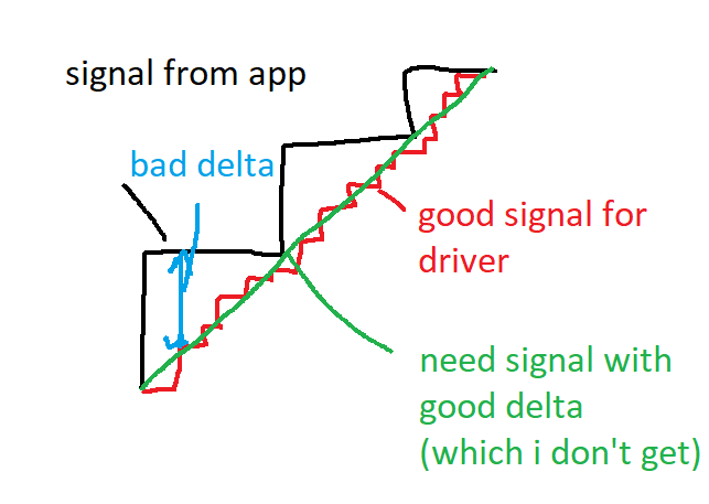

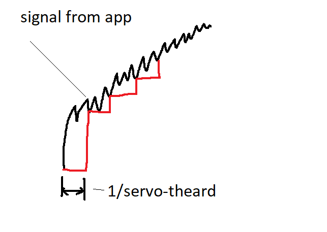

Ok. I mean that the signal that I receive from the application has a different frequency.
This is bad for the drive. The frequency must be equal to servo-thread. pic 1
Or I don't get need signal with good delta. pic 2
I don't understand which of these hypotheses is my case.But I understand that dofs componets (by Grotius) solves this problem + needed signal has s curve acceleration
UPD
Thank you very much. simple_tp - exactly maybe what is needed.
I correctly understood that dofs (by Grotius) differs from simple_tp in that it has s curve acceleration?isn't it

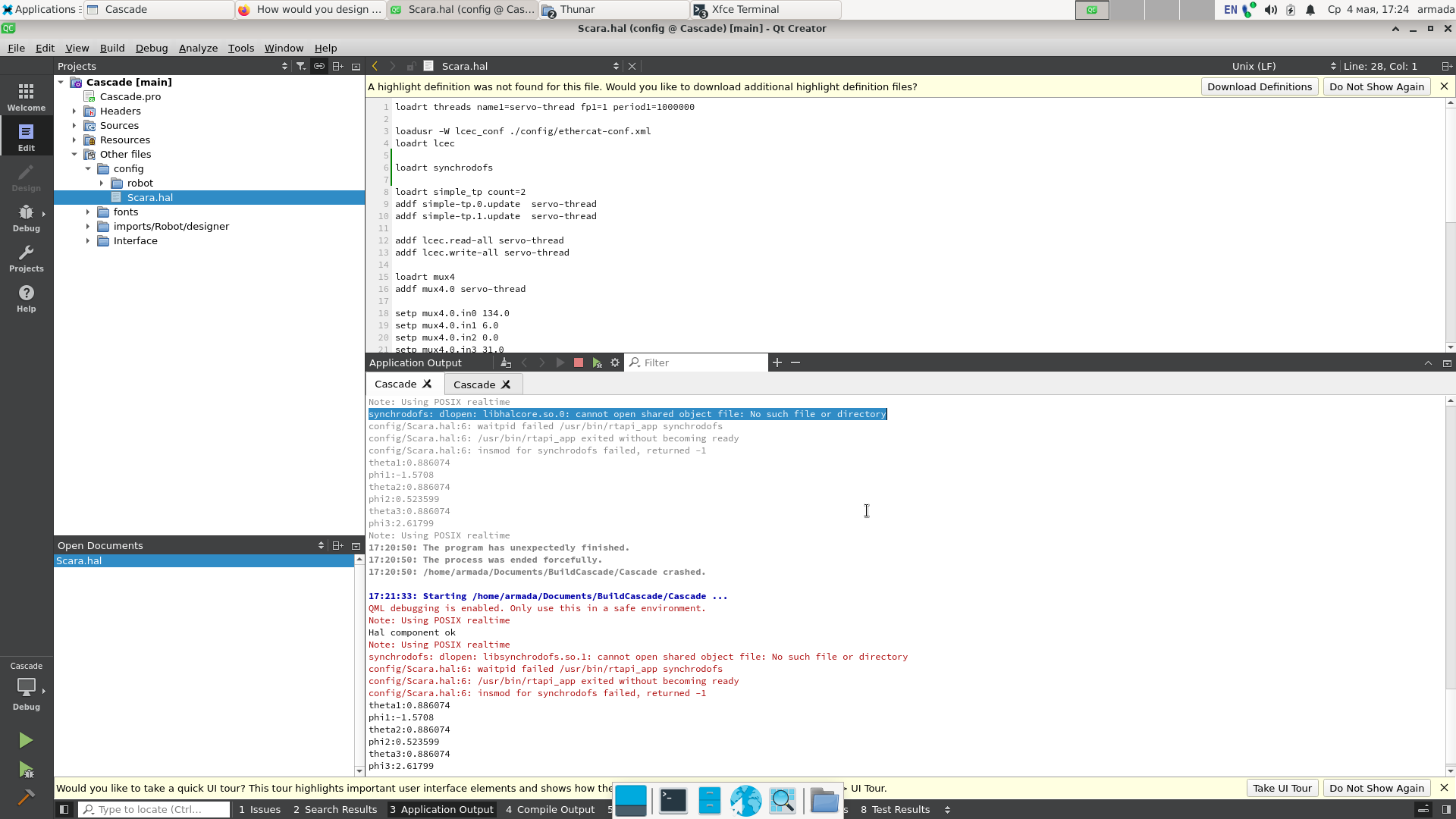

Anybody can install hal-core (Grotius). I to install his file and get error/
I copy libdofs.* file to usr/lib/linuxcnc/modules and get error with libhalcore.so.0
If I copy libhalcore.* file to usr/lib/ -get error with libdofs.*
