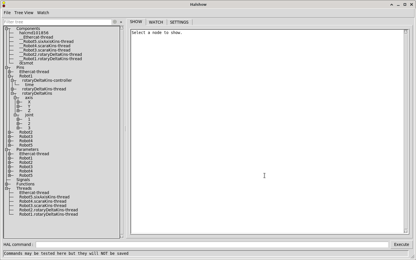

sorry TheRosLyak .... but really you would use OPCUA for performr your task? .... normally happens these: you install (for ex.) 6 cnc unit, than connect all 6 to control plc or pc .... using some type of bus .... in your case think you would use multicore cpu next gen. for start multiple istance on Lcnc 1 for cpu .... ex. 6 Lcnc .... think is better use other cpu as "master" as guidance for various task .... at that point OPCUA can be or not a choice .... you need have 6 OPCUA server on 6 cpu .... and you have probabily 6 master ethercat at work .... 600mbit/sec total ..... personally think these can be a problem .... with 10 lcnc task with ethercat become 1000mbit/set or 1Gbit/sec .... com structures can become a problem ... you obviusly think to scalable system .... these is my doubt .... but I'm only a self learner old man .... so take the considerations for what they're worth

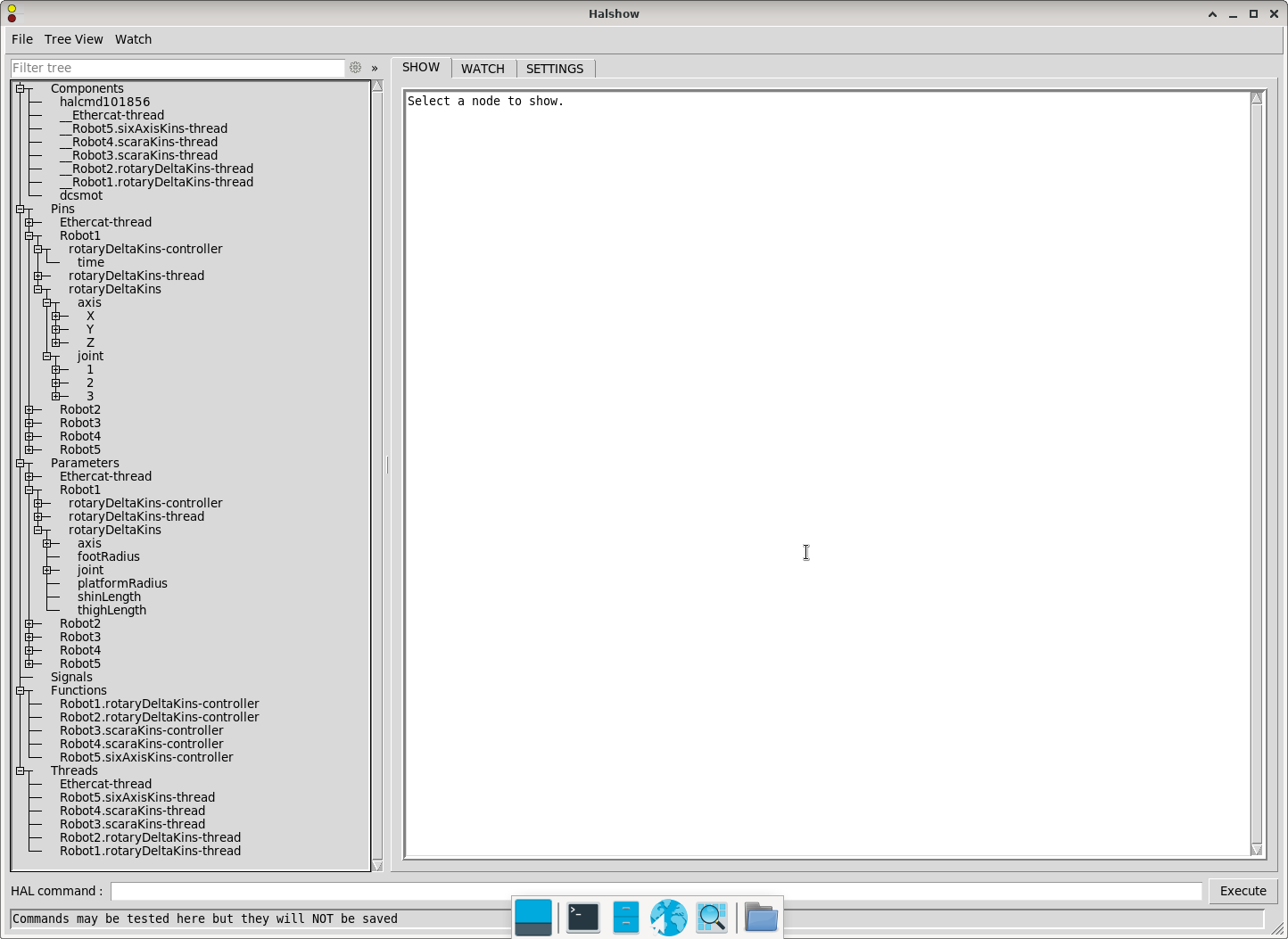

It doesn't matter how I distribute tasks affinity cores. I can have 3 robots running on one core. On the second core, I'll have onnx running with a gige camera. And on the other cores, I'll be playing Cyberpunk. If I need to transmit information from this setup to other devices and I'm fine with 100-500 milliseconds, regular OPC UA is sufficient for me. However, if I need to make this setup work as a full-fledged real-time device, I can hang an OPC UA TSN server on another core.

About your 3 robot on one core, you use makinekit 3 istance, or the large amount of avaible axis on Lcnc now? Or you have implement a new way to have more than one istance of Lcnc in one only core?

Yes, simply put, I can run multiple tasks based on linuxcnc.

you could try github.com/LinuxCNC/linuxcnc/pull/2722 if you actually want multiple linuxcnc instances running in parallel

To be honest, I don't even want to waste time checking whether this works or not. Machinekit also positions itself as a system that allows running multiple processes. But it's not specified there that there can only be one machine control process. Linuxcnc simply doesn't create different threads and functions that can be run in parallel on the same machine. Moreover, I myself am close to creating a working system based on linuxcnc and machinekit. Until there is actually provided a HAL file that allows running several independent work processes, there's no point in discussing it

I'm not sure what you are trying to achieve. The linked branch was done to allow parallel test runs, so it allows to run completely independent linuxcnc instances without resorting to docker, namespaces/cgroups or such things. Completely independent means nothing is shared, no HAL, no NML queues, no nothing.

As I can show you not need to share info .... you have jet one hal with multiple thread .... so every thread shared info with main one .... these is fantastic .... bravo .... but is not safe. Seems you are in UE ... so safety must think before the software ... you need to have completely separated control not a main plus more thred ... mine is a suggestion ... after these stupid pieces of advice, I repeat .. Bravo.Yes, simply put, I can run multiple tasks based on linuxcnc.
