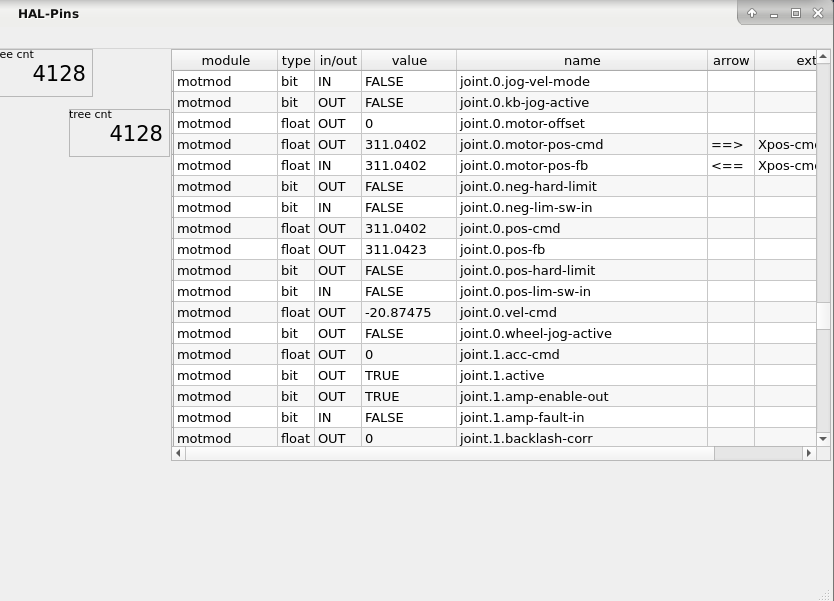

HAL Pins Qt TableView.

Now here the HAL-Pins-Viewer in life action.
Grotius: You have to make a connection
for every pin or parameter. Are you able to automate this step?
Yes. Can be done using the halcmd net command.
Also now loading the last selections from the previous watch-list after a restart.
Did I mention it before: I love this shi.....!
