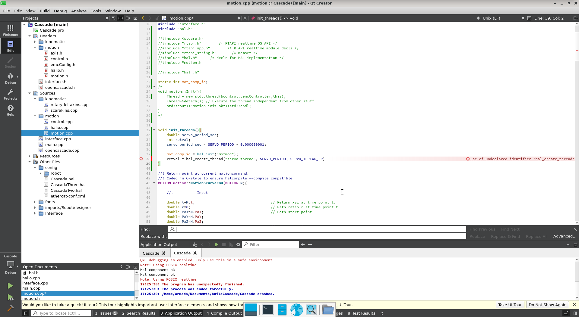

- Posts: 19908
- Thank you received: 4658
02 Jun 2022 04:43 #244432
Replied by andypugh on topic How would you design a real time application for cnc control in c / c++ ???
I don't have an answer to the specific question, but I don't think you should #include a specific kinematics module. All kins modules should export the same symbols and the prototypes or those are in the generic kinematics header.
I your code needs to run in a thread, then implement it as a HAL component.

I have already solved the problem of creating a flexible project. Function "hal_pin_float_newf" is more flexible then "hal_pin_float_new".
Now I'm facing the problem that I need to create a thread (like linuxcnc) directly in the application itself.
Before that, I created component "threads" in hal file. But it was not actually used. (Just spinning in the background)
To get my emcController to run at servo-thread frequency. I need to create it in the app itself (like EMCMOT = motmod). But the problem is I can't use the "hal_create_thread" function.
This function is in Hal.h but it is hidden. Сan anyone tell me how to use this function in my project. (Through "halcompile" everything works)
PS I think I will bring the project to a certain point and put it in the public domain on git. I would like that it would be possible to do level projects on it as in the video
Problem with QML - I think not. Everything is imported and everything interacts with the application. If there are any problems, I ask on QML forum. I don't spend time on design now - the main thing is the main core. I'll be using Abobe Illustrator for a while. - And there will be design of AAA game.
