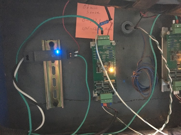

31 Mar 2021 19:57 - 31 Mar 2021 20:06 #204282
by bevins
Yes I did. but there is no way to check it other than the 2nd encoder showing up.
I'll check the connections again.
So I checked and checked again and it is wired correctly
7i76:
pin6 5v
pin9 gnd
pin10 F0+
pin11 F0-
Replied by bevins on topic Ohmic3 hal file errors
I did, the only thinkg I was getting is ohmicsense is probing.
Nothing on encoder.01.velocity stays at 0
That means it’s not even seeing the thcad. At 0v the thcad should output whatever the frequency is in the back of the board, divided by your f divider jumper setting
Have you flashed your Mesa card with the plasma .bit file?
7i76:
pin6 5v
pin9 gnd
pin10 F0+
pin11 F0-

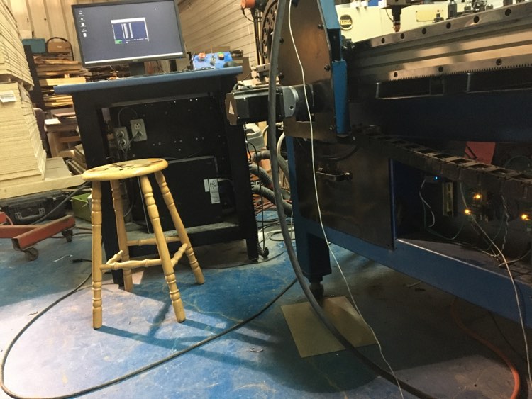

31 Mar 2021 20:56 #204294
by bevins
I double triple quad ruple checked the wiring.
Maybe too far for the 5 volts? need pullups?
The pic the thcads(2 of them) is in the cabinet on right in the table and the 7i76 is behind the computer in the cabinet in front of the stool.
Both the thcad for ohmic sensing and thcad for THC uses same 5 volts from 7i76
