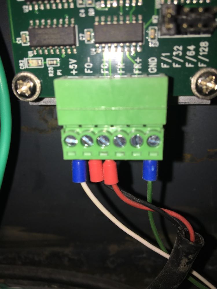

Sorry, I've been at a conference that got cut short due to a covid outbreak. GRR
So what it looke like to me is you have not set the second encoder up . From the Plasmac manual roughly edited for you.
setp hm2_7i92.0.encoder.01.scale -1
setp hm2_7i92.0.encoder.01.filter 1
setp hm2_7i92.0.encoder.01.counter-mode 1
If you look at the thcad, you should see a LED slowly flashing in sympathy with the frequency it is on. IF that is flashing, the problem is in hal

31 Mar 2021 21:18 - 31 Mar 2021 21:20 #204305
by bevins
It is flashing. I'll check hal.
Hal you ever been so frustrated you threw a coffee mug...lol
One of the main issues is I don';t know how this is suppose to work really. I should have stuck with routers.....
Replied by bevins on topic Ohmic3 hal file errors

31 Mar 2021 21:41 - 31 Mar 2021 21:41 #204313
by snowgoer540
Oops, admittedly I likely missed that when I saw the ohmicsense.ohmic-on wasn't hooked up.
Now that I look, I believe you are missing it for your arc voltage encoder too, and that's the reason you are showing -30 volts (when I comment these out on mine, I get no velocity, and my arc voltage reads -29).
You also need to add for your arc voltage issue...:
Replied by snowgoer540 on topic Ohmic3 hal file errors
setp hm2_7i92.0.encoder.00.scale -1
setp hm2_7i92.0.encoder.00.filter 1
setp hm2_7i92.0.encoder.00.counter-mode 1

31 Mar 2021 23:10 #204330
by bevins
I added the entries for the THC encoder and that seems to be working. voltages going up and it seems it is working. Need to fine tune.
The ohmic probe I still have the same issue. So something is not hooked up correctly in hal.
