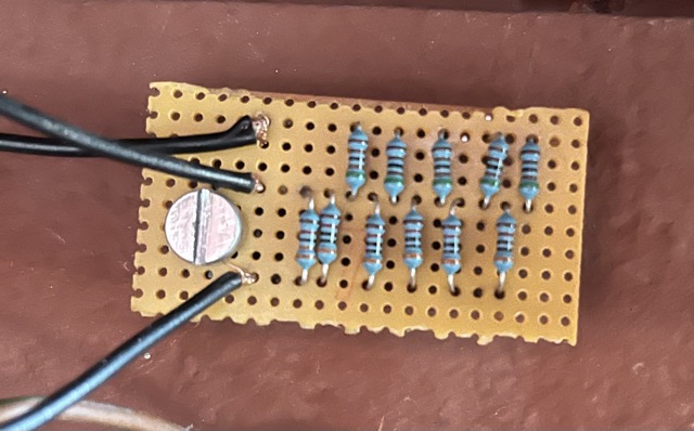

So it turned out the ohmic sensing was not so reliable.
while at 25 mm above it started to cut. (False ohmic on when torch is wet)
My machine is especially sensitive to that.
I use a hand torch on a steel mounting.
Distance from mounting to shield is about 3mm.
so I came up with this experiment.
I made a break out board.
with a voltage divider.
6 30k resistors in parallel so that is 5k ohm.
on the other side 5 5k Ohm resistors in parallel so that is 1k ohm
So I tested with a multimeter when torch is in contact with the negative of the power supply I get 5volt.
when I put a wet paper in between I get 4.2 volt. Looks like this helps to get a solid difference between wet contact and real metal to metal contact.
With so many resistors in parallel. I don’t think torch voltage will overload then.
is it safe to use this kind of voltage divider. On my Thad. I was wondering if it would be wise to add some diodes for safety. Since torch voltage is opposite polarity?

No need for all that, just add a resistor to THCAD input to raise the required current for triggering.
What voltage is ohmic using?

5 volt Thad
24 volt power supply.

I would put at least two of those 5K resistors in parallel, in parallel with the input of THCAD.

You mean across positive and negative of the Thad?

Yes, across the THCAD input side.

What resistor value would you use between positive of the isolated power supply and the positive input of the THCAD ?

Ohmic sensing has been working reliably for the past few days. I would not want to be without it. Makes probing so much faster and more reliable.
