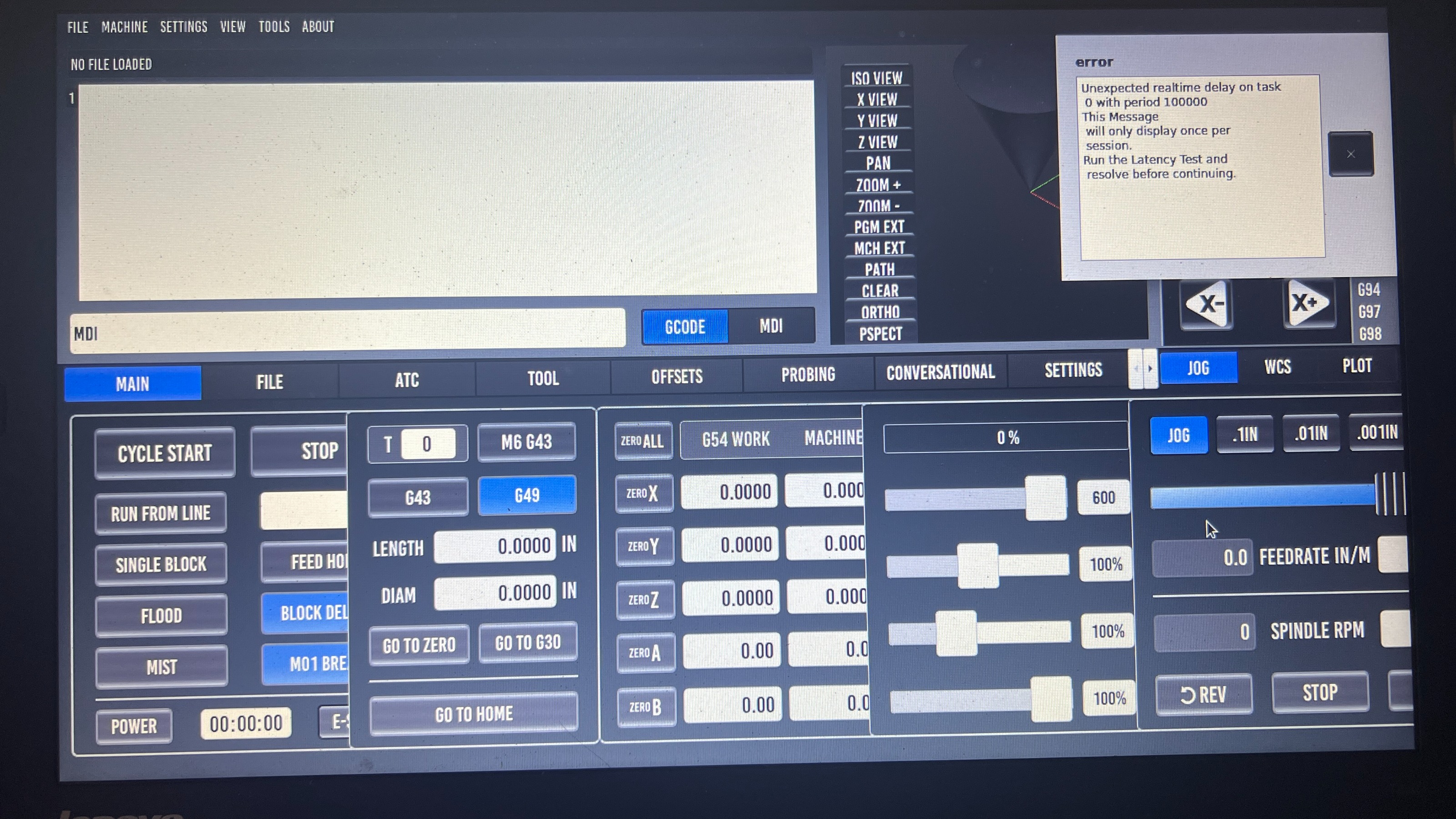

05 Aug 2023 20:25 #277049
by IronManDylan
Replied by IronManDylan on topic Please Help - How to Configure a 5 Axis Head-Head
Thanks tommy, I got probe basic installed using this link kcjengr.github.io/probe_basic/quick_start.html
I've attached a photo as this GUI does not fit on my laptop screen. Also need to adjust jitter too. Do you think I should install Basic Probe? Would be nice just to have another window in Axis. I do not have ATC..

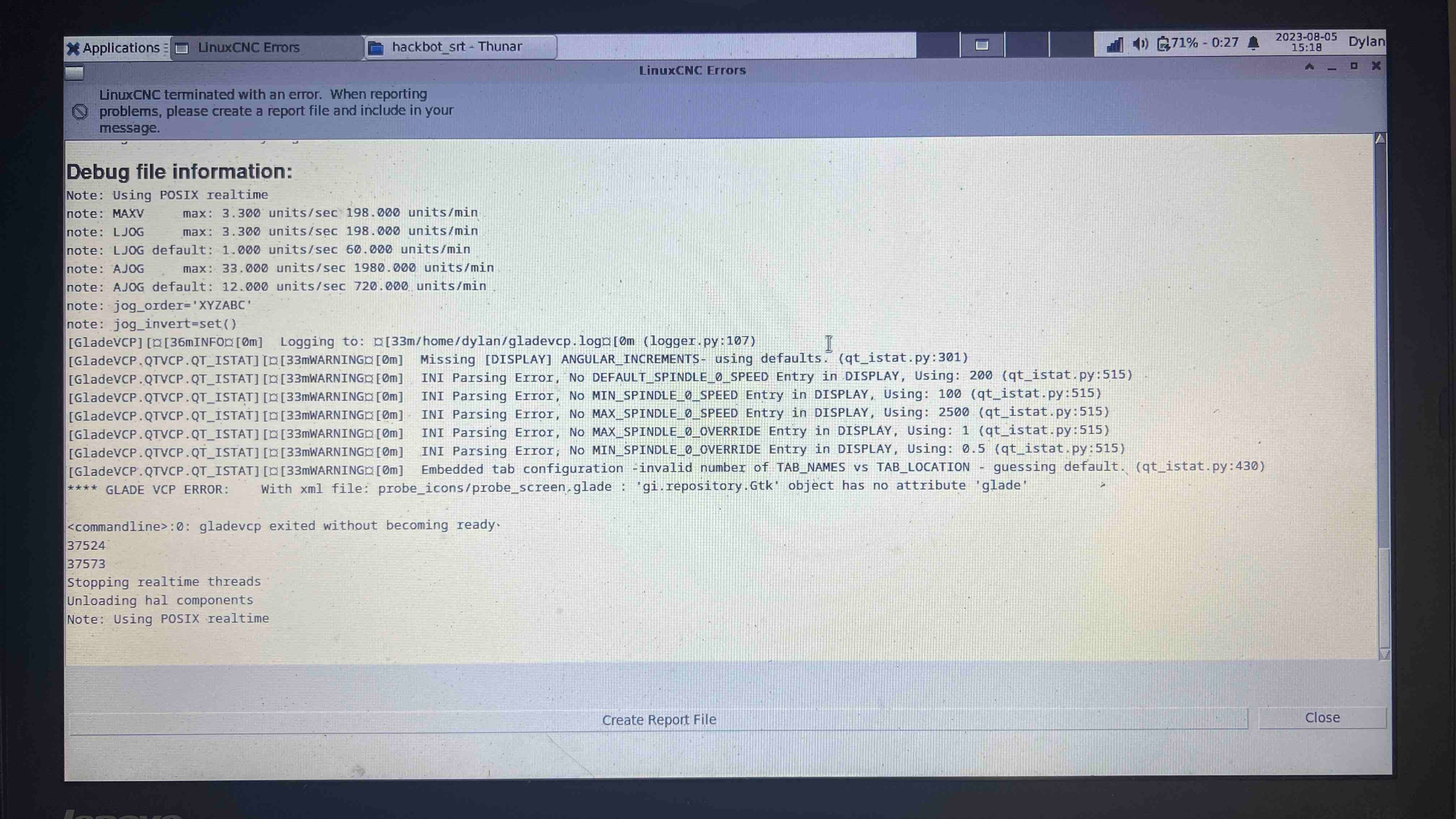

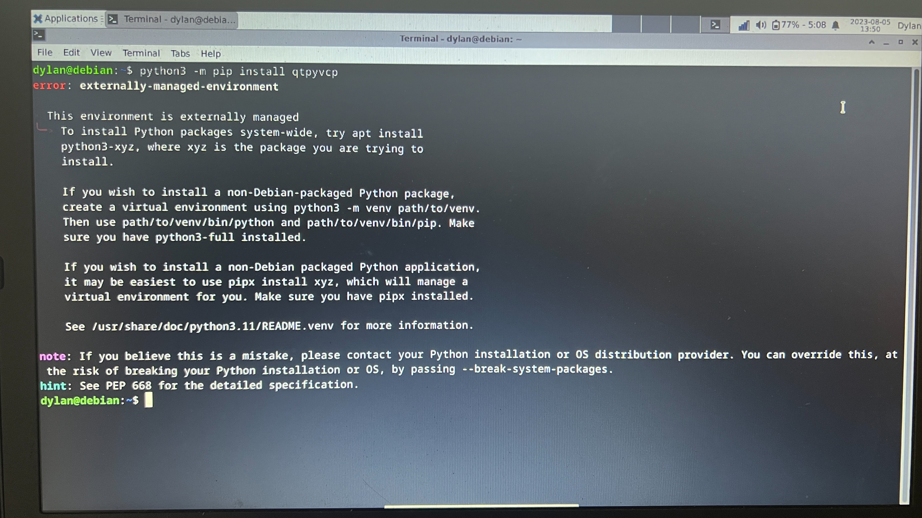

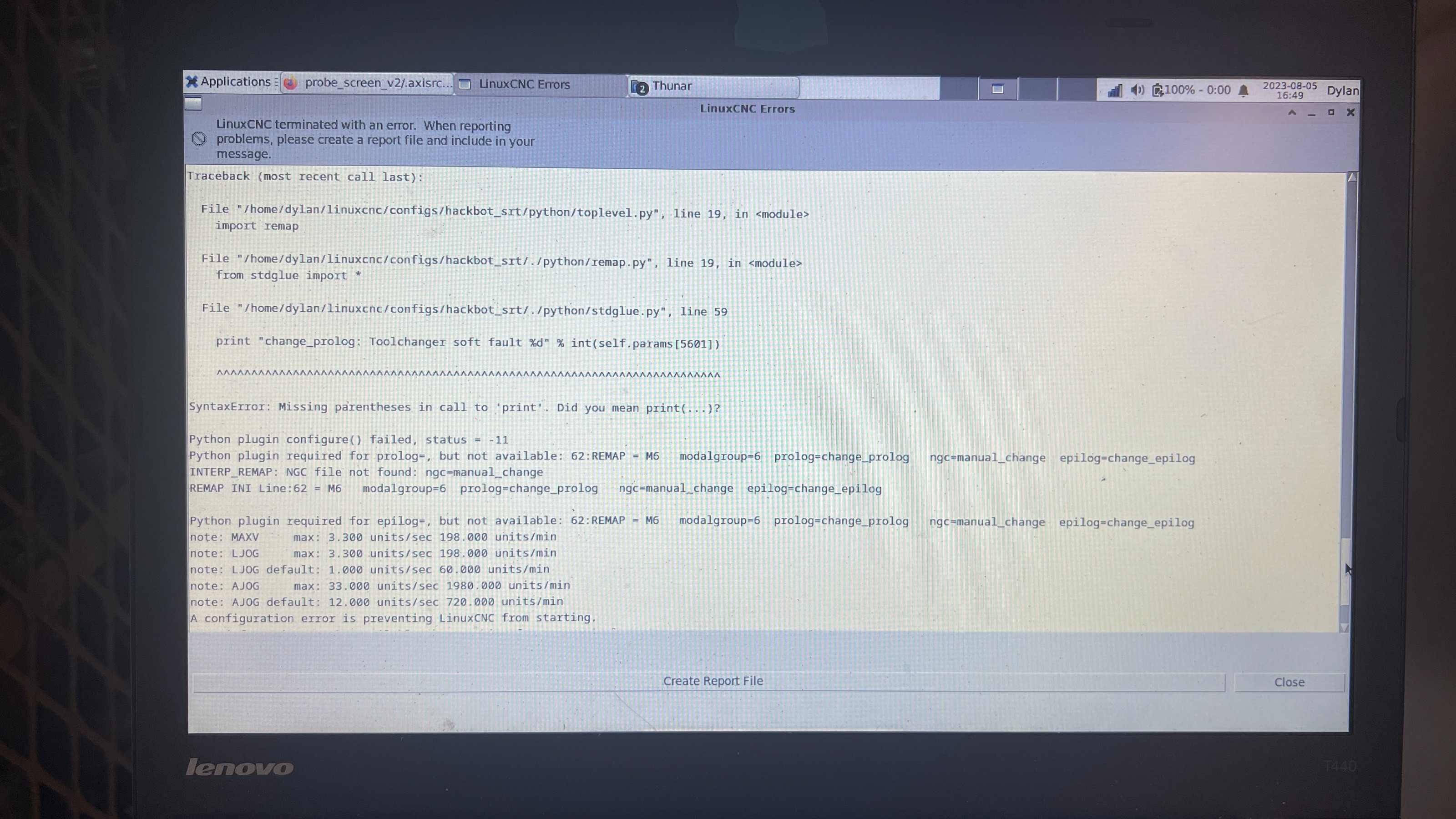

05 Aug 2023 22:58 - 05 Aug 2023 23:06 #277066
by IronManDylan
Rod
Sorry, I was confused, but I think I see what you're saying now. I could either "update" to qtdragon gui and use the versA probe there. Or I can keep with the AXIS gui and use probe_screen_v2 and use the versER probe.
So I have followed the directions on the probe_screen_v2 link you have sent me and have gotten the attached error. Seems like there is an issue with the python files that the link provided. Which seems odd. I downloaded a different version of python for the probe basic. Could that be causing issues? I'm gonna try looking through these files, but I am not a coder so I am kinda just stabbing around in the dark.
I can try switching to qtdragon if you all think that is easier, but I would be worried how that would play with Acieras kinematics file. Is this a concern?
edit: qtdragon is really a much much nicer looking gui, plus I still cannot see the bottom of my axis gui. So I wouldn't mind swithing over to this, I just don't want to cause a cascade of ensuing issue
edit2: the different version of python I downloaded was python3 QtPyVCP. I guess you're saying this is in a virtual python environment, so perhaps it should not effect anything

05 Aug 2023 23:54 - 05 Aug 2023 23:59 #277069
by IronManDylan
I've backed everything up and am going to try for qtdragon now. Btw, maybe that error was coming from having two different SUBROUTINE_PATHs ?
Edit: crap, qtdragon isn't going to be set up for 5 axis and TCP is it?
