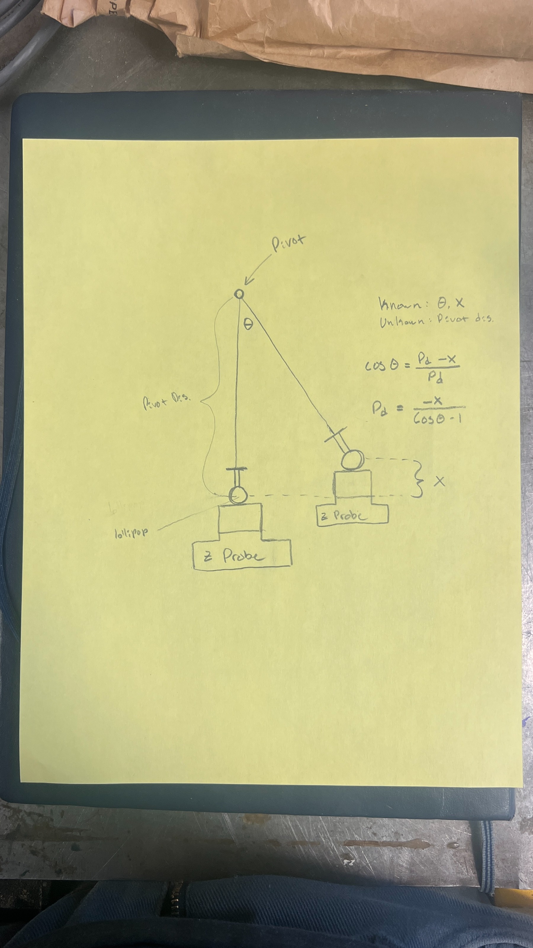

So if you don't mind, let me tell you about my plan to set pivot length/tool height. I have attached an image showing a diagram for calculating the pivot length of an arbitrary height of a lollipop (probably solder a ball bearing to the end of a piece of brass). So the diagram would give me the arbitrary length of the lollipop, then I would write down the g53 (machine coordinate) z height for that lollipop, then I would add or subtract the change in height of my measured tool to that distance. Then I need to set that height as my new pivot length. Does that make sense? So my question to you is, what is the best way to set that height without modifying the .ini file? Is a tool length offset the best way to go? Is there some other method or do you have any other suggestions? Is it possible for me to write some kind of little script or something to probe/measure my tool length and write it somewhere to effect my pivot? I have a collet system on my machine so I have to probe in the length every time I change tools.

As for pivot-z and tool-length, for the kinematic model it does not matter much since both are always collinear to each other so one simply gets added to the other. For machine operation I think it would make sense to define pivot-z as the length from the a-rotation axis to the end of the collet taper (ie with collet nut removed) and the tool-length is measured from there to the end of the tool. If you do it all as tool-length and you forget to activate tool-lenght compensation then strange things could happen (I think). Also this way you can measure the end of the spindle taper on machine startup as a reference.
So basically you would measure the spindle taper, then insert your lolly and measure again (which gives you the length of the lolly) then do your measurement with the angled spindle and do the math.
At least that is what I think should work, but it's late and I need to go and listen to my pillow now.
