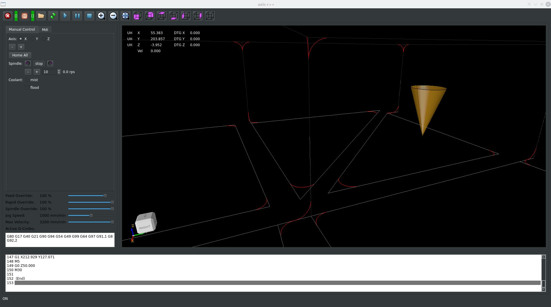

Indeed the xyz ruckig back-end runners ensure at least a valid motor output with no velocity jumps.
I still believe in our own trajectory planner, I think we have to add blending to it first.
Then we could use the G64 P0.01.
So i started writing a blending function, 3d blending wich works now for line-line blending. Arc-line blending still todo.
Good luck with your machine.

How does a fillet work when like segments are 0.001" long?
Some programs like fusion already have fillets built in to path generation, but they go bonkers on micro segments.
