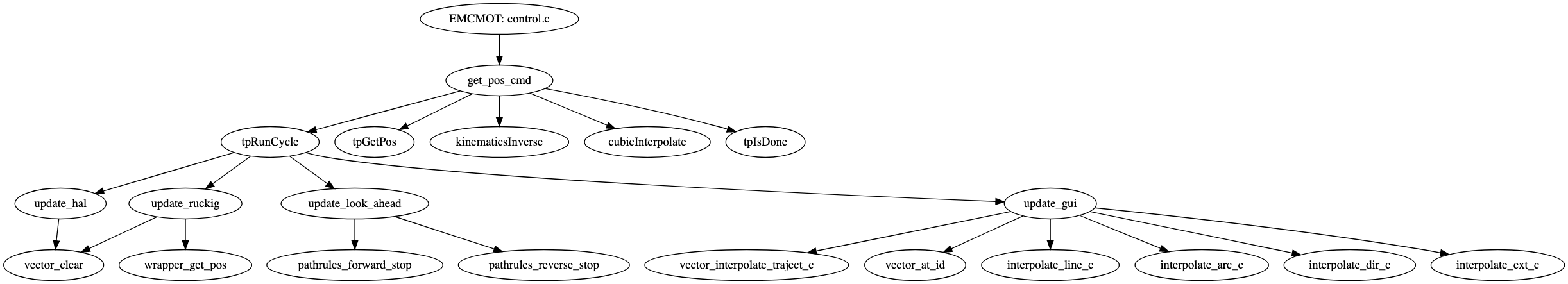

I have been tinkering with graphviz to map out some of the call hierarchy that happens around the trajectory planner.   This might be of use to someone.
Here is the image as it stands:
Here is the graphviz dot code for the image:
File Attachment:
File Name: tp.txt
File Size:0 KB
Cheers - James.

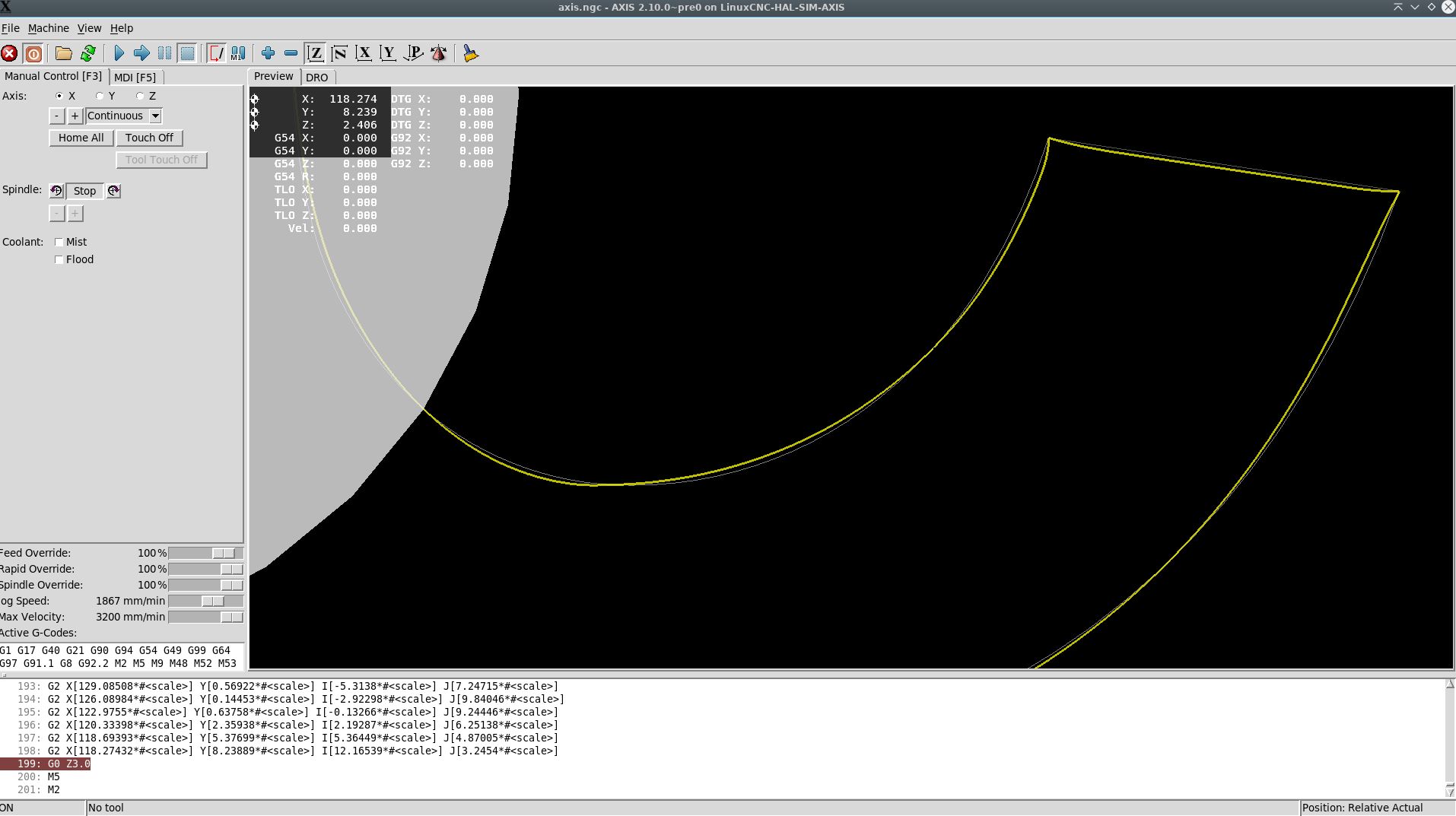

Today i started working on scurve again.
To inform you about current status.
I used the tp_scurve_skynet version and added 3 extra ruckig xyz runners on top of the tp runner.
Now in total there are 4 ruckig runners.
The runners are single dofs, one for tp, one for x, one for y, one for z.
The xyz runners must follow the xyz toolposition, performing a scurve motion profile. Notice,
the maxvel for the runners is the maxvel for tp, so no tp race is going on.
Then we can calculate the following error for xyz at runtime and display it with halscope :
Now this seems to work, in fact, here we eliminated the infinite jerk in one smart coding move.
Now to display this following error in axis, we could use the new axis c++ gui. Just an idea.
This new axis c++ gui can show us 2 tool cones. One cone for tp and one cone for following error.
Ok github is updated.
The following user(s) said Thank You: akb1212, tommylight, zmrdko

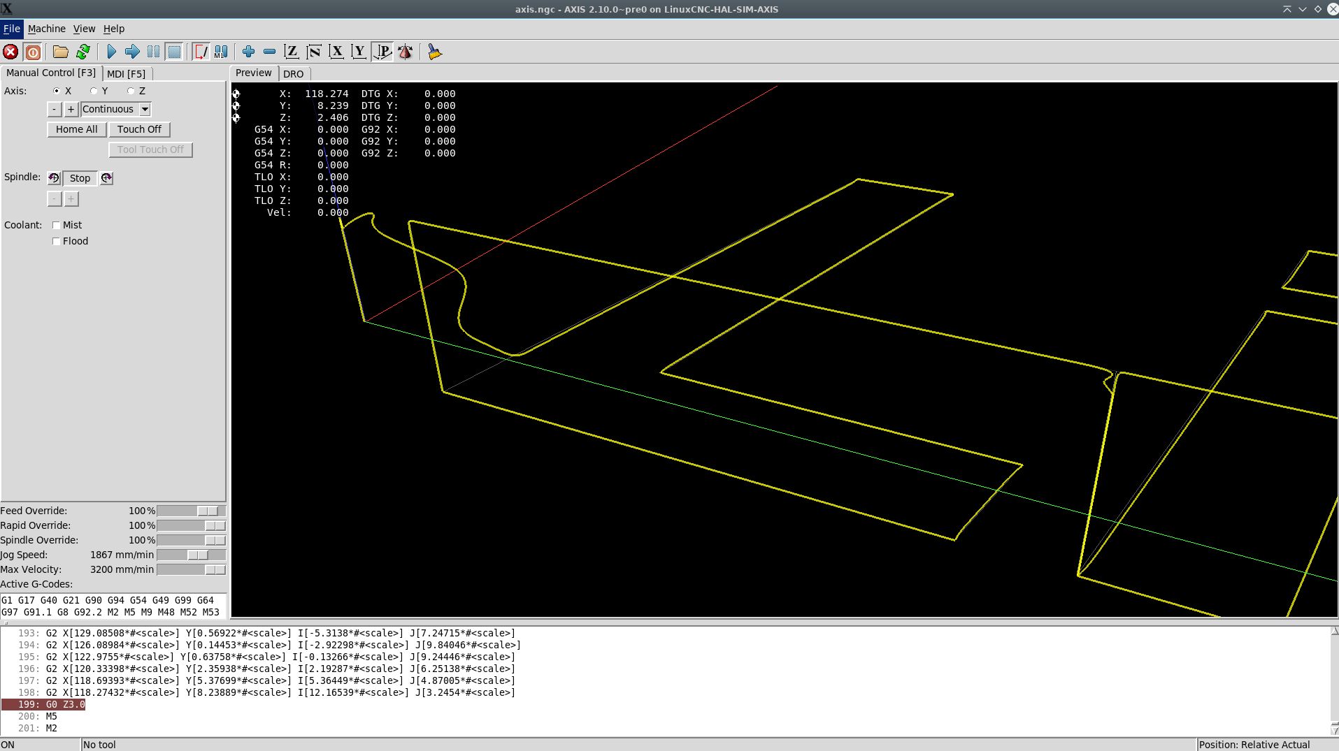

24 Nov 2023 09:47 #286408 by Grotius
Replied by Grotius on topic Trajectory Planner using Ruckig Lib
Ok now i say the tp has to output the value of our runners.
Only path rules are colinair segments and rapids.
Look at the stunning result.

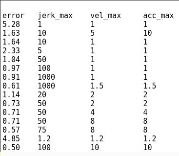

Here are some test values from repeatedly test the same linuxcnc startup screen gcode.
During runtime i can set the xyz runners input values like, maxacc, maxjerk & maxvel to by multiplied by a scale factor [x].
If scale factor >1,  they can keep up with the tp runner more easely.
Here are test outputs when using different scale factor[x] values for jerk_max, vel_max & acc_max.
The error value is the off path extrema in mm.
I found out :
The off path extrema is high at the end of a rapid.
When tp is doing g1,g2,g3, the runners do a good job and accuracy is quite good.
Next thing to test is a gcode with sharp corners and a gcode with fillet corners.

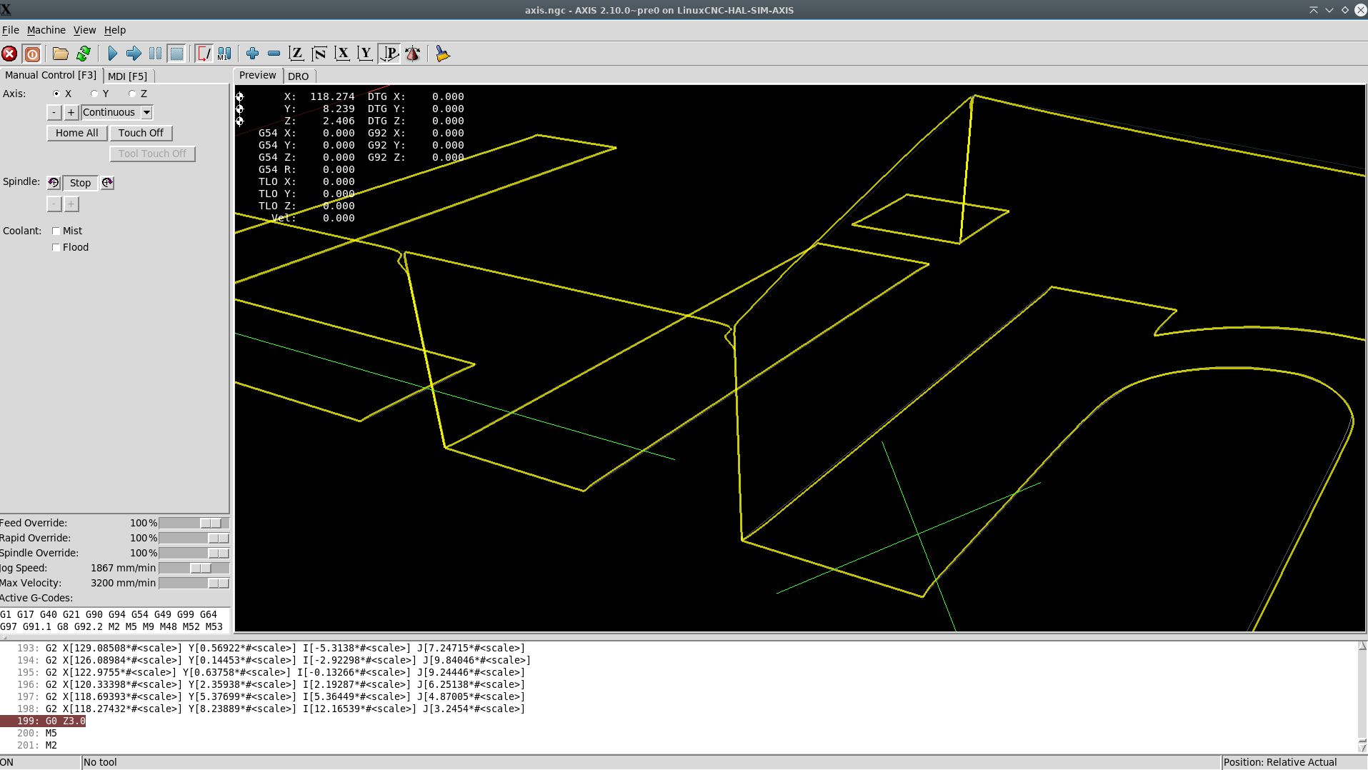

25 Nov 2023 09:24 #286467 by Grotius
Hi Guys,
I did another test today, wich seems to work out of the pandora box :
It is in fact the original lcnc trajectory planner written by Rob Ellenberg with another engine
under the hood. This engine are 3 ruckig runners hacked into his code.
The following user(s) said Thank You: Bari, akb1212, tommylight, tivoi, rodw, Joco, Beef
