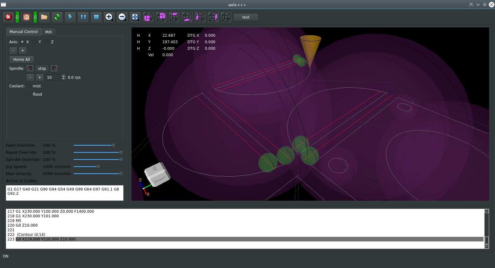

Hi Joco,
Oke thanks for your efforts again. If it won't work we will soon revert to another scurve component soon.
For a few day's now i am coding a 3d fillet libary. The status is that line-line fillets are working.
The line-arc fillets are almost working, see picture.
I had tried the opencascade fillet functions, but 1% off fillet requests will fail. So i spend 2 days on it, and had to move on.
Then i coded a new functions from scratch again,.
Every line-arc fillet has to be coded in 3d. Then things take some time. But we will do this.
The spheres are for controlling what i coded is ok.

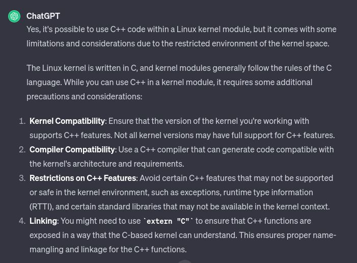

here is another complete AI generated C++ kernel module example joke: codepal.ai/code-generator/query/F52Ghwzg/c-kernel-driver
I know how to insert kernel modules, no need to point that out. A single hint to the place in your CMAKE files where you enable / configure / build for RTAI and compile the c++ stuff would suffice. or some pointer in your source how you manage to put libruckig (btw, ruckig uses exceptions!) into kernel mode. No c++ init found here github.com/grotius-cnc/linuxcnc/blob/33b...c/emc/tp/tpmod.c#L22 nor anywhere else. I only find the userspace stuff, but probably I'm not looking in the right place.
You are building for and running a userspace system on rt preempt. I don't know why you insist on that C++ kernel stuff. If that was possible, there would be no reason for the C interfaces in linuxcnc AT ALL and complex drivers (hostmot etc) could (and would) be written in C++. In the end it probably doesn't matter anyways because "nobody" is running RTAI and all kernel-mode realtime interfaces will become obsolete rather soonish. Be that as it may...
Much has been written about geometry, continuity, blablabla and that arc<->line transition geometry involves infinite jerk at the transition blablabla, I won't repeat more of that. You will need "fillets" of a different kind if you want jerk limited transitions, something like those quintic polynomials that openCN is using or something similar. Ruckig won't do that for you.
Ultimately it's your time to spend and your definition of fun. godspeed. I will check back in the new year.
