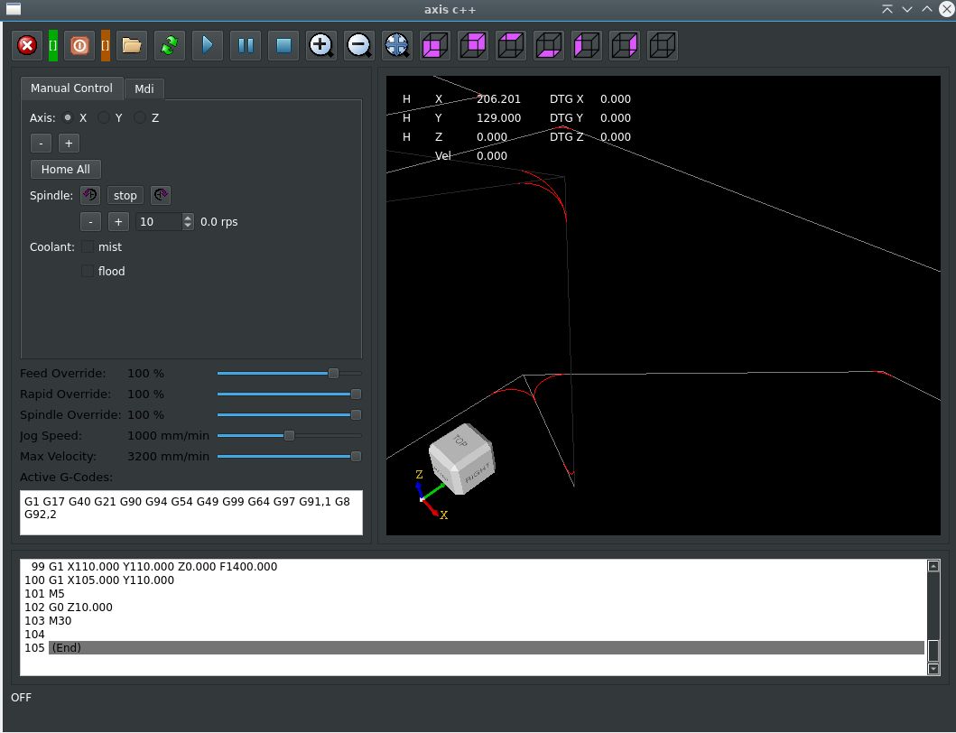

Hi Grotius. I got this compiled on my plasma table and gave it a whirl using the same config in use for previous tests. Just with new runner module active. Things home ok but as soon as I try and run a test ngc joints 0,1,2 all get follow errors. NB this is a 4 joint setup being a gantry machine.Hi Joco,
Good luck with your machine.
Indeed the xyz ruckig back-end runners ensure at least a valid motor output with no velocity jumps.
I still believe in our own trajectory planner, I think we have to add blending to it first.
Then we could use the G64 P0.01.
So i started writing a blending function, 3d blending wich works now for line-line blending. Arc-line blending still todo.
I will have another crack later in the day and if still having issues will attach the config in case you spot a silly mistake.
cheers - J.

@Grotius - did another test and all 4 joints generate follow errors as soon as push the "run" button. Homing works fine.
Attached is the config file in use.
I have run the same ngc using a standard setup of axis with no issues. See attached
Thanks - J.

Hi Joco,
Maybe try to edit line 816 from tp_runners.c to set lower values.
I used this fixed values to set the runners faster then the tp.
#include "stdio.h"
inline void update_ruckig_followers(TP_STRUCT * const tp){
// printf("update ruckig followers. \n");
rxyz.maxacc=tp->aMax*1.2;
rxyz.maxjerk=tp->max_jerk*10;
rxyz.maxvel = tp->vLimit*1.2;
I hope it will run on real hardware, offline it seemed to work out of the box. Good luck.
