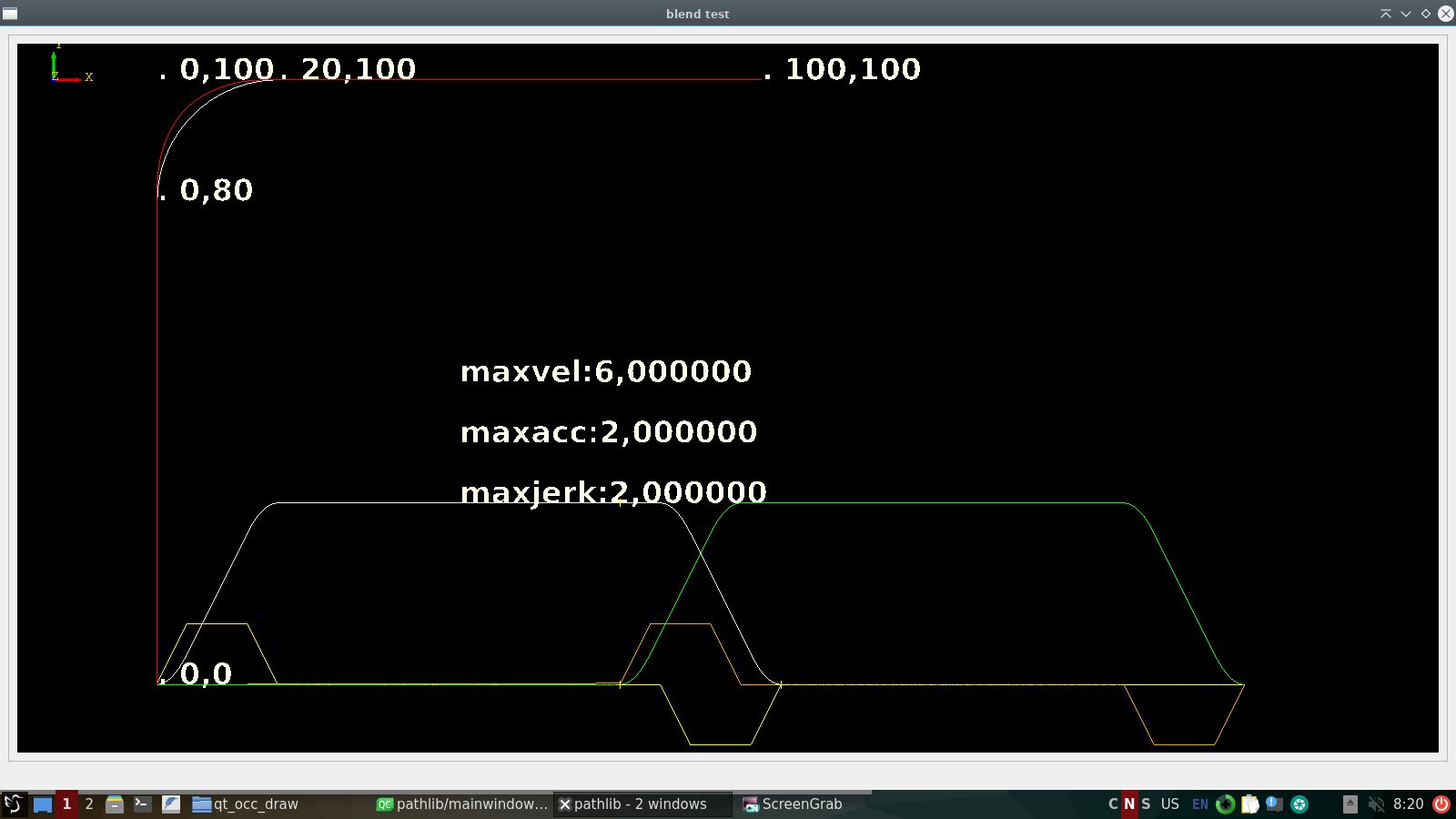

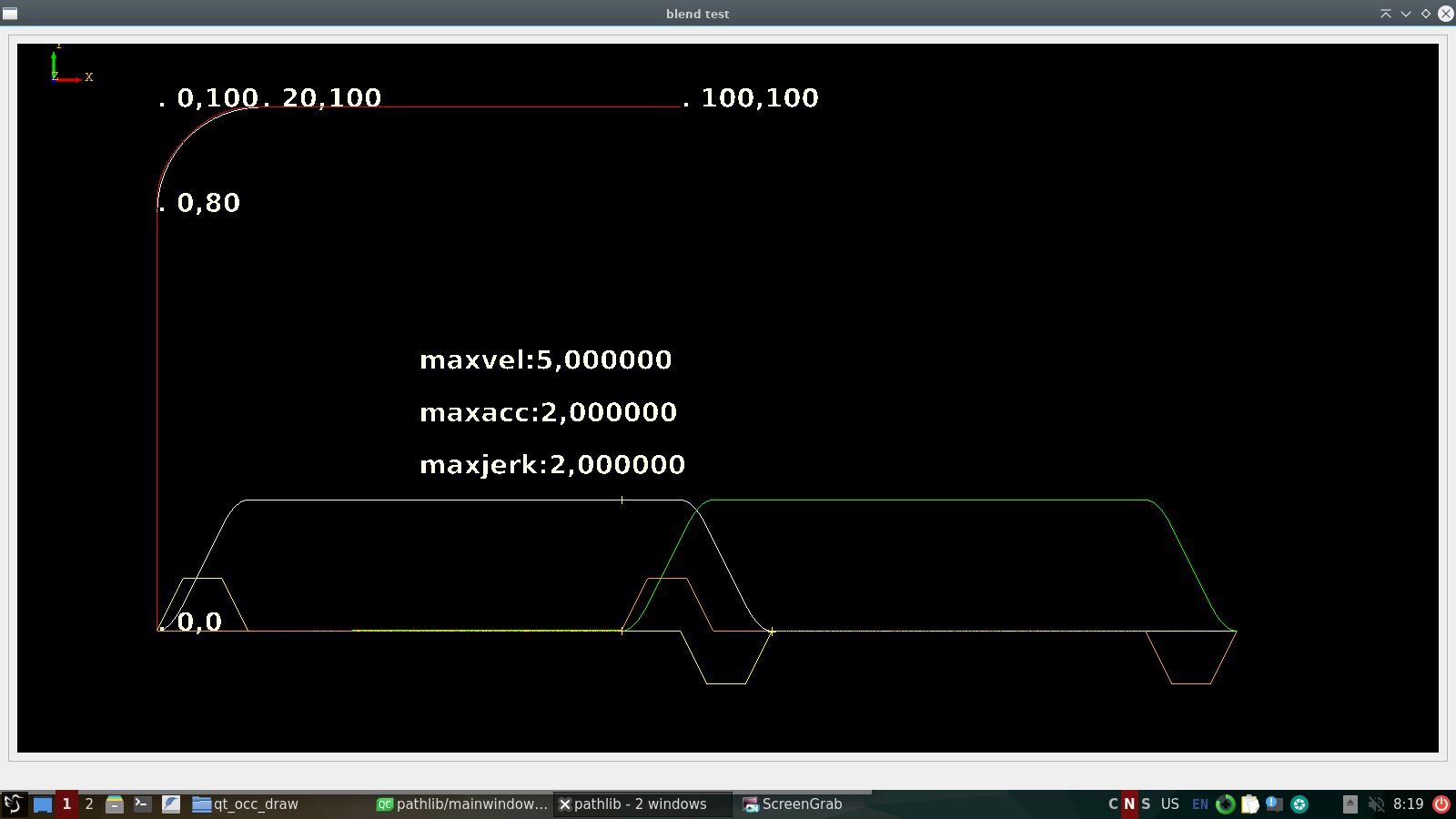

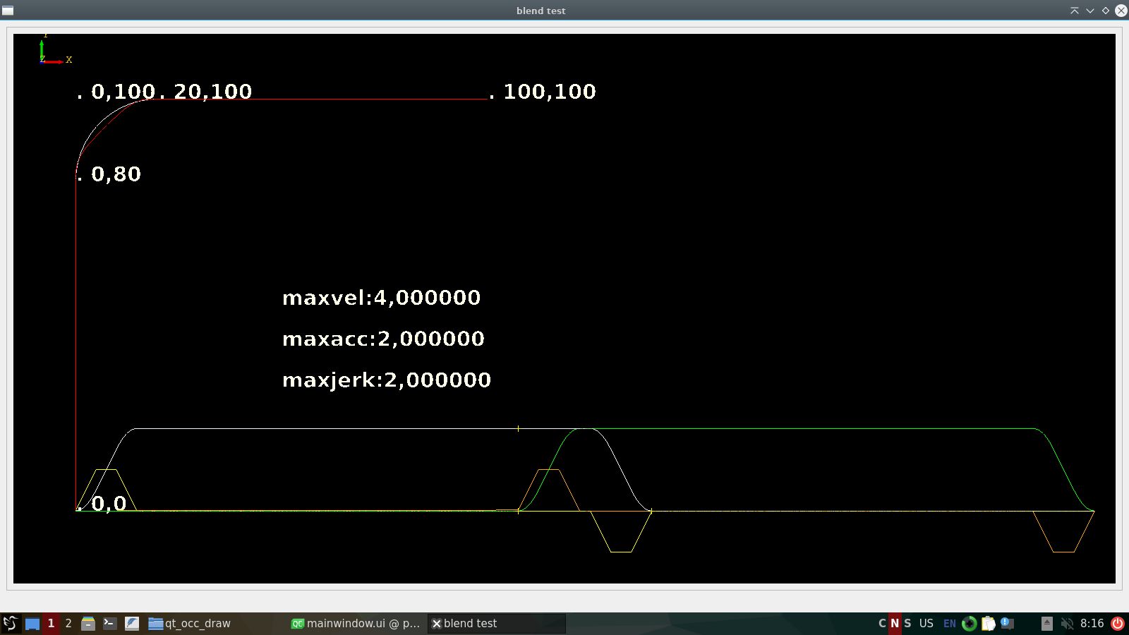

02 Feb 2024 06:32 #292212 by Grotius
Replied by Grotius on topic Trajectory Planner using Ruckig Lib
The project so far worked more or less okey when each g0,g1,g2,g3 had a start and stop.
I have seen a tiny bug wich is related to loading a arc, it doesn't read if arc is clockwise or counterclockwise.
This issue is resolvable.
So far my blending tryouts failed.
Last week i started thinking about how to go on with this project.
I made a test, wich i found out to be interesting. I will tell you how it works, and i hope you will understand,
and share a conclusion about it.
The question is : Is the X-axis capable to follow the Y-axis on the path?
The path test :
We have a path, containing 3 segments :
  • segment 1: a line from {0,0} to {0,80}.
  • segment 2: a clockwise arc from {0,80} to {20,100}.
  • segment 1: a line from {20,100} to {100,100}.
We have 2 ruckig runners (dofs). They share the same velocity max, jerk max and acceleration max values.
Compare the ruckig runners to a motor for x and y, using a scurve motion profile.
  • ruckig scurve runner, x axis.
  • ruckig scurve runner, y axis.
The motion command to the ruckig runners :
  • perform a motion for y axis from {0,0} to {0,100}.
  • when y axis is at {0,80,0} start x axis from {0,0} to {100,0}.
To make it simple, i made 3 runs with different velocity max values, identical for x and y:
Graph map :
  • On the bottom we have the velocity and acceleration graph.
  • On the bottom the 2 yellow points are at {0,80}, this is the begin of the arc.
  • The red line is are the position points for the ruckig runners x and y.
  • The white arc in the upper left corner represents segment 2.
Conclusion :
velocity=4.
We see the red arc in the upper left corner is inside the arc of segment 2.
This is good news. We could follow the white arc exactly doing interpolation, this involves slowing down the x axis
to follow the arc exactly.
In my opinion, this solution results in the optimal corner velocity.
velocity=5.
It's hard to see, but the red arc is outside the white arc, interpolation to get the x axis on the arc would only
work if we increase the x axis max-acceleration value. This option fails.
velocity=6.
The red arc is far outside the white arc. Its impossible to resolve a valid path.
I hope you can understand this mathematical problem, and i hope we can create a algoritme to solve this soon.

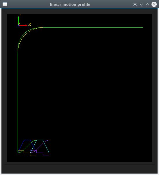

07 Feb 2024 15:11 #292784 by Grotius
I assume you get it to follow the path by increasing the max-acc?
Yes.
I dont understand what you mean with ”this option fails”.
It's not a good thing to use value's that are above machine limits and or user input for maxacc etc.
I did a second test using linear velocity profile, the 2 line and arc coordinates are the same as in previous post.
I had to make a c++ class for this, was a lot of work.
So far the waypoints that constructed the green arc, are outside the yelllow arc. The yellow arc is the exact path to follow.
So next thing is try to get exact path waypoints. With ruckig, this was a no go.
- Curve input -
vo:0.000 vm:10.000 ve:0.000 s:100.000 a:2.000
- Curve period t1 :acc
- Curve period t2 :steady
- Curve period t3 :dcc
- Curve times :
t1:5.000
t2:5.000
t3:5.000
ttot:15.000
- Curve displacement :
s1:25.000
s2:50.000
s3:25.000
stot:100.000

11 Feb 2024 04:04 #293071 by akb1212
Replied by akb1212 on topic Trajectory Planner using Ruckig Lib
Uh..... no.
I'm no porgramming expert, but I have worked in CAD/CAM as a professional, and also have a mill I use LincuxCNC on. So I realy appreciate your work here.
The point here is that when you go from straight corners with full stop with blending you alter the actual path.... we all get that. You will have corner rounding.
But.... the same happens here! When we go from simple corner rouunding to jerk limited corners the transition between the curves will "distort", and the path will obviously also look different. Just as above.
The corners will in fact end up with what is called a G2 curve. Look it up.
In your screenshot your green curve is in fact a G2 curve, where the transitions between the straitght parts and the curve have a transition, or a derivative which is the matematical description.
And.... this is a BETTER curve. If you look at it it is better resembling the sharp corner we came from. The closest part to the corner is closer to the corner with the green curce that it is for the yellow curve.
So, to me it looks like the Rucking Lib is doing it's job and modifying the curve to the desired G2 curve. This is what this lib. is doing! And you expected it to stay like the yellow corve, which is what it looks like without jerk limitation. You can't expect the curve to stay the same when you change the accelerations on the different axis indipendently. How much you allow them to change is one thing. But this is set by your allowed max accel values, and not much else.
Remember, your car will drive in a different path if you limit how fast you turn the steering wheel when turning. And you might end up having to have a sharper turn radius at the maximum if you have a low rate of turning the wheels, like your green curve. So you will have to factor this in when you set up the system. Because this might alter the requred max accelereations. But the jerks will be limited, which is the goal.
So I'd say you are absolutely going it the correct direction here!
Keep going with what you have here.
