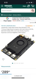

What do you think about the Latte panda 3 delta ?
I like the idea of a single board computer but don’t want to get something that looks isn’t going to do the job well.
I use to like the idea of building computers and have done several when I was younger. I just don’t find that exciting anymore and would rather not.

26 Nov 2023 21:21 #286582
by Etkoehn
Replied by Etkoehn on topic Cnc table for plasma cutter!
Hello, CNC Friends
So I spent a lot of money the last coupler of days. I have purchased a lot of stuff for a cnc table. hopefully I wasn't to cheap....I probably was but the price of things have gone way up . So I went with the LattePanda. probably a bad choice, I was waiting for experts to join in but did not hear nothing. If you have better options for around the same price let me know, I could always return this. My original plan was with rack and pinion but after reading some of tommylight posts I decided to go with cog belt. I would like to use aluminum but the price is so high I will be making it all steel. My gantry with be made from 1.5"x4" tubing 1/8" thick. not as light as I would like it but it will have to do. My width of gantry will be around 62" with around 48" usable cutting with and around 60" cutting length. I will be using nema 23 motors 425oz for the x and y and 178oz for the z. I will ride on linear bearings HGR15s. For the Z axis i will use a double 10" draw slide as tommylight suggests and I will use a 8mm acme thread. I ordered the Mesa 7i96 board with THCAD2 boards. I am not sure if the THCAD2 would be the best but I contacted Mesa and that's what they recommended for the hypertherm powermax 85. So after looking, my plasma cutter doesn't have the built in voltage divider, so I will have to purchase that also to get it set up. So I have screen recording of my 3d drawing.
<iframe width="560" height="315" src="" title="YouTube video player" frameborder="0" allow="accelerometer; autoplay; clipboard-write; encrypted-media; gyroscope; picture-in-picture; web-share" allowfullscreen>
