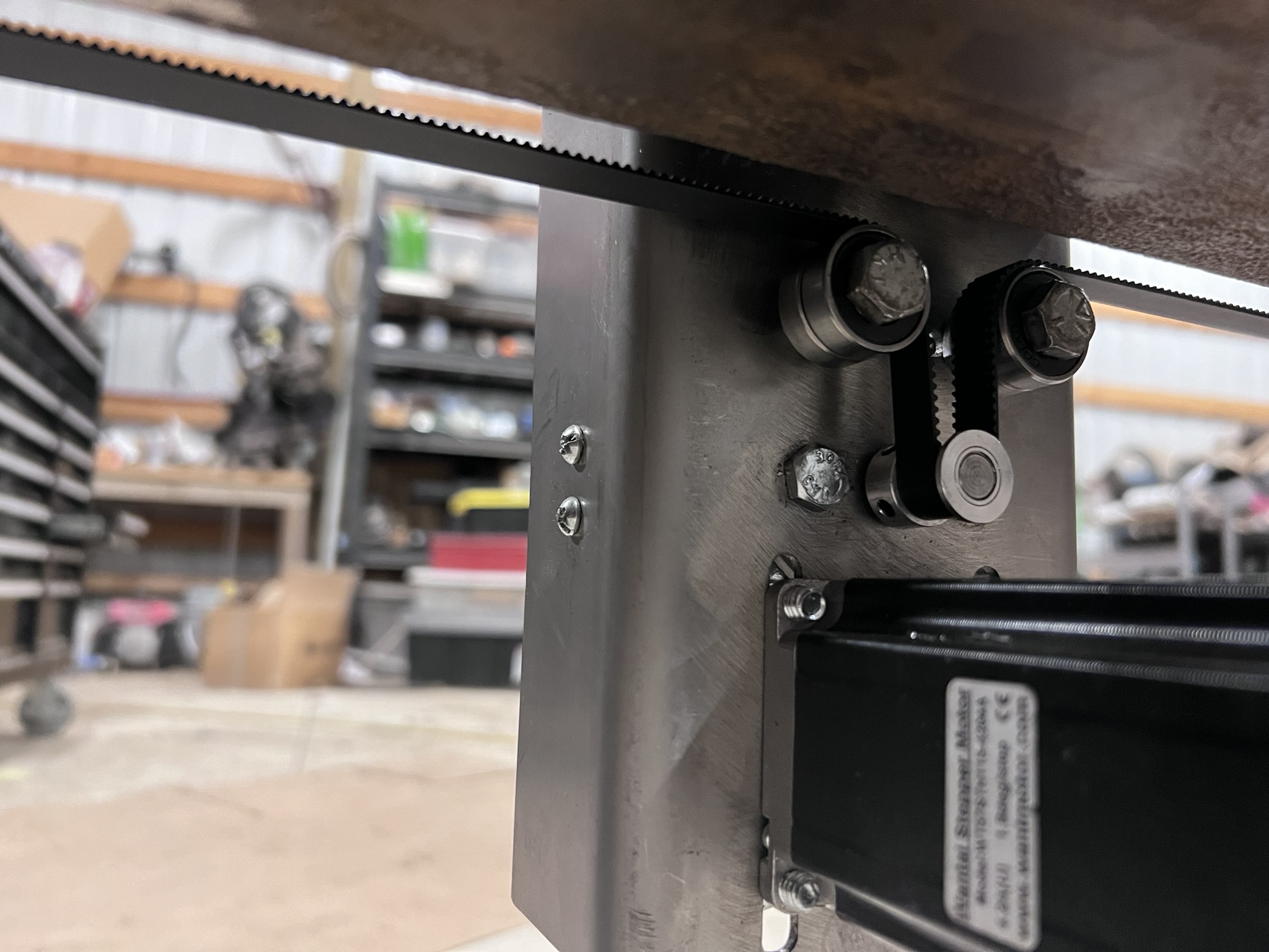

Replied by tommylight on topic Cnc table for plasma cutter!
Pictures of the pulley mounts?
Usually that happens when the pulley or idlers are at an angle i.e. not normal to mounting plate and tightened to much.
To check tightness i hang 5kg weight in the middle of the belt length and tighten till it droops 1cm only. This is for 3.3 meter length of HTD3 15mm wide belt.

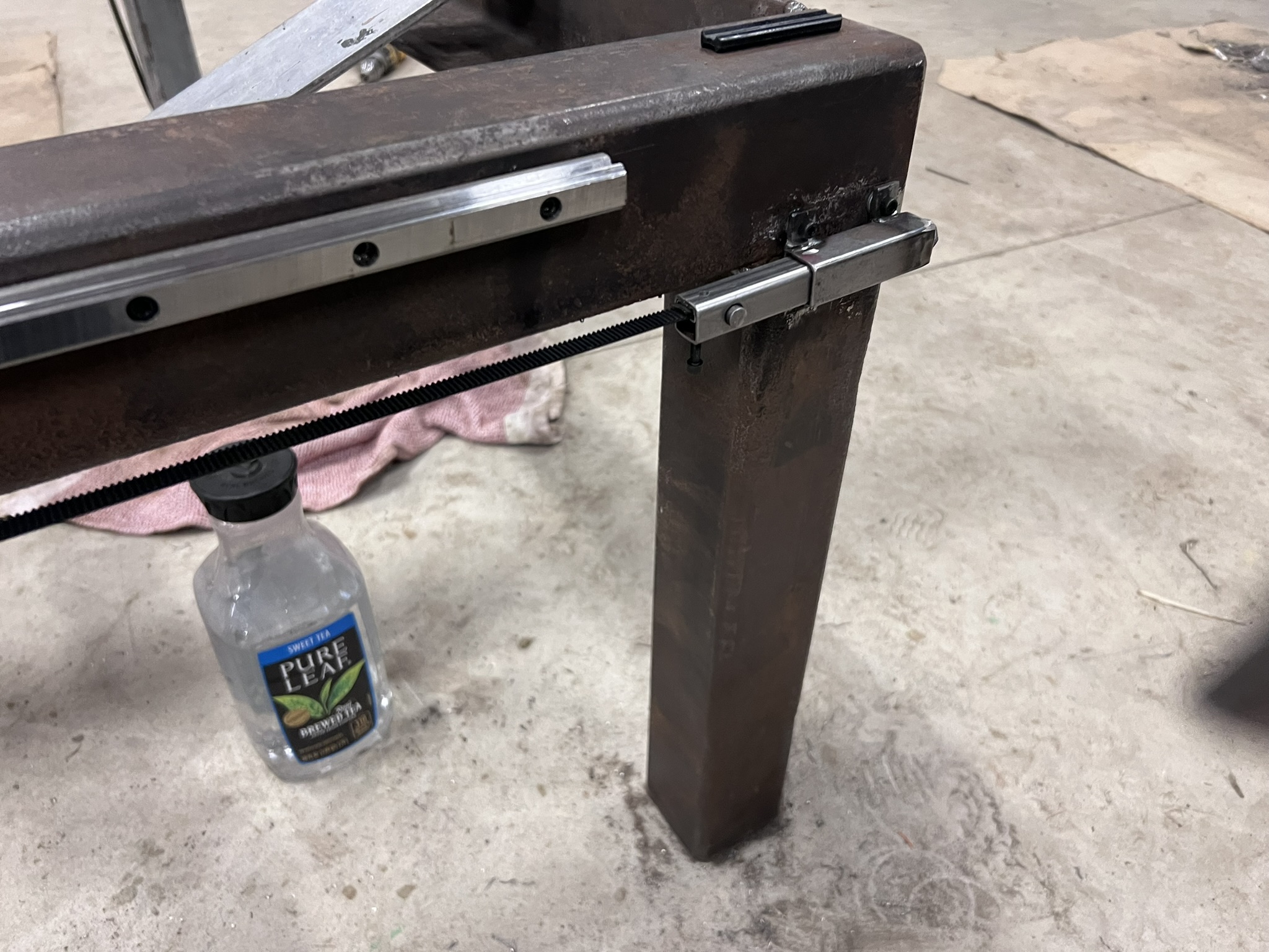

Here is a couple picture of it. Do you think it would be better for me to use 15mm wide belts instead of 10?
I did not take a picture of the side with the broken belt. However its looks like this accept i did belt the bolts upward slightly to try to push the belt toward the motor more. The belts were riding off the sprocket/pulley away from the motor
Here is my tension, I made mini bryant adjusters. I may have had it to tight, do you think that makes it want to ride off more?
So I have tracked many conveyor belts and I know sometimes there seem to do wacky things if to tight or to loose. Some of those you just know the old warn out conveyor and what it needs to track right other ones you can fight it for hours.

29 Dec 2023 06:06 #289307
Loosen the belts, tight enough to stay in place only.
Fix tracking, this might be tricky, depending on how the idlers are mounted. They must be 90 degrees on all sides.
One way to make sure they are 90 degrees is to drill the mounting plate (not tap) and use two nuts on each side of the idler screw.
If using normal bearings with no flanges, use big washers.
Do the idler bearings spin freely without the belt?
What microstepping are the drives set at? 1/16 should be ok.
10mm belt will do for 25kg, but the aceeleration must be lowered to probably 250-300mm/s/s to prevent flexing when changing direction.
Do not buy wider belts before fixing the tracking issues.
