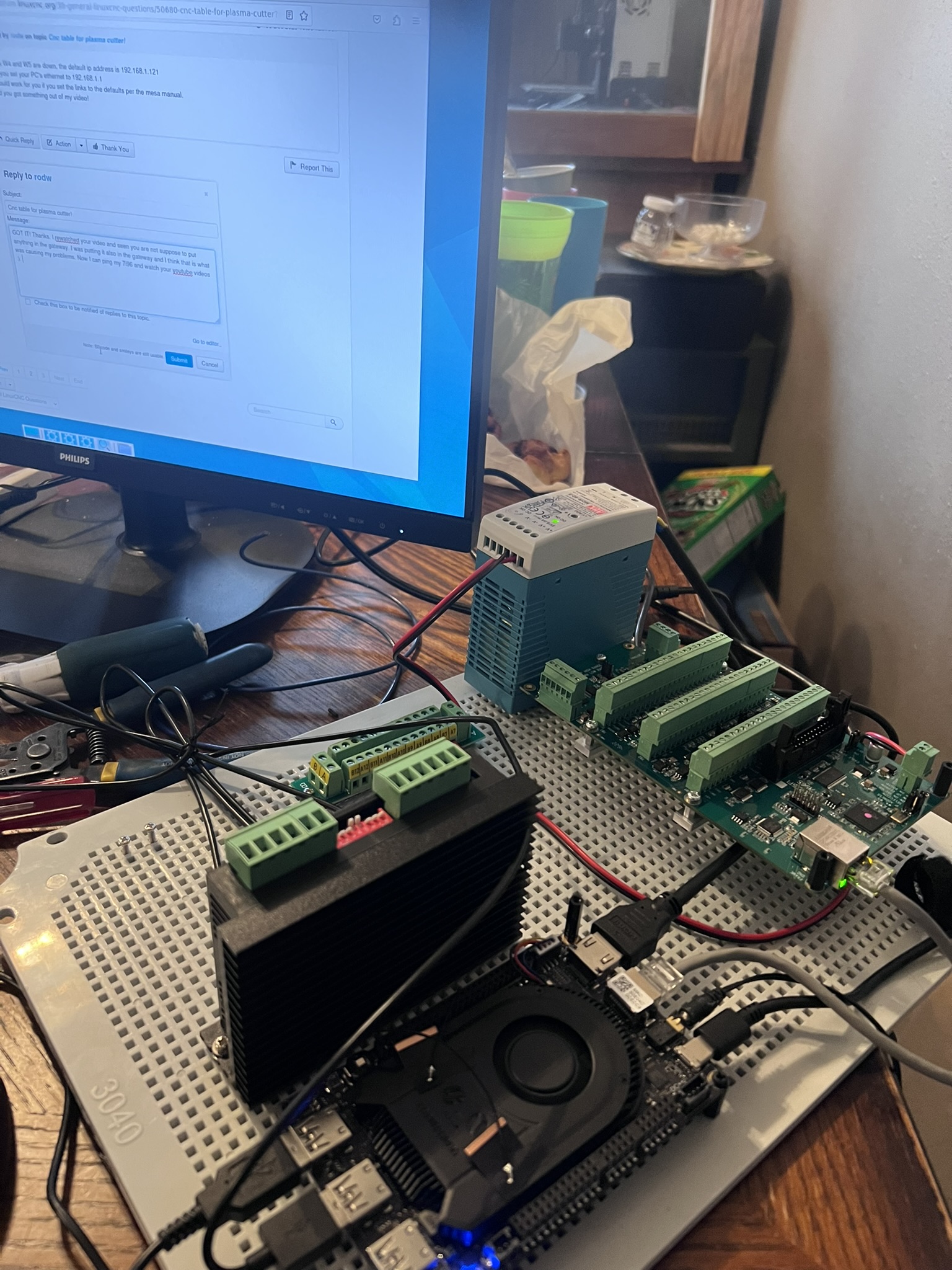

03 Dec 2023 02:31 #287072 by Etkoehn
Replied by Etkoehn on topic Cnc table for plasma cutter!
Its late and I will have to double check some things in the morning but, I cannot get me Panda internet through wifi while connected to the Mesa (it came in early ) through the ethernet. I have to double check and make sure I changed the ethernet to manual IP correctly(I am able to ping the Mesa) so i think its correct. My router is set to 10.0.0.1 on the IP. Would this be causing the issues?
I think i need to rewatch rodw videos again, but for now any information would be much appreciated.
As far as parts go, I got my rails today and pc monitor. Actually i got them yesterday but the delivery man left them by my fence in the snow/rain. Luckily Everything was fine. Power supplies are here, drivers, some pulleys and belts. I am still waiting on the reduction pulleys/belts and also my stepper motors, then I need to pick up some steel for the gantry and I will be ready to go.
03 Dec 2023 04:38 #287084 by rodw
Replied by rodw on topic Cnc table for plasma cutter!
If links W4 and W5 are down, the default ip address is 192.168.1.121
So if you set your PC's ethernet to 192.168.1.1
It should work for you if you set the links to the defaults per the mesa manual.
Glad you got something out of my video!
  • Etkoehn
  • Etkoehn's Avatar Topic Author
  • Offline
  • Senior Member
  • Senior Member
03 Dec 2023 12:42 #287118 by Etkoehn
GOT IT! Thanks, I rewatched your video and seen you are not suppose to put anything in the gateway. I was putting it also in the gateway and I think that is what was causing my problems. Now I can ping my 7i96 and watch your youtube videos .  Here is my testing station. I need to see if i have a little relay i can run on this..... I do i just need to find them.
04 Dec 2023 00:01 - 04 Dec 2023 00:02 #287166 by rodw
If you have a 7i96s there, you should not even need a relay. Last time I checked the outputs were OK for 2 amps and nothong in plasma uses that much current. I used the Mesa 7i76e spindle on relay on my plasma machine for torch on and it worked perfect.
