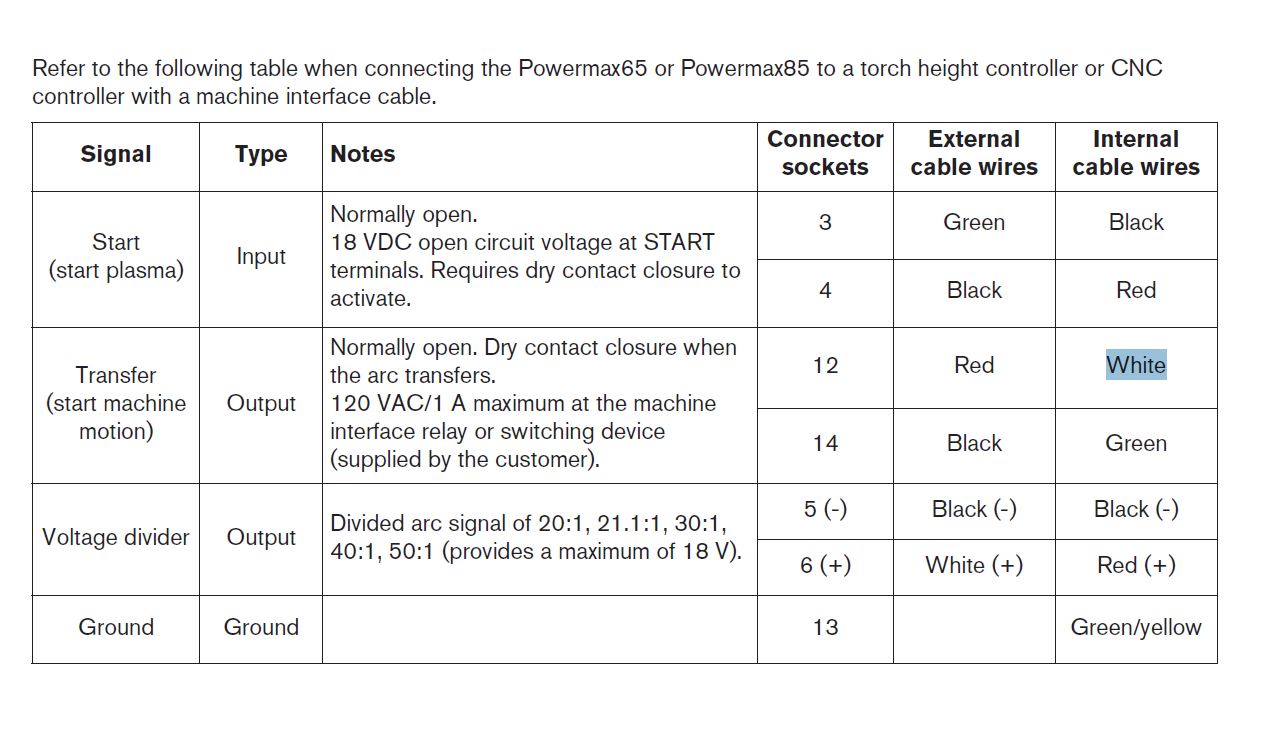

Hello,
So I have decided to not go with the voltage divider from Hypertherm and just make my own. I believe I have found where all the wires are located that I will need. Check out pictures below.
J32 plug appears to be where I will be getting my arc voltage from
J18 is Arc transfer(arc ok) and Plasma start
In this photo is shows which wires are what on the plugs
Starting from the top J18 Red and Black = Start plasma, Green and White = Arc transfer (ArcOk)
J32 Black and Red = Raw Arc Voltage
So to wire this up, J18 red and black wire them to my Mesa board output + - and the green and white I hook the white to my input and the green wire to power supply. J32 Red wire a resistor(Size unknown) second resistor(size unknown) after the first to the black wire black wire to negative side of THCAD2 and red wire after R1 to positive side of TCHAD
So I have a question for you tommylight . I have seen you say that all one needs its two resistors 1Mohm rated at 2 watts and connect one to each wire and not a voltage divider. So my question is if I was to do it this way could I still mount my THCAD2 in the control cabinet or would I have to mount it on the plamsa machine? My mind tells me this would still be high voltage but very low current but I haven't done any calculations on this to see how low the current would be since I don't know how much currents these machines pull.

Yes, 2 of 1MOhm resistors will do, mount them inside the plasma, then it should be OK to mount THCAD inside the cabinet.

I curious about the voltage for arc voltage. If running it through a voltage divider, what is the voltage I am looking to get? I am trying to understand it and the voltage that I think am shooting for is dependent if I have my thcad2 set to 5v or 10v. So if set to 10v I need to set my voltage divider to send out arc 10 volts to the thc? If wrong please correct me and educate me on what's going on here.
Second, to determine the resistors.
Do I base it off the open circuit voltage of 305v? Would I then use a 30:1 divider? or is it based of the rated output voltage of 143 and using a 15:1 voltage divider.(ratios based off of assumption above)

The THCADS and the power supply I mentioned are both rated to overvoltage of 500 volts way above your open circuit voltage so you won't kill anything!
The normal cutting range is 130v to 170v or so but check your cut charts.
Voltage will likely go over 300 volts briefly when piercing but that does not matter at all because the THC is not enabled at that time. If you plot the voltage with halscope, it will just show up as a flat line when the thcad hits 10 volts (or a little over)
I'm just going to invent a rule of thumb here and say up to 65 amps, use the 10 volt setting and set full scale at 200 volts (20:1) and above that set it to 300v (30:1)
The goal here is to get better resolution from the analog to digital conversion to use as much of that that full scale when cutting.
I never had any issues with my thermal dynamics 120 amp machine with 30:1 and most of my cutting was at 40 amps (It did not have a lower divider or I would have tried it.)
