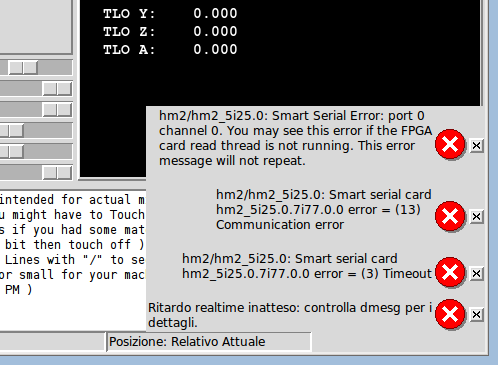

I have mount a 5i25 and 7i77 board .... run pnconf (i see 5i25 internal option) than configure the board (7i77 * 2 with one 7i77 option) .... but my config not run and dsmg make this message:
i'm unable to understand the problem .... in lib/firmware/hm2 not see any 5i25 folder ...
I'm on linuxcnc 2.6 ubuntu

k1@k1-desktop:~$i'm unable to understand the problem .... in lib/firmware/hm2 not see any 5i25 folder ...

[ 551.774883] hm2/hm2_5i25.0: config.num_encoders=6, but only 2 are available, not loading driver
[ 551.774894] hm2/hm2_5i25.0: failed to parse Module Descriptor 2
i would say you have a configuration error , also pncconf cannot find the pci slot
did you have the 5i25 & the 7i77 connected and powered up , especialy the field power on the 7i77
their is no bit file for the 5i25 , this is flashed to the 5i25 permanantly , and is not as per older versions , where it is uploaded on demand
re-run pncconf with the cards connected etc , should help
chances are you were configuring for the external port , rather than the internal , if that was your intention

I think the proble regard 5i25 programming. In my 5i25 there are no label about ... i have more then one card .... I try to change it to another one ..... all works ...(there are some error when start axis gui... i talk about at the end) .... I thik I try a card with program for 7i76 not for 7i77 .....
anyway axis gives me error on startup .... I have no ancorta connected encoder and motor but only ingrssi and digital outputs for testing ..... always use for testing a flat cable 80cm and 5V external .
This is somethings that not understand.

for using 7i77 or 7i76 field power must be applied , or gpio pins are not available
pncconf will look for this.
this is the error your screenshot is showing , it cannot find the onboard serial port on the 7i77 , so unable to configure

ok in pnnconf if not select smart serial 1 I'm not able to select in/out in all TB7 and TB8 ... but i have only 8+4 in/out..
some suggest?

today I have use the 5i25 folder from mesa site.
in the utility folder there is mesaflash..... I use it ..... mesaflash --device 5i25 --reload is't present ..... than I have reboot after --write command ...I used --verify command with succes. With sudo nautilus I copy bit file xml and other in a new 5i25 folder on /lib/firmware/hm2 folder
In the pncconf wizard in the page for choice the board I select 7i77x2 .... but I have only one (no problem for this). I have 5 axis and 1 jog wheel, than I select 6 encoder.. no other choice is possible (pwm or other). I can choice only number of channel or number of smart serial (obviusly i can select or deselect external card "saNITY CHEK").
If select 1 smart serial (or two) I can see tb8 and tb7 and analog output, otherwise i can see only i/o 2 connector and i/o 3 connector.
Is normal these?
I ask because when launch axis all work fine but i steel see the error in the sreenshot-34.pgn posted at the beginning.
Tomorrow I try with install mesaflash from repo.
regard
giorgio

Replied by PCW on topic mesa card 5i25 kernel error
The sserial errors probably mean that you dont have field power supplied to the 7I77s digital I/O section

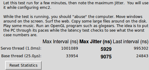

You also have a real time delay error that is unrelated (perhaps you need to run the latency test to check the PC)

Ok. than the windows that I see is ok.........
the 7i77 have 5v external power and field power to 24V.
Connector 1-2-3-4 is on +24Vand nr.8 to 0V (switching ac dc power). VIN connector is free and W1 in left hand position.
latency test running with several open windows show 5000-6000 and is totally similar to these:
the pc is an ASRock AD2550B-ITX ....... the 5i25 metal base in directly grounded on the switchboard, is this a problem?
In set up I have write the servo period to 1000000.... I not see the label for base period set up (I must only run latency test in the set up?)
I connect some button and a jog whell .... it works fine and I see it working ok on hal scope and in halmeter pin/signal section..... I have not connected anlog out to drive and pulse input to encoder, except a jog wheel.

You do have a real time fault of some kind (The last message on your screen shot)
No sure why you are having communication errors.
These are usually related to cable problems or power supply issues
What parallel cable are you using (is it one from Mesa or dId you supply it)
and what length is the cable?
