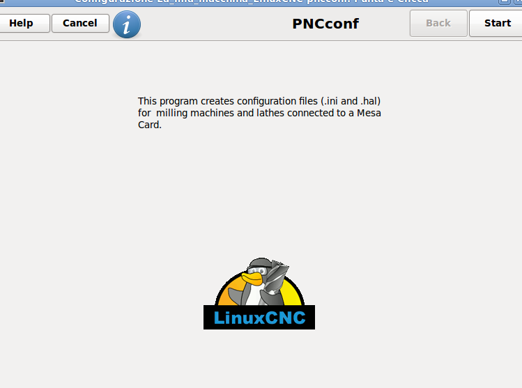

ok But I use ubuntu 10.04 .... see my image ...NO TB5 CONFIGURATOR.
see cncbasher on wheezy ..... it see TB7 TB8 TB5 configurator. .......
It is only a pncconf problem on ubuntu 10.04? ok please send me a 4axis (ecoder and analogue) + 16 in out configuration makine for axis gui ... I try it and if it works i make my configuration by hand.

pncconf needs the 7i77x2.xml file to be in /lib/firmware/hm2/5125 , and with root permissions
u must use sudo to copy these to the folder , without them pncconf cannot work
sudo cp *.xml /lib/firmware/hm2/5i25

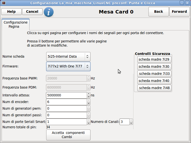

19 Oct 2015 23:24 - 19 Oct 2015 23:56 #63962 by PCW
Replied by PCW on topic mesa card 5i25 kernel error
I just did this with 2.7 and all works fine
Here is the sequence I used:
launch pncconf
press start
press forward
press forward
press forward
select 5i25-Internal-Data
select 7i77x2 with one 7I77
press accept component changes
(SS0 and SS1 tabs appear with TB 5, 7,8 options available)
(I have _NO_ xml files on my system, they are not needed if you choose the 5i25-Internal-Data option)

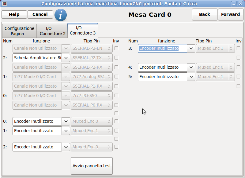

20 Oct 2015 00:08 #63967 by bkt
Replied by bkt on topic mesa card 5i25 kernel error
@PCW
launch pncconf
press start
press forward
press forward
press forward
and voilà ... no TB7 no TB8 no TB5 ... I must select on panel wit connector3 7i77 mode 3 than appear SS0 panel but without TB5 .... only TB7 and TB8
@cncbasher .... with or without folder 5i25 with only .xml file ... the same result. :sick: :sick:

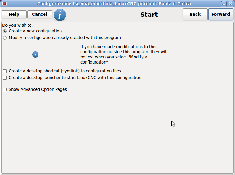

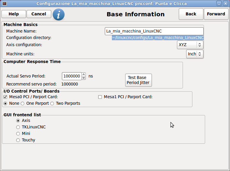

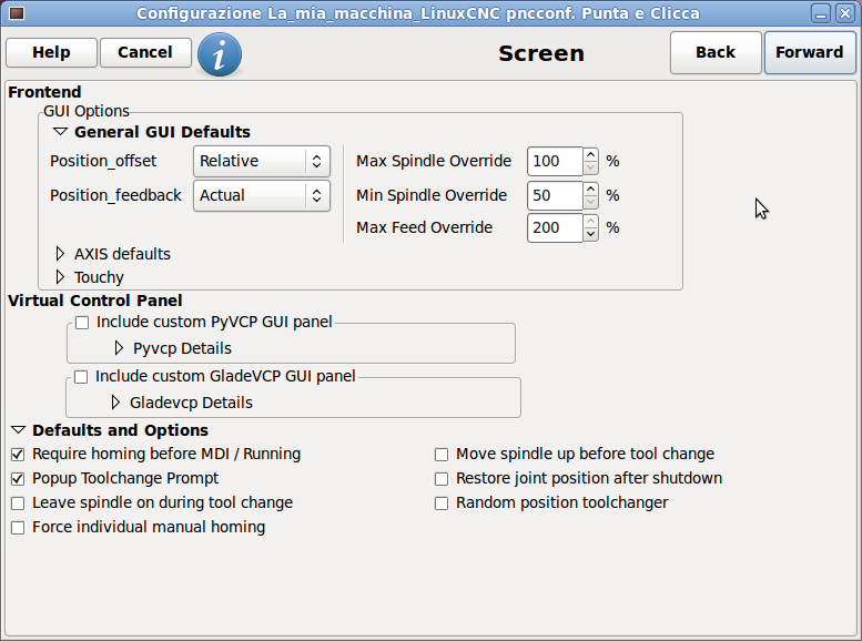

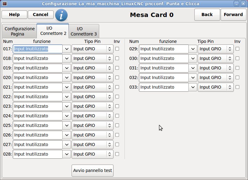

step by step with image ..... @PCW
@cncbasher .... with 5i25 7i77x2 at point/image 5/f5 the same result for me ..... :evil: :evil:
In addiction the button "start panel test" not work at all .....
Last edit: 20 Oct 2015 00:18 by bkt.

@cncbasher I see your image only with the old release of linuxcnc 4 days ago (linuxcnc 2.6.3) ..... now with a fresh install of ubuntu 10.04 (from linuxcnc repo ... with old linuxcnc 2.5) and wit the upgrade version of linuxcnc 2.7 .. I never see it.
in my motherboard (asrock ad2550B mini-itx) ubuntu 10.04 have a good result with latency test ..... with wheezy a real bad,so yesterday I make a fresh install of ubuntu 10.04 + linuxcnc 2.5 from linuxcnc forum repo.... than I update to 2.6 and I update another time to 2.7.
AT LAST WE CAN THINK THAT 5I25 + 7I77 + UBUNTU 10.04 + LINUXCNC 2.7 + PNCCONFIG NOT WORK AT ALL...IS RIGHT?
i try to install wheezy for curiosity but not fo usage. you can suggest other similar board?

I develop on a 10.04 machine (I dislike wheezy)- so pncconf most assuredly works with 2.7 on 10.04.
Not sure what is happening but it seems you are not getting the most up-to-date pncconf.
Even saying that I can't get that failure on 2.7.0 and can't see a bug fix in 2.6 that would cover that.
How are you getting linuxcnc? is it off the cd? do you upgrade it ? or are you using a RIP version/
Very weird
I might say if you install wheezy / 2.7 for a test - go ahead and make you config...it will work for 10.04 / 2.7 also
