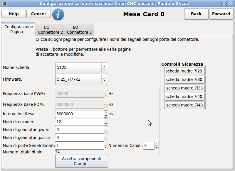

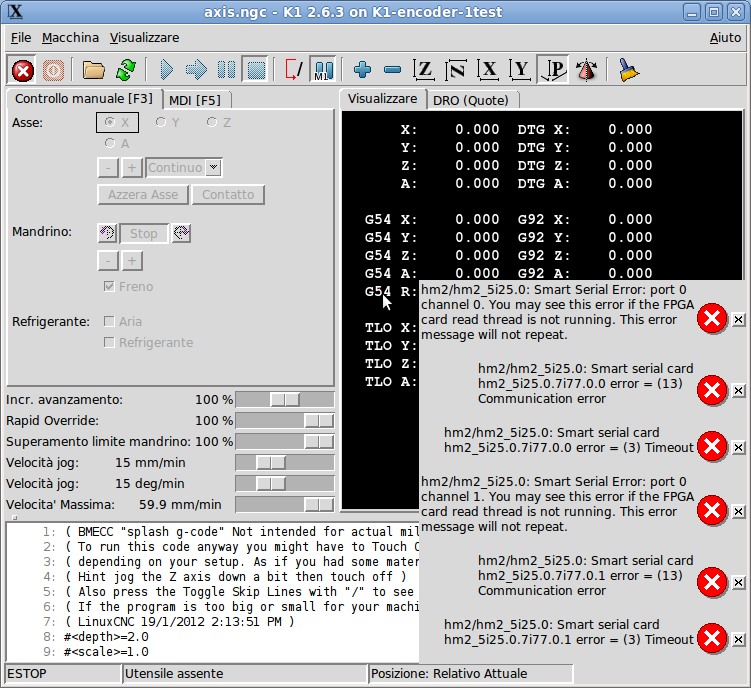

ok ... now is my situation:
1 - I've install mesaflash from repo. I write 7i77x2.bit file with new mesaflash.
2- I control the power and adjust it (in the past it is not so good) now I have 24,4V and 5.3V power supply.
3- 5i25 have: w1 down -- w2 downd -- w3 up -- w4 up -- w5 up
4-7i77 have: w1 left -- w5 right all other equal to image on the manual
5-in 7i77 pield power nr. 1/2/3/4 connector is at 24.4V nr. 8 to gnd
6- encoder 5 is connectded (external jog weel) other is free
7- dvr0 to dvr5 is free
8- TB7 connector 16-23 is connect to input (+24 powered) all other is unconnected
9- TB8 is unconnected
10 - I re-reun pncconfig and re-run latency test with several windows and 2 video online (youtube) .... maxjitter 12000/13000 (I think is all ok ... is right?) I set 3 channel and 1 smart serial ... I set 6 encoder and 5 pwm and 24 input and 16 output ..... in the field that appear for 1 channel for an other 7i77 I/O board (or other) I write "unused" ...
This is the result .....
I can add a ieee1284 cable .... not change the situation .... the machinery is not running!!
this the dmesg file :
File Attachment:
File Name: k-1-dmesg-...mesa.txt
File Size:27 KB
some other suggest?

16 Oct 2015 18:45 #63841 by PCW
Replied by PCW on topic mesa card 5i25 kernel error
Not sure whats going on but it looks like you have communications working until
the real time thread starts (that is the 7I77 sserial devices were discovered over the serial links
but then the serial links quit working later on)
I wonder if the real time issue is triggering a watchdog bite (this would cause loss of communication)
Can you try setting the watchdog timeout longer (say 50 ms)?

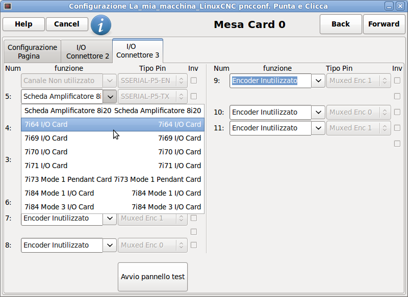

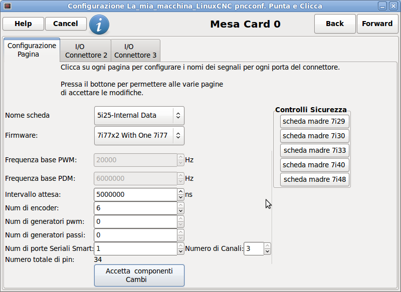

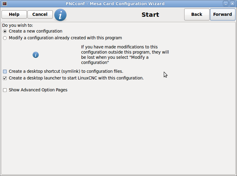

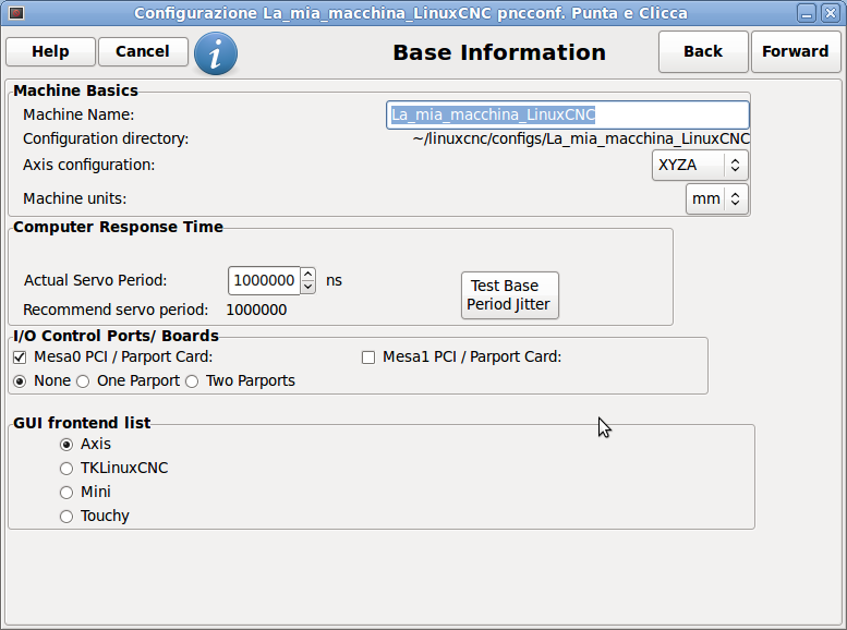

16 Oct 2015 19:26 #63842 by bkt
Replied by bkt on topic mesa card 5i25 kernel error
your second time ask regards my linuxcnc version ..

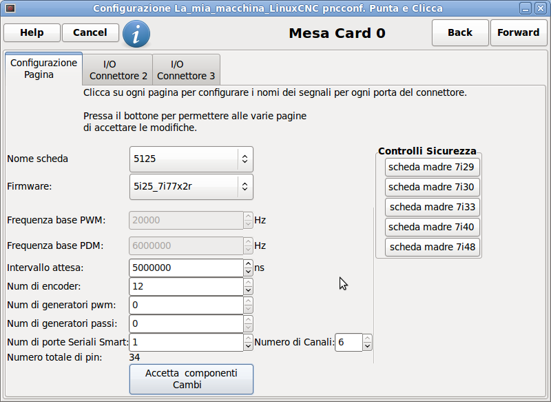

I intrigued me ... so I did the upgrade to 2.7.0, always keeping ubuntu 04.10 .... a mess .... what you see in the pictures is normal or am I missing pieces to be able to use pnconf?
I used the option 5i25 and I did not use the option 5i25 internal ...
for example, you can no longer see the smart series, so they are unable to use all of the I / O card 7i77 ....
I tried configurations 7i77x2 and 7i77x2r ....
  • bkt

16 Oct 2015 19:29 - 16 Oct 2015 19:29 #63843 by bkt
sorry ... the image:
You see I have no option for using 7i77 in mode 0 or 1 or 2
Last edit: 16 Oct 2015 19:29 by bkt.
