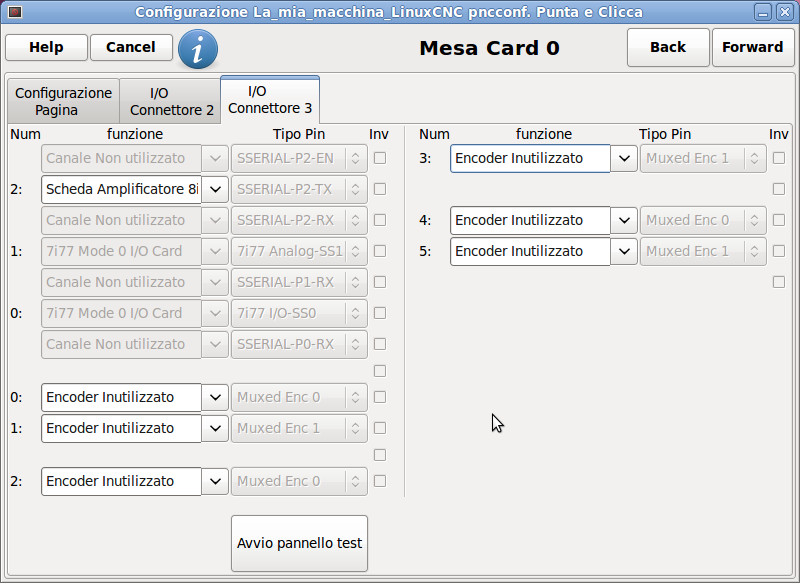

today I downloaded new iso ubuntu10.04 + linuxcnc2.5 .... verify with md5sum (ok) ... installed ... run stepconf 1 time with parallel port ok! Using software source and synaptic I upgrade to 2.6.10 ... re.run the pc.... run stepconf 1 time with parallel port ok! ... re.run the pc ....Using software source and synaptic I upgrade to 2.7.1 ....re.run the pc.... run stepconf 1 time with parallel port ok! ... run PnConfig ... the same NOT APPEAR TB5 CONNECTOR ....not appear SS0 and SS1 page ... nothing about TB7 and TB8 .....

I-ve installed wheezy + linuxcnc 2.7 with american language ..... pcconfig run as aspected ..... but I-ve many error about serial comunication ... see demsg

Not sure whats going on, but I simply cannot duplicate _any_ of your issues here.
Start with Atom D510 (I thought it was a D525 but it was really a D510) with Ubuntu 10.04 / LinuxCNC 2.5.4
upgrade to 2.7.1 using the wiki instructions
Run pncconf and create a 3 axis config for a 5I25/7I77 using internal 5I25 data and 7i77x2 with one 7I77 option
(no issues, I assign PWM outputs on the SS1 (TB5) tab and encoders on the P3 tab)
start linuxcnc and select the just created: my_LinuxCNC_Machine
LinuxCNC starts, no errors
(its running now, I'll leave it on for a few days but I don't expect any problems)
The question is: what is different on your machine?
