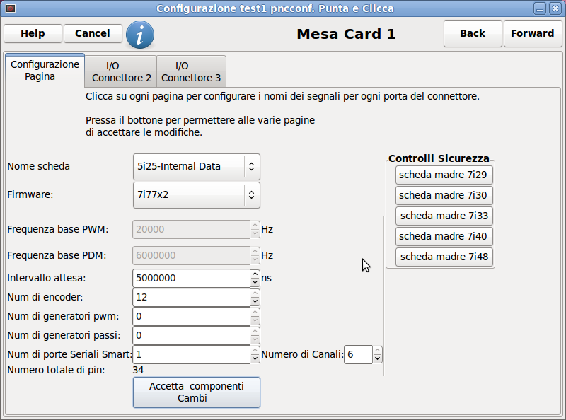

You can use the 5i25 internal pncconf settings for a 7I77 so you dont need any additional
xml/pin/bit files
I would try with pncconfs 5i25-internal settings, the 5I25 programmed with 5i25_7i77x2.bit
and the 7I77 connected to the external (DB25) connector
xml/pin/bit files

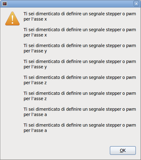

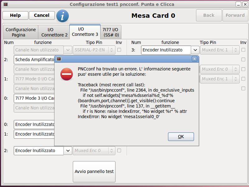

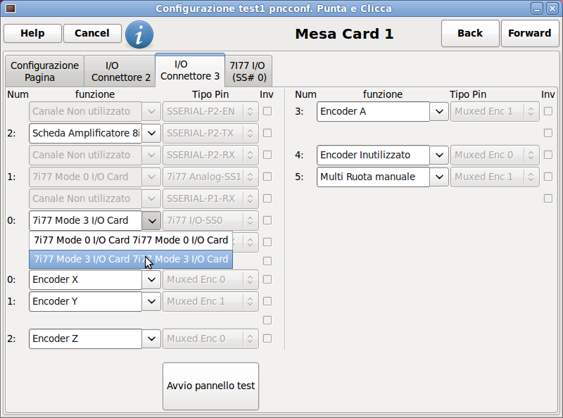

1- if try to use 5i25-internal with 7i77 one 7i77 obtain this result:
(ss0 error)
I try to use as PCW suggest 5i25-internal with 7i77x2 obtain this result:
2- IS RIGHT MY CHECK IN MESA CECK BOX SELECTION AND PARPORT?
3- obtain the selection of 7i77 mode but only 0 and 3 (in manual there are description for 0-1-2 mode ... nothing about 3 mode)
4-at the last I not see section for select DRV connector but only encoder and digital input and output and if I try to advance in configurtation obtain these result:
(You not remember to select PWM or step signal for .... axes) and the configuration can only abort.

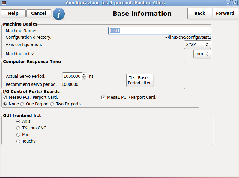

At these point I try to download from mesa site the 5i25 software .... i try to copy with sudo nautilus 5i25_7i77x2.bit 5i25_7i77x2.xml and 5i25_7i77x2.pin to new folder 5i25 in .........firmware/hm2/ ..... I try to use pnconfig but not obtain possibility to see PWM xxx axis configuration pin ...
At these point I must control that I knows on 7i77 and 5i25:
1-on pncconfig tb2 connector is 5i25 internal connector, and tb3 is external DB25 connector. Is Right?
2-in my case on TB3 panel I can select 6 encoder that I can fount during the wiring on 7i77 named on TB3 and TB4 as encoder0, encoder1...etc
3-in my case (encoder feedback and analogue command) I need 6 analogue output .... but these who are? On TB5 connector on 7i77 I hope, and named DRV0, DRV1 ... etc these selection not see at all on pncconfig panel.... no panel named TB5 or similar with new linuxcnc 2.7 release and 5i25-internal firmaware or firmaware downloaded from mesa site....
4-with selection on TB3 panel on pncconfig if select 7i77 mode 0, 1, 2, 3?? I can see (over ss0 in my case) the TB7 and TB8 panel with input output selection (these I can see) ....
Is all right that I knows about 7i77??
Point 3 is normal??
Point 3 is normal??
Last edit: 19 Oct 2015 12:40 by bkt.

see page 4 of the 7i77 manual for connector pinouts tb2 is power
select mesa0 pci
further through the configuration you can select the firmware of the add-on card i.e 7i77x2
this then will populate the smart serial 0 ,1
and give you 2 i/o connector's 2&3 these are the channels preconfigered for servo drives ( tb5 ) & encoders ( tb3 & 4 on the 7i77 .
select smart serial0
you then have 2 tabs for connections to TB8 & TB7 ( gpio pins ) of the 7i77
which give you 16 inputs & 8 outputs per connector
select smart serial 1 this is the servo drive setup ( pwm ) on TB5
select your x axis etc to drive number here i.e drive 0 = Z drive1=y etc
does this help ?
select mesa0 pci
does this help ?
