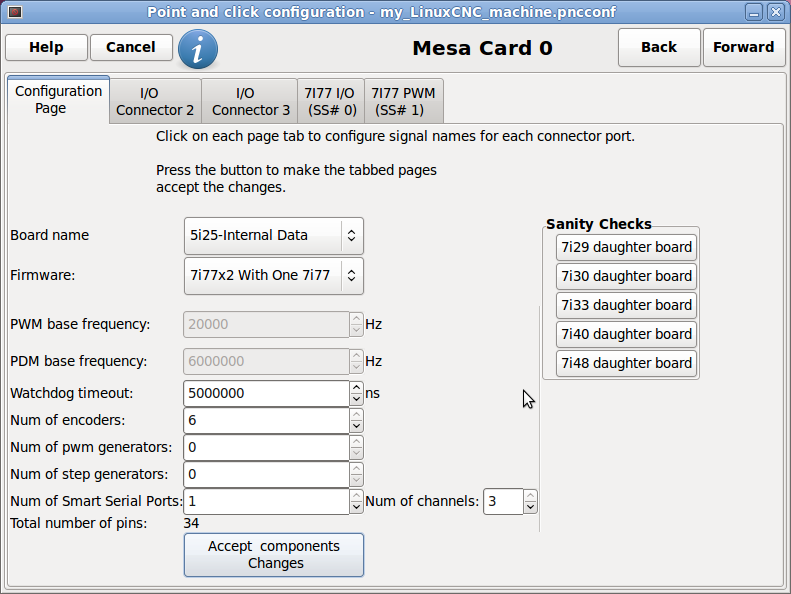

My intent is to realize 5 axis encoder analogue signal ..... at these time I have 32000 max jitter for 2 hour of youtube videos with debian wheezy ..... with ubuntu 10.04 only 17000 ......
I have run 20 time myfirst configuration and some time have a realtime error equal to ubuntu ..... release is not important .... is important new-realtime.
PCW I have already disable audio from bios... fan at standard up .... I try to attach the config if you see anythings to do.
if the solution is change motherboard I accept any suggest
for language question ..... if install debian whit italian support the intallation fal !! If install whit english support is all OK!!

I can confirm a laguage package bug ..... new installation Ubuntu10.04 + linuxcnc2.7 but in english language ....
I can see this time SS0 and SS1 .....
Also can confirm that: debia wheezy + linuxcnc .iso if install with english language I can install without problem ... if choice italian language the installation fail ...
