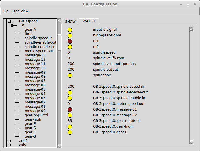

OK, here is a new table and comp file. Can you have look and see if there is any boo boos. Now 10 gears

12 Sep 2018 04:05 #117383
by tecno
Replied by tecno on topic Help needed to get my 7i76E + 7i85S + 7i73 on my mill going.
Some typos edited but I get nothing out to VFD

14 Sep 2018 07:24 - 14 Sep 2018 07:25 #117518
Replied by andypugh on topic Help needed to get my 7i76E + 7i85S + 7i73 on my mill going.
In the screenshot, it is waiting for you to satisfy the conditions specified in message 2 (Gear 33, ie 0x21)
Last edit: 14 Sep 2018 07:25 by andypugh.
- tecno
- Posts: 1850
- Thank you received: 127
14 Sep 2018 07:51 #117524
by tecno
It is fulfilled Gear E =1 + High Gear =32 ===total 33, this is how I read it.
Im sure there must be a typo hidden somewhere but I just seem to find it.

14 Sep 2018 08:12 #117526
by tecno
With above I can only run Gear E 0-100rpm, other gear settings/S commands nothing out to VFD.
S100 = runs at 135rpm
S50 66.5rpm
S10 12rpm
E + High gear 101 - 200rpm
S200 123rpm
S150 92rpm
S101 61rpm
There must be some errors in the comp code, but I cannot figure out what.
S50 66.5rpm
S10 12rpm
S200 123rpm
S150 92rpm
S101 61rpm
