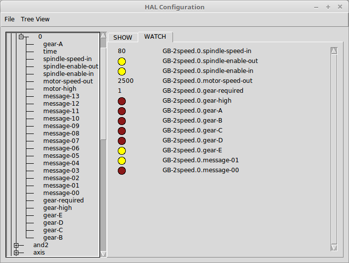

Don't think so.
You should most likely look inside the component how the motor-speed-out is calculated.
Maybe you did that already to end up with the factors here, but you can use the halshow to
show the values of the output pins.
And if there is something wrong in the output pins values, and the right logic with the gears work,
you need to look in the code how the wrong value is calculated. It should be possible to follow,
there aren't too many lines of code.
Can you show a screenshot of halshow with all the input pins and output pins of the component
shown when there is an output that troubles you?

The comp thinks you need gear 1, and you have gear 1 engaged = OK.
The speed table says you can use speed 1 between 0 and 80 (spindle) rpm
and that the motor rpm will be between 0 and 2500 rpm in that range.
There is probably something wrong in the table. What did you expect the
motor output to be - 640? Can gear 1 go as high as 310 (spindle) rpm.
What is really the range for gear 1?
The vfd Hz should be easy to fix, let's work on the comp's output for the time being.

But range of gear 1 should be 80 - 125rpm not 0-80 as I have no use for slower than 80 and that is already pushing the VFD output loading the motor too much.
S80 is gear1 and motor in lowspeed (max 1450rpm on motorshaft geared down via belt drive to max speed of 1250rpm in lowspeed).
Motor should spin about 1077 rpm = 43Hz
I have a small error in ratio numbers as I´ve calculated from max 1000rpm as they should have been calculated from 1250rpm.
But still there is something wrong as the motor spins only at 1.84Hz
Last edit: 07 Sep 2018 09:52 by tecno. Reason: added text

You can change this lineto
That should give motor-out-speed of 1600 because it is based on max-rpm 2500.
As far as I can see, there is no support in the comp for using different max rpm.
You *can* do like this. But it is never good to interfere in someone's line of thought so if
Andy has a better idea then go for that.
1. Add a variable "double motor_max_speed;" where the other variables are declared.
2. Just above the motor_speed_out lineThis should give about 928 rpm on motor. Assuming 125 spindle rpm at 1450 motor rpm.
Halcompile and all that to test again.
For the vfd speed, does it need rpm or rps (minutes vs seconds)?
motor_speed_out = speeds[13] * (spindle_speed_in / speeds[i]); motor_speed_out = speeds[13] * (spindle_speed_in / speeds[i+1]);That should give motor-out-speed of 1600 because it is based on max-rpm 2500.
if (motor_high)
motor_max_speed = 2500;
else
motor_max_speed = 1450;
motor_speed_out = motor_max_speed * (spindle_speed_in / speeds[i+1]);Halcompile and all that to test again.

07 Sep 2018 11:57 #117195
by Hakan
Replied by Hakan on topic Help needed to get my 7i76E + 7i85S + 7i73 on my mill going.
I know, but there is no code to set different max speeds when the pin is high or low.
I added that code.
I added that code.

07 Sep 2018 12:14 #117196
by tecno
So now we have some action but S80 is in fact 110rpm at 32.32Hz. We are getting closer.
S445 runs at 598rpm
Replied by tecno on topic Help needed to get my 7i76E + 7i85S + 7i73 on my mill going.
motor_speed_out = speeds[13] * (spindle_speed_in / speeds[i+1]);So now we have some action but S80 is in fact 110rpm at 32.32Hz. We are getting closer.
S445 runs at 598rpm
