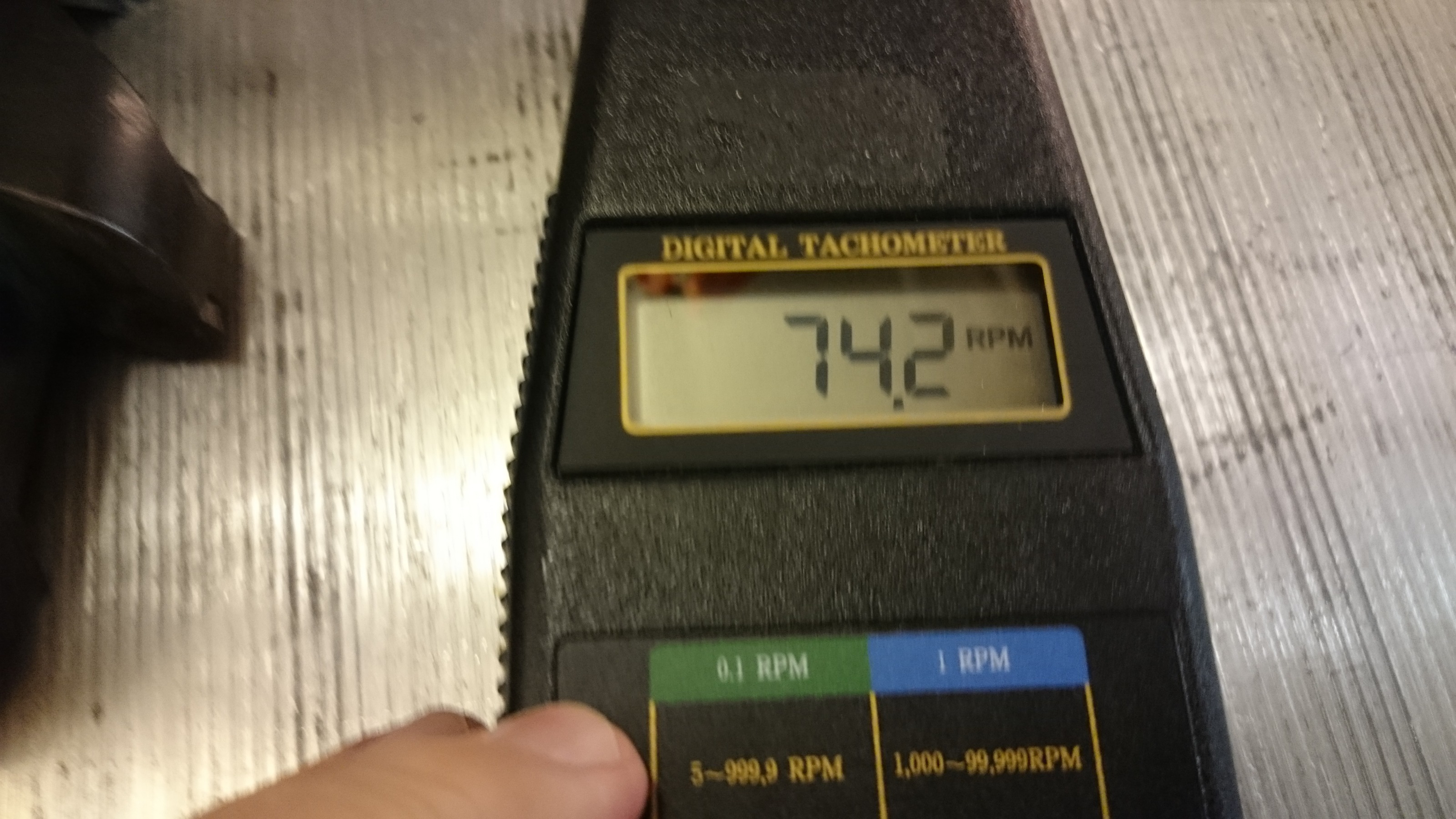

10 Sep 2018 11:00 #117294
by tecno
Replied by tecno on topic Help needed to get my 7i76E + 7i85S + 7i73 on my mill going.
It looks like this with not correct spindle rpm. S160 shows up in gmoccapy as 158 and in reality 74.2rpm
