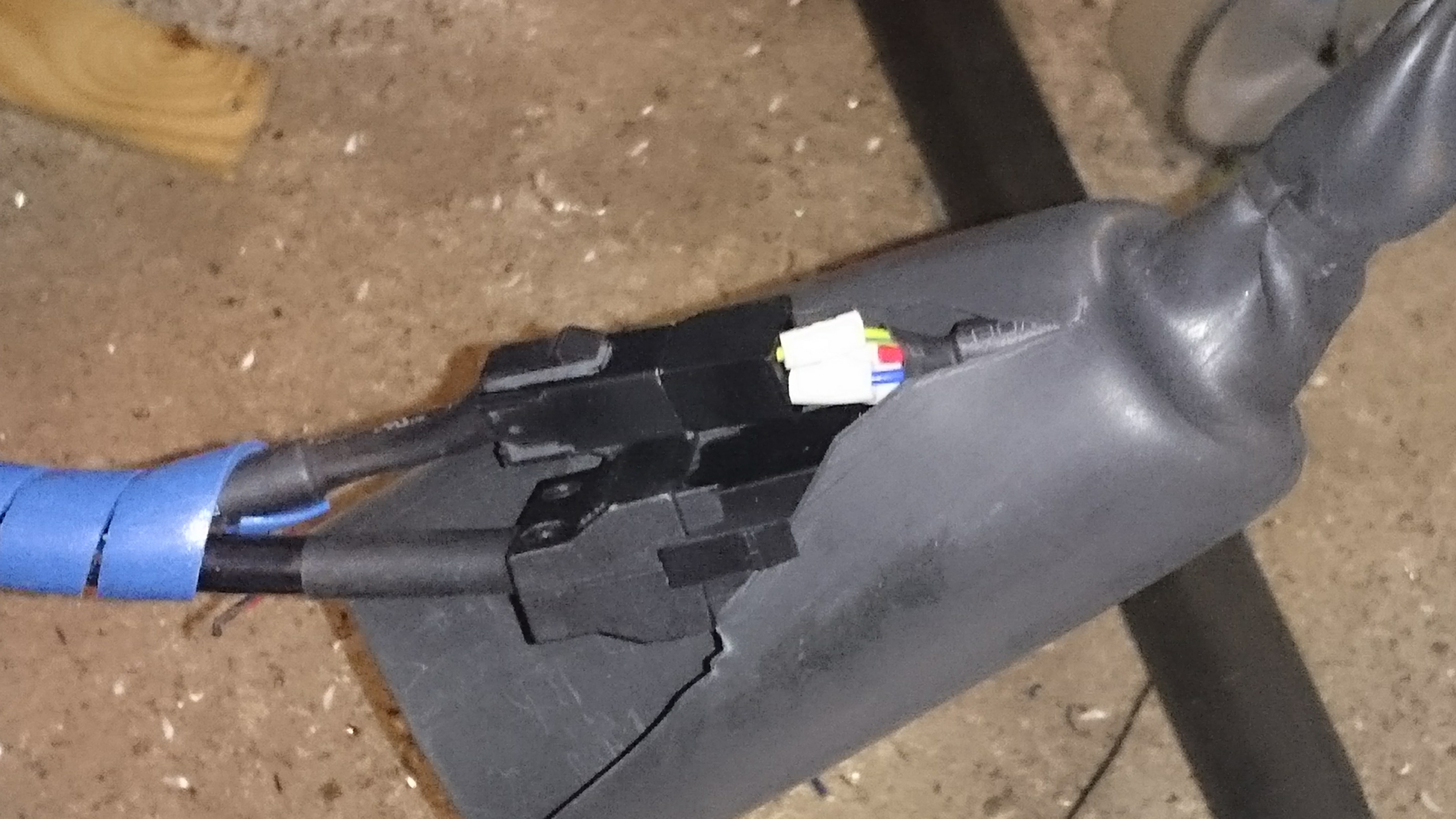

I found the error = SHIT CONNECTORS!!!!!!
From motor there is a fixed cable and ends in 4-pole connector = bad hooks !! So now I have to do something that fixes this this connection SOLID!
Replied by tecno on topic Help needed to get my 7i76E + 7i85S + 7i73 on my mill going.
As a side note, homed all my axis and suddenly X is out of order.
Power on but not stiff as I can rotate shaft by hand = no error message on driver.

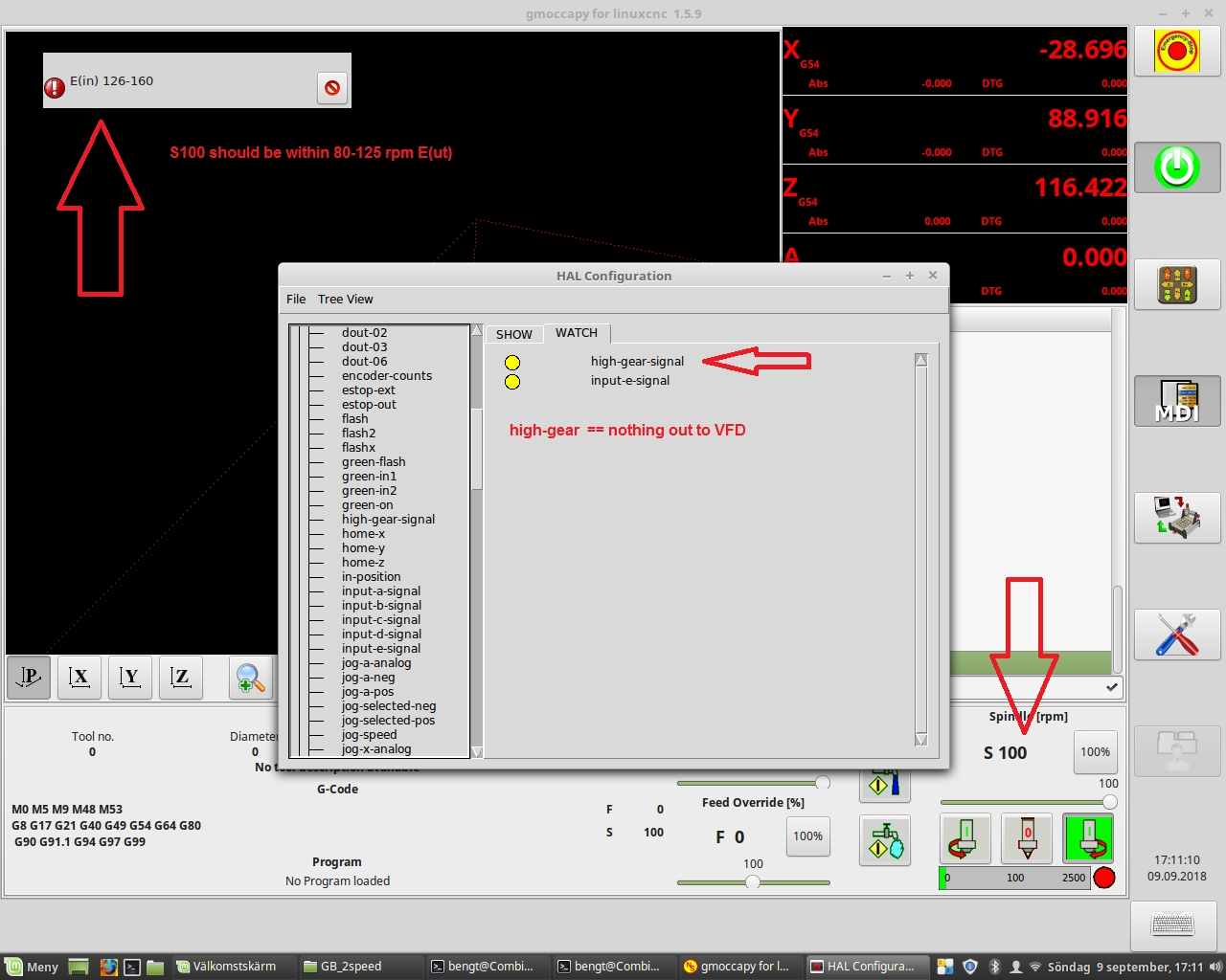

08 Sep 2018 02:40 #117212
by Hakan
Replied by Hakan on topic Help needed to get my 7i76E + 7i85S + 7i73 on my mill going.
Almost, the "speed[13]" on the last line needs to be replaced as well.
Check forum.linuxcnc.org/39-pncconf/33069-help...ing?start=640#117193
If you have a different max speed than 1450 you can just change to whatever is the max speed.

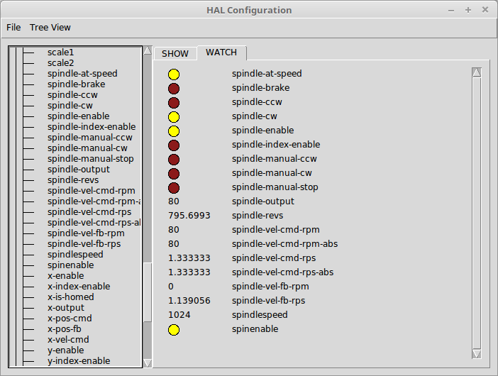

08 Sep 2018 05:05 #117216
by tecno
FUNCTION(_){
int actual, message, motor_max_speed;
deleted word double and now it installs.
S80 now spinning at 63rpm

08 Sep 2018 05:36 - 08 Sep 2018 06:38 #117217
by tecno
Last edit: 08 Sep 2018 06:38 by tecno. Reason: added text
