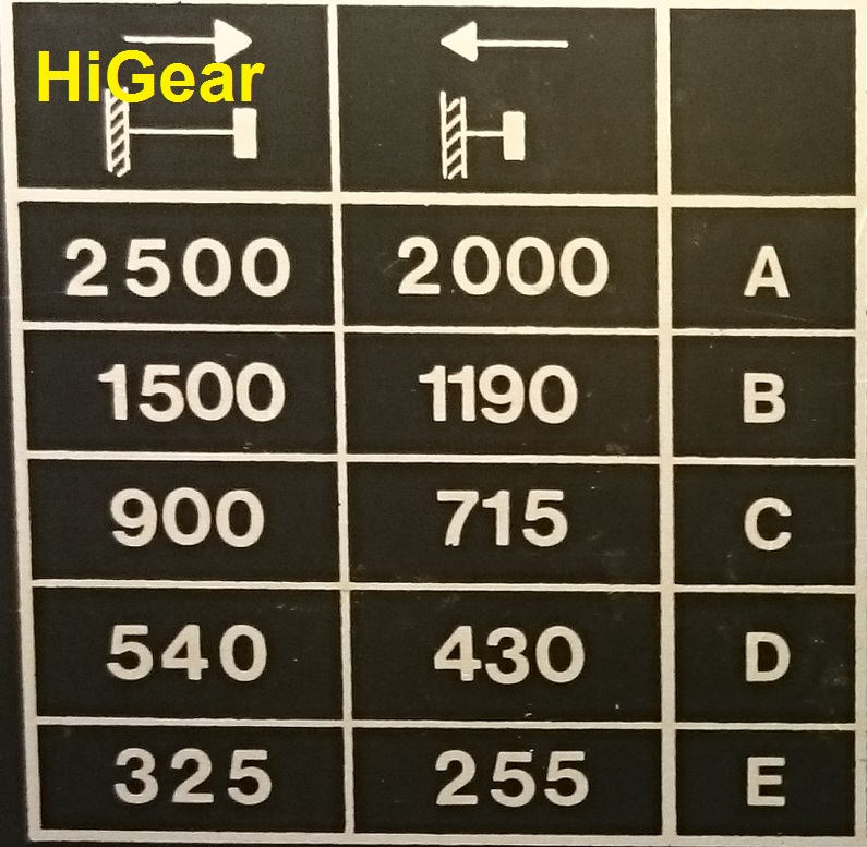

Replied by tecno on topic Help needed to get my 7i76E + 7i85S + 7i73 on my mill going.
I have just edited the comp with new ranges as per the enclosed picture = original gearbox speed and see what the actual result will be.
I´ll be back soon.
I´ll be back soon.

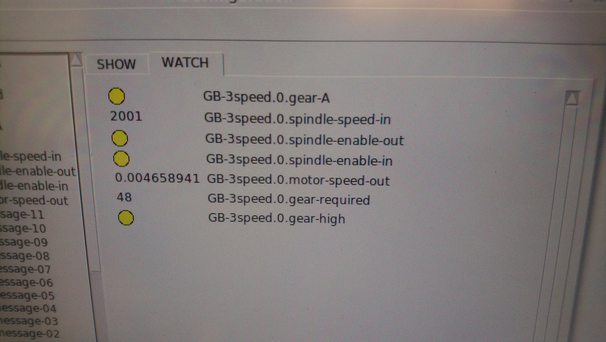

16 Sep 2018 05:10 - 16 Sep 2018 05:26 #117601
by tecno
Oops to fast to rule out the comp.
Gear required 48 is there but nothing on output so there must be something else wrong in comp.

18 Sep 2018 04:34 #117702
by tecno
I have now solved the puzzle and the comp works
Error was on this linesetp hm2_7i76e.0.7i76.0.0.spinout-scalemax adjusted accordingly and now set to 2585 and it is pretty much spot on at 500rpm.
Slightly nonlinear upwards but within acceptable tolerance.
Thanks for all the help to get this part of my milling machine project working.
motor_speed_out = speeds[10] * (spindle_speed_in / speeds[i+1]);
correct line
motor_speed_out = speeds[10] * (spindle_speed_in / speeds[i]);Slightly nonlinear upwards but within acceptable tolerance.
