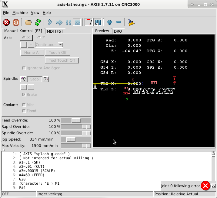

Time to setup my lathe with 7i76e
- Posts: 18122
- Thank you received: 5337
24 Dec 2017 11:39 #103558
Replied by PCW on topic Time to setup my lathe with 7i76e - Need help!
Set the error limits wider?
- tecno
- Posts: 1850
- Thank you received: 127
24 Dec 2017 11:42 #103559
by tecno
Replied by tecno on topic Time to setup my lathe with 7i76e - Need help!
Wider? Gain or Zoom?
- Posts: 18122
24 Dec 2017 11:51 #103560
wider ferror limits
- tecno
- Posts: 1850
24 Dec 2017 11:56 #103561
by tecno
AXIS_0]
TYPE = LINEAR
HOME = 0.0
FERROR = 10.0 >>>>>>>>>>>>>> to ?
MIN_FERROR = 1.0 >>>>>>>>>>>>> to ?
TYPE = LINEAR
HOME = 0.0
- Posts: 18122
24 Dec 2017 11:57 #103562
1e9
- tecno
- Posts: 1850
24 Dec 2017 12:01 - 24 Dec 2017 12:02 #103563
by tecno
AXIS_0]
TYPE = LINEAR
HOME = 0.0
FERROR = 1e9 Correct?
What does this change do, will it affect anything else than this following error?
I really appreciate you taking time to help me out here!
TYPE = LINEAR
HOME = 0.0
Last edit: 24 Dec 2017 12:02 by tecno.
- Posts: 18122
24 Dec 2017 12:07 - 24 Dec 2017 12:07 #103564
it will just prevent you for getting following errors regardless of stepgen behaviour
( you could also just set the ferror limts to the machine position limits)

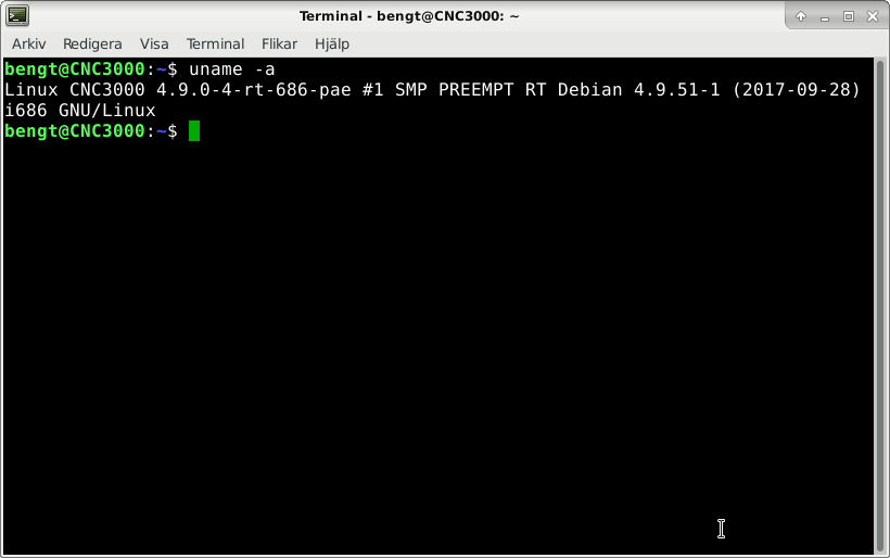

The DPLL plot is so bad it makes me wonder if you are actually running on a real time kernel
What does uname -a print?
Last edit: 24 Dec 2017 12:07 by PCW.

24 Dec 2017 12:17 #103565
by tecno
Will go down and start up the PC again.
Same PC on my milling machine and it works OK, only difference is in Grub as this on my lathe is supposed to be able to go WiFi. It takes ages to boot up so I may have to edit Grub to get rid of this WiFi.
BRB
BRB

- Posts: 18122
24 Dec 2017 13:24 #103567
The following error setting can have no influence on axis smoothness, it only sets the following error limit
( if its exceeded you get the joint following error and a halt )
Did you set both axis 0 limits to 1e9?
If you still got a X following error and both limits are really 1e9 , this mean something very basic is broken
in the PC, FPGA card or installation, because it basically means either the commanded or feedback
stepgen position has wildly out of position numbers
