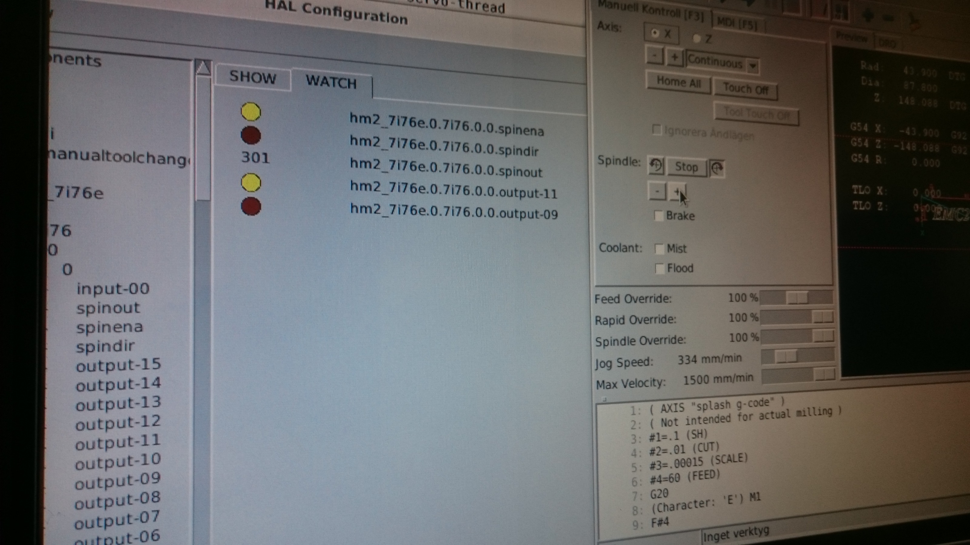

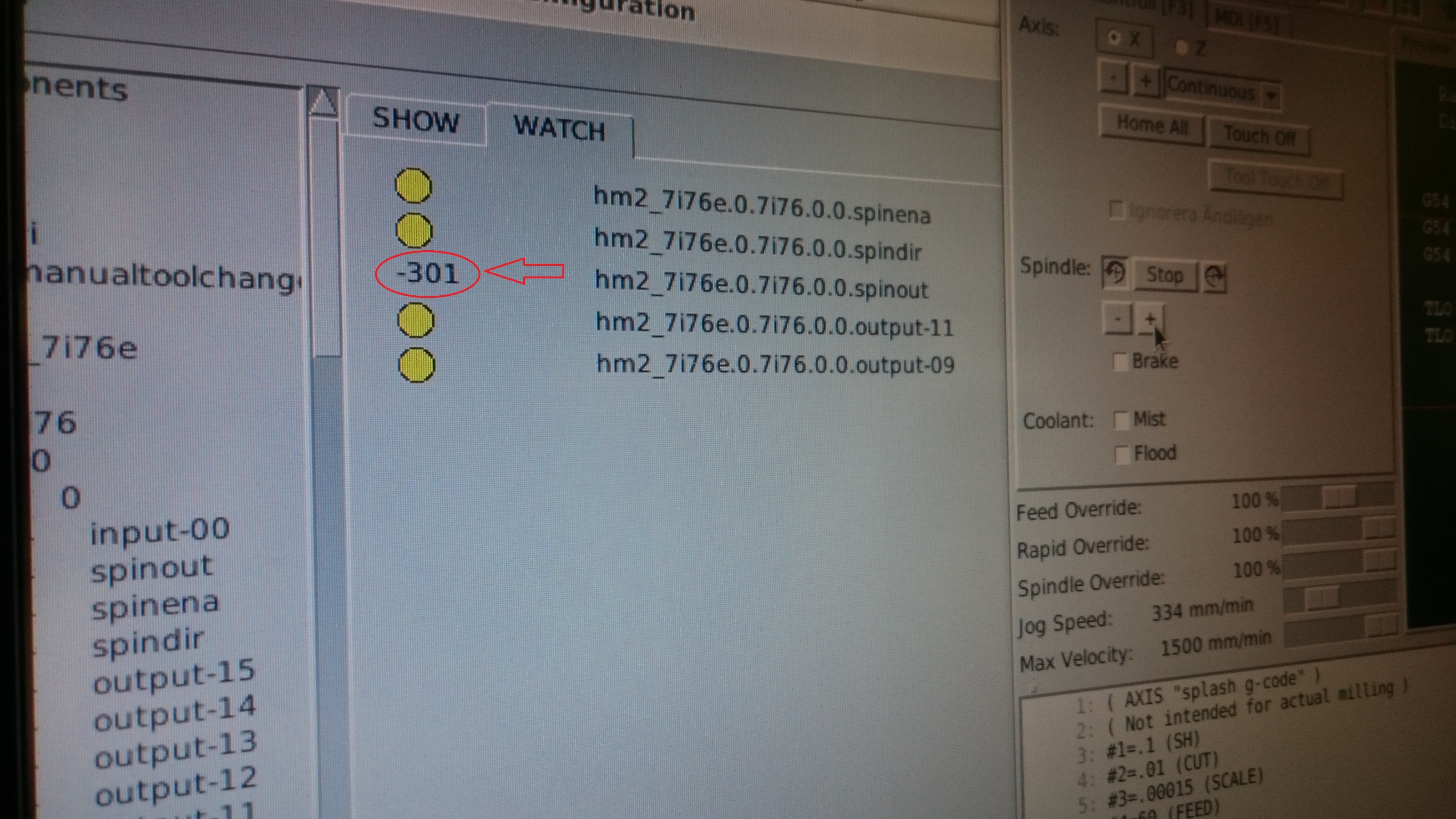

Is is this way to do this?
# --- SPINDLE-ENABLE ---
net spindle-enable hm2_7i76e.0.7i76.0.0.output-06
# --- SPINDLE-DIR ---
net spindle-enable hm2_7i76e.0.7i76.0.0.output-06 => net spindle-dir hm2_7i76e.0.7i76.0.0.output-05

DOH...
Some dinner and a cup of coffee.
Wiring problem at enable to dir relay, the enable was cut as soon as dir relay was enegised.
net spindle-vel-cmd-rpm-abs (abs was missing)
So tomorrow I will turn parts for mounting the new encoder.

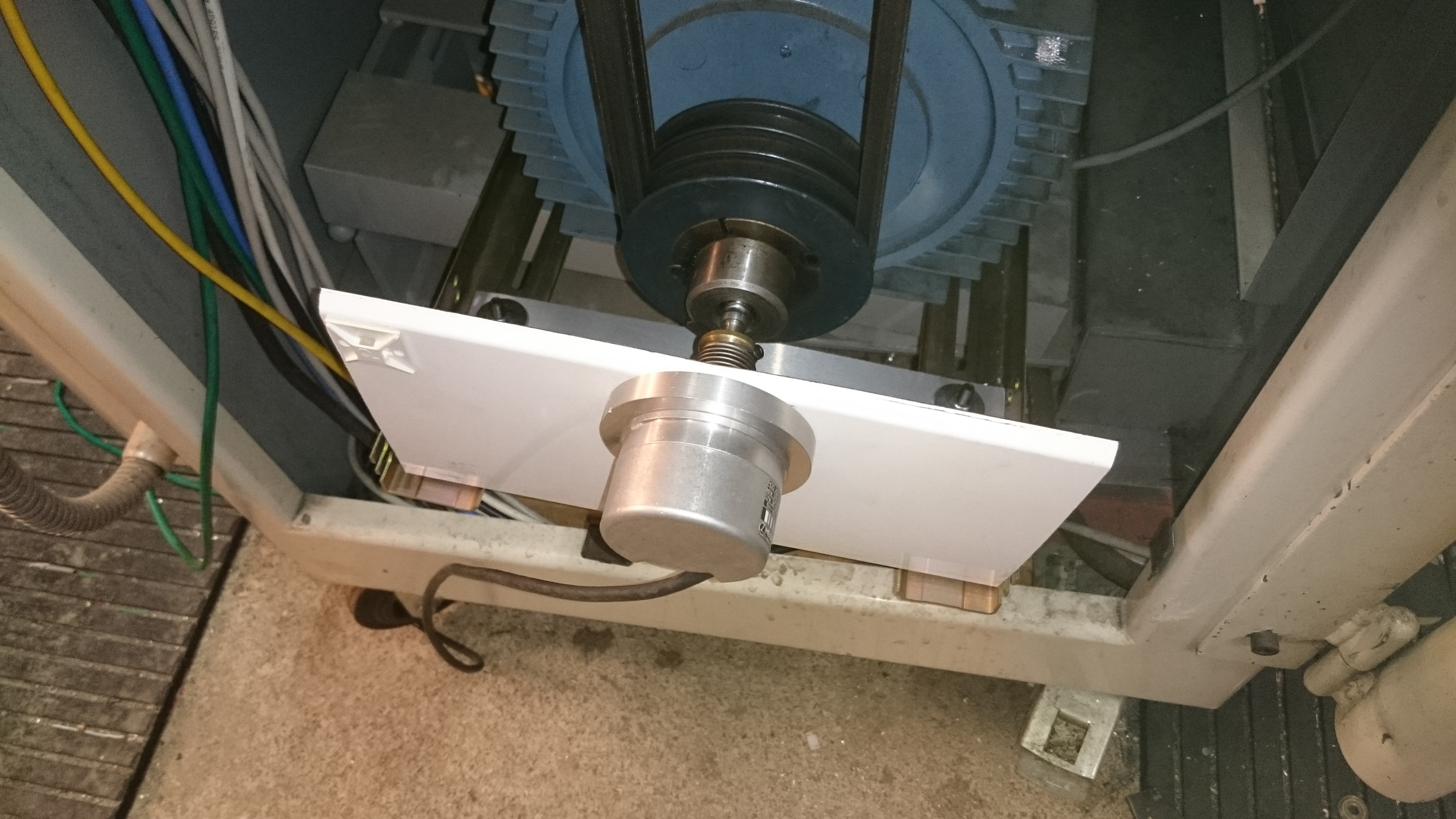

So now I have the encoder mounted on spindle motor (easiest to do and belt-drive is 1:1)
I have the spindle encoder connected to 7i85s W1, W2, W4 UP - ENCODER 2
How do I set this up in hal?
