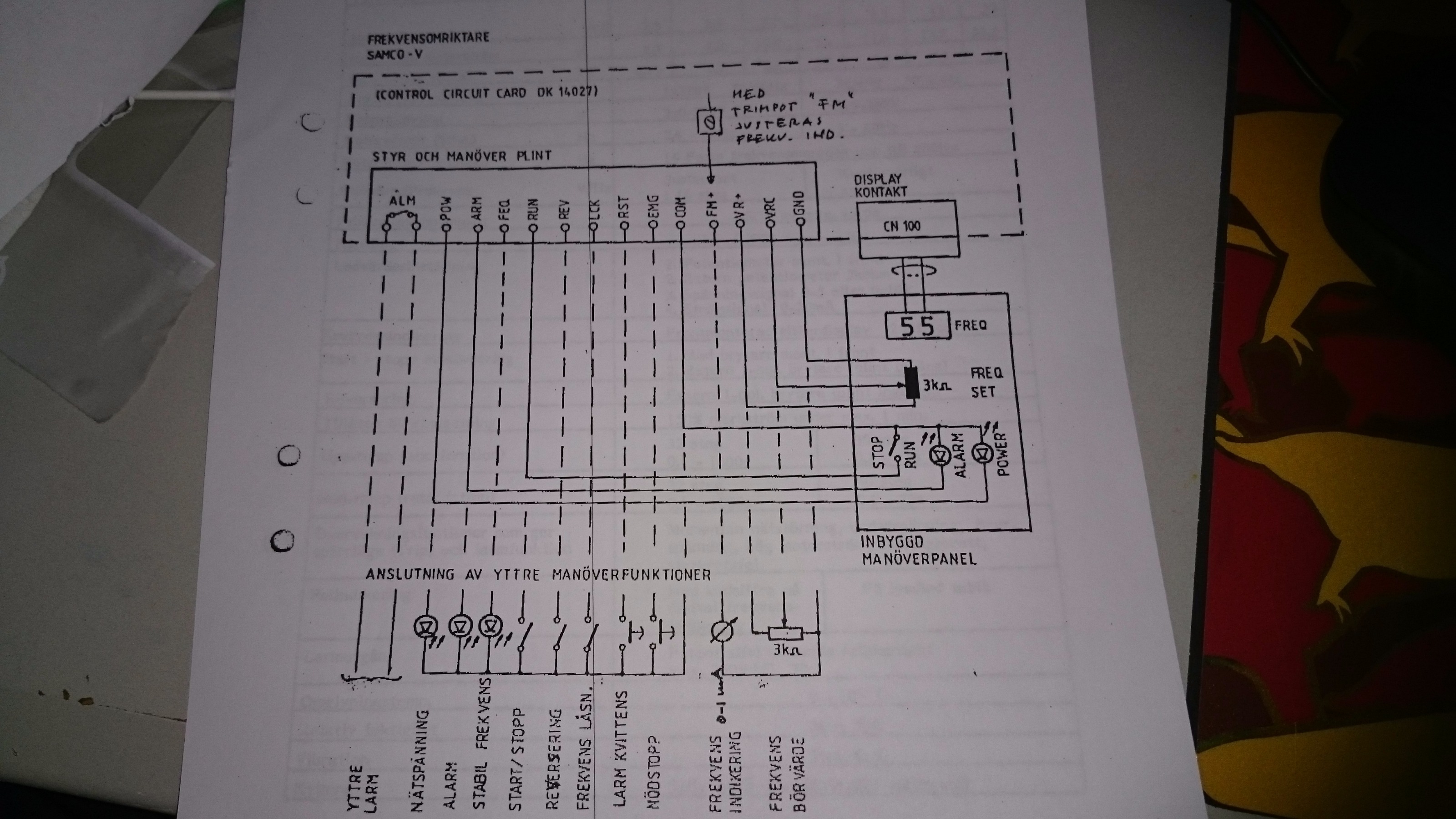

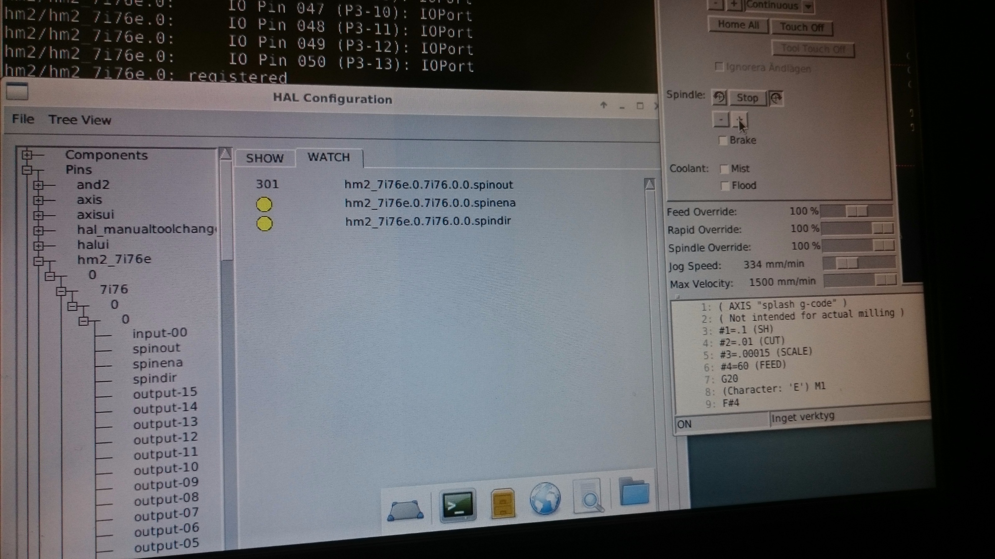

12 Dec 2017 13:50 #103034
by tecno
Replied by tecno on topic Time to setup my lathe with 7i76e
I did test to swap DIR / ENA = no go
So how to connect FWD/REV ?
forum.linuxcnc.org/39-pncconf/33451-time...?limitstart=0#101025
- Posts: 18122
- Thank you received: 5337
12 Dec 2017 14:04 #103035
Replied by PCW on topic Time to setup my lathe with 7i76e
I would first figure out how your VFD works
This does not require LInuxCNC or any hardware other than the VFD and couple of wires
Then if your VFD is setup for FWD/REV, see if it can be setup for DIR/ENABLE (drive manual)
If it is FWD/REV only, the 7I76E requires a external SPDT relay to control VFDs in that mode
- tecno
- Posts: 1850
- Thank you received: 127
12 Dec 2017 14:13 #103037
by tecno
If I recall it correctly there was a relay when running with Mach.
This VFD is mid 70's so to find a manual is not possible. Samco-V SVH

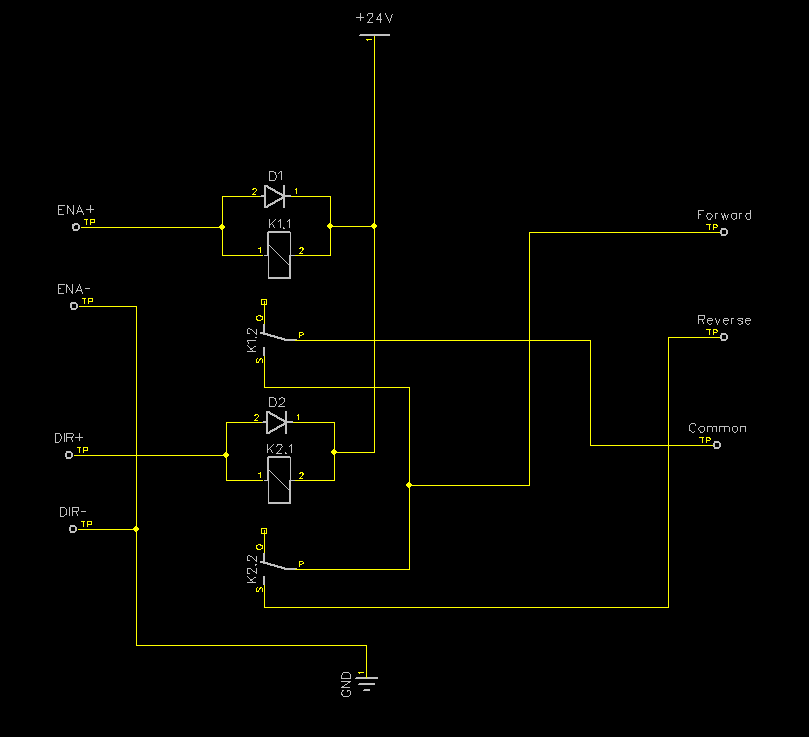

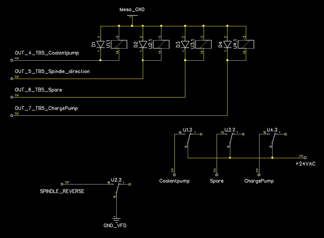

- tecno
- Posts: 1850

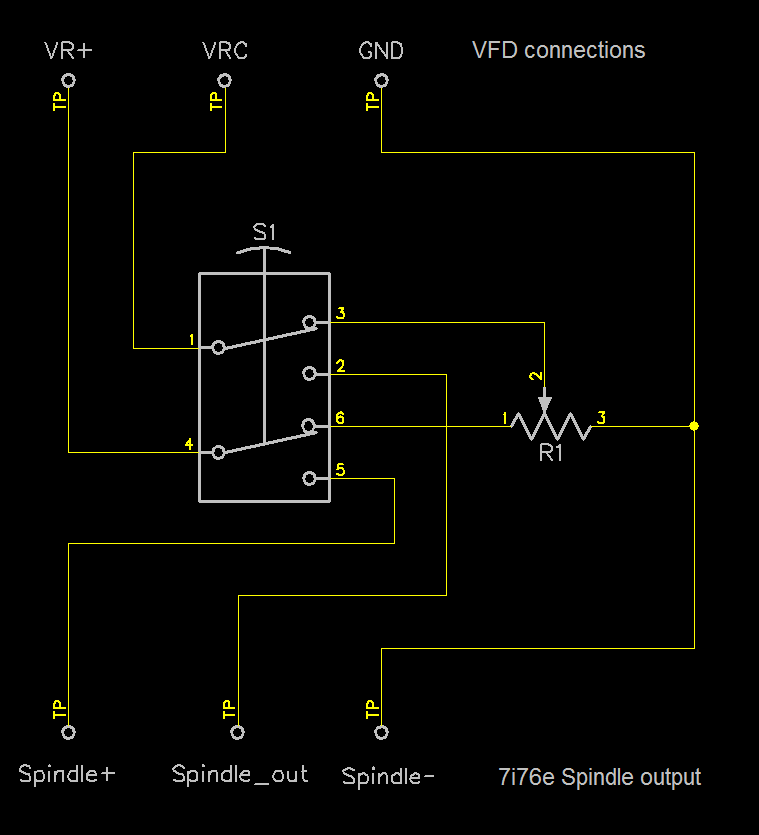

13 Dec 2017 04:11 #103069
by tecno
Something like this and net spindir to Out 5 as in schematic.
Relays are already wired from 7i76e.
I have noticed same problem I had earlier that when driven from PC the spindle rpm is not steady = pulsating occasionally
Did believe that it was the crude PWM to Voltage adapter used with Mach that was bad but obviously not as it is the same
with 7i76e Spindle control.
Solved this when using Mach to use a switch to external potentiometer = only needed when threading to get stable rpm.
I take it that *PC* is bogging down the 5VDC supplied power from VFD. Original pot is 3Kohms

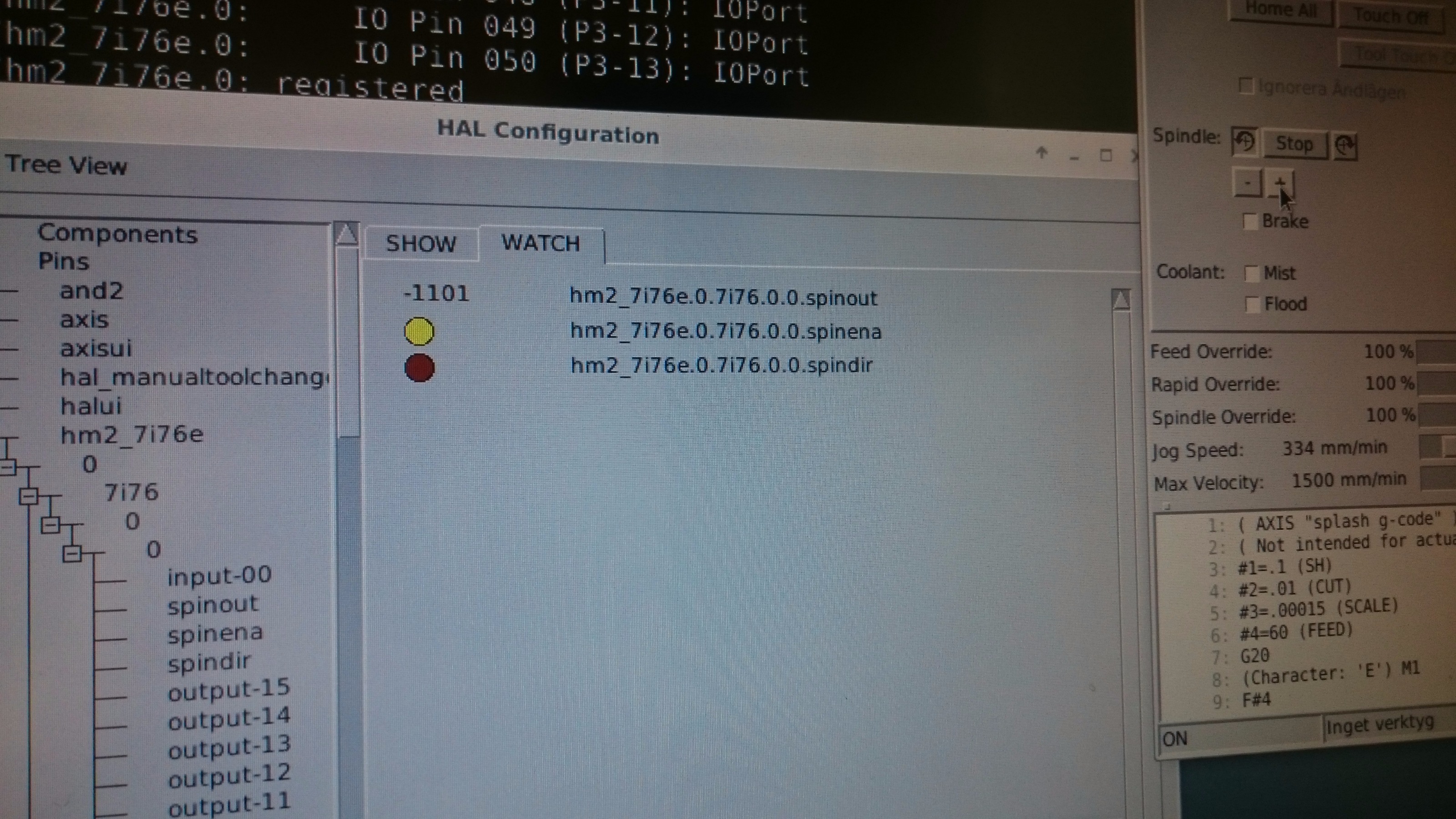

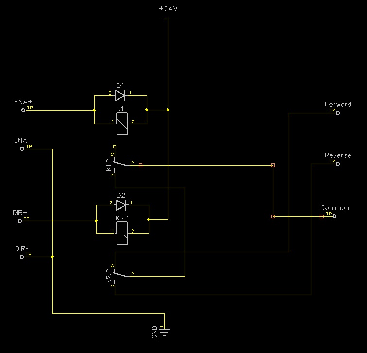

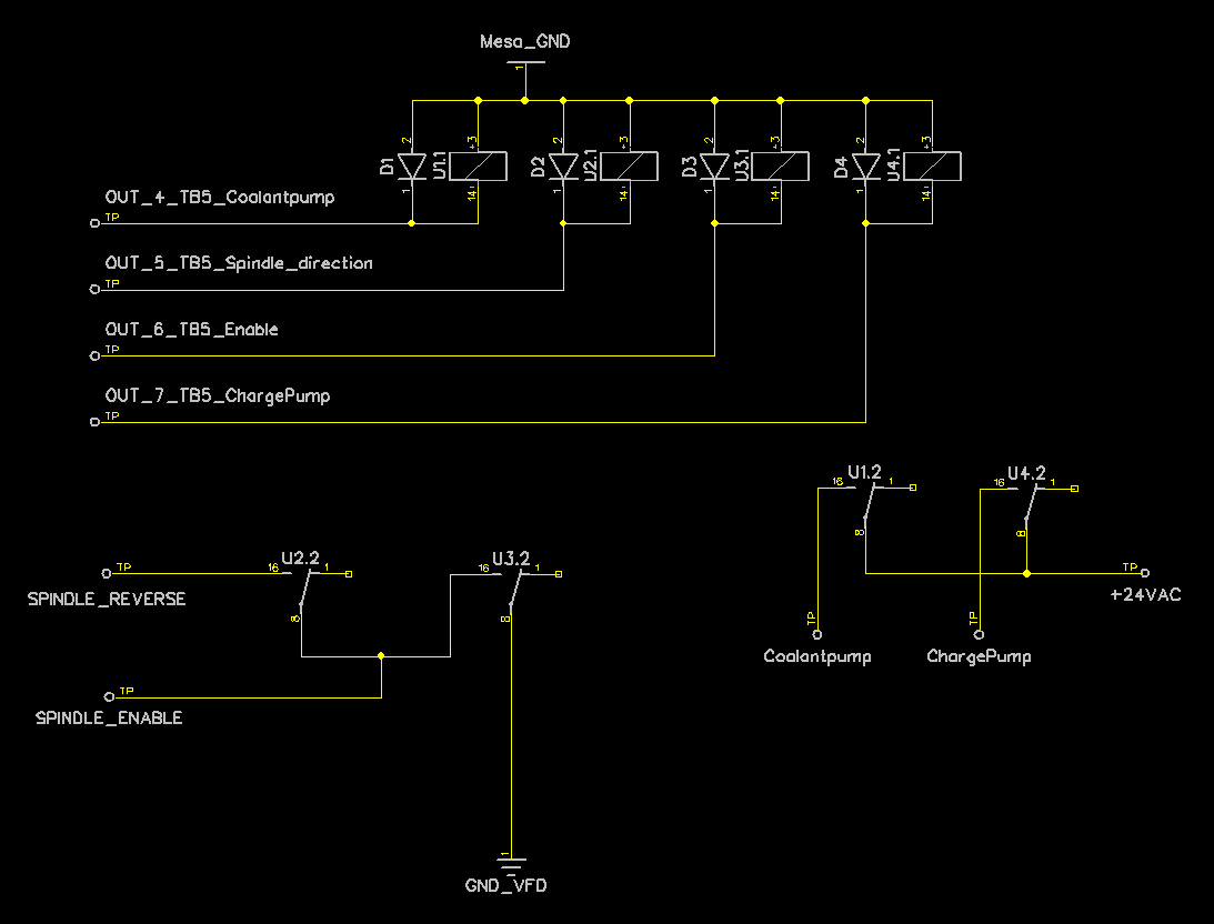

15 Dec 2017 13:17 #103142
by tecno
Replied by tecno on topic Time to setup my lathe with 7i76e - Need help!
So, now I have M3 working, relays connected as above.
net spindle-enable Hm........output-06
net spindle-dir hm.......output-05
But Only forward is working. Relays work OK.
So there must be something wrong in how relay outputs are connected to VFD.
1. Enable from VFD common to Enable(run) must always be connected to either run Forward or Reverse
2. To Revers Common to Revers must be connected
I am too tired to sort this one out, so be kind and help me here.
Cheers
Bengt
