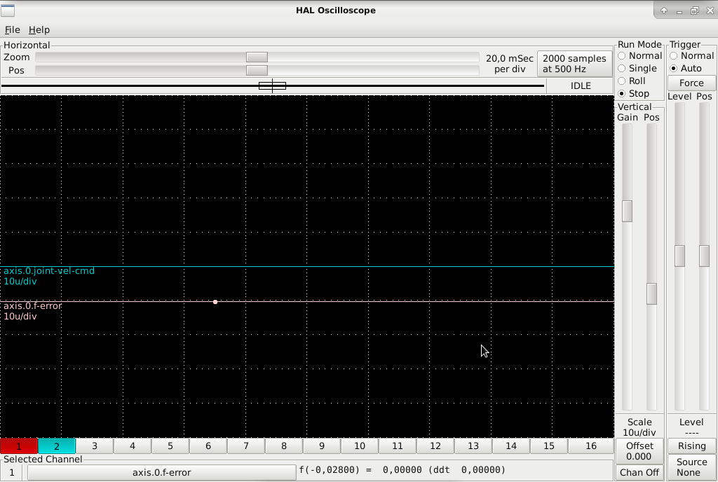

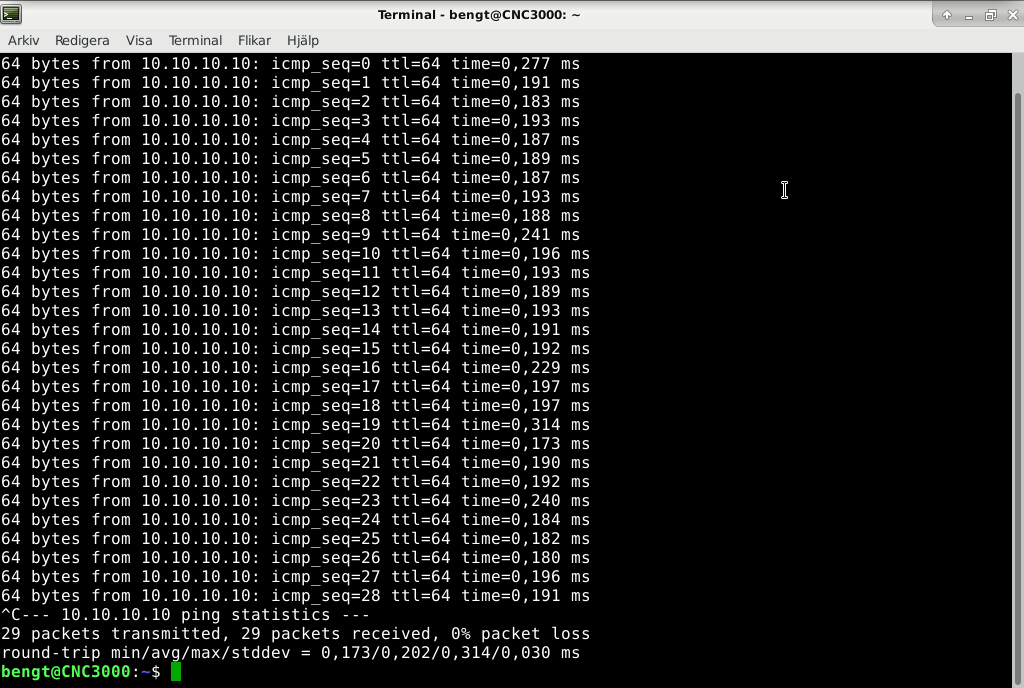

The encoder should have zero effect on the stepgen
The following error limits are set so large that this looks almost like a lost communication issue
perhaps a host PC or noise issue of some kind
Can you post the result of pinging the FPGA card?
Can you halscope the following error?

Ping 10.10.10.10
What pin to halscope?
Ping 10.10.10.10
