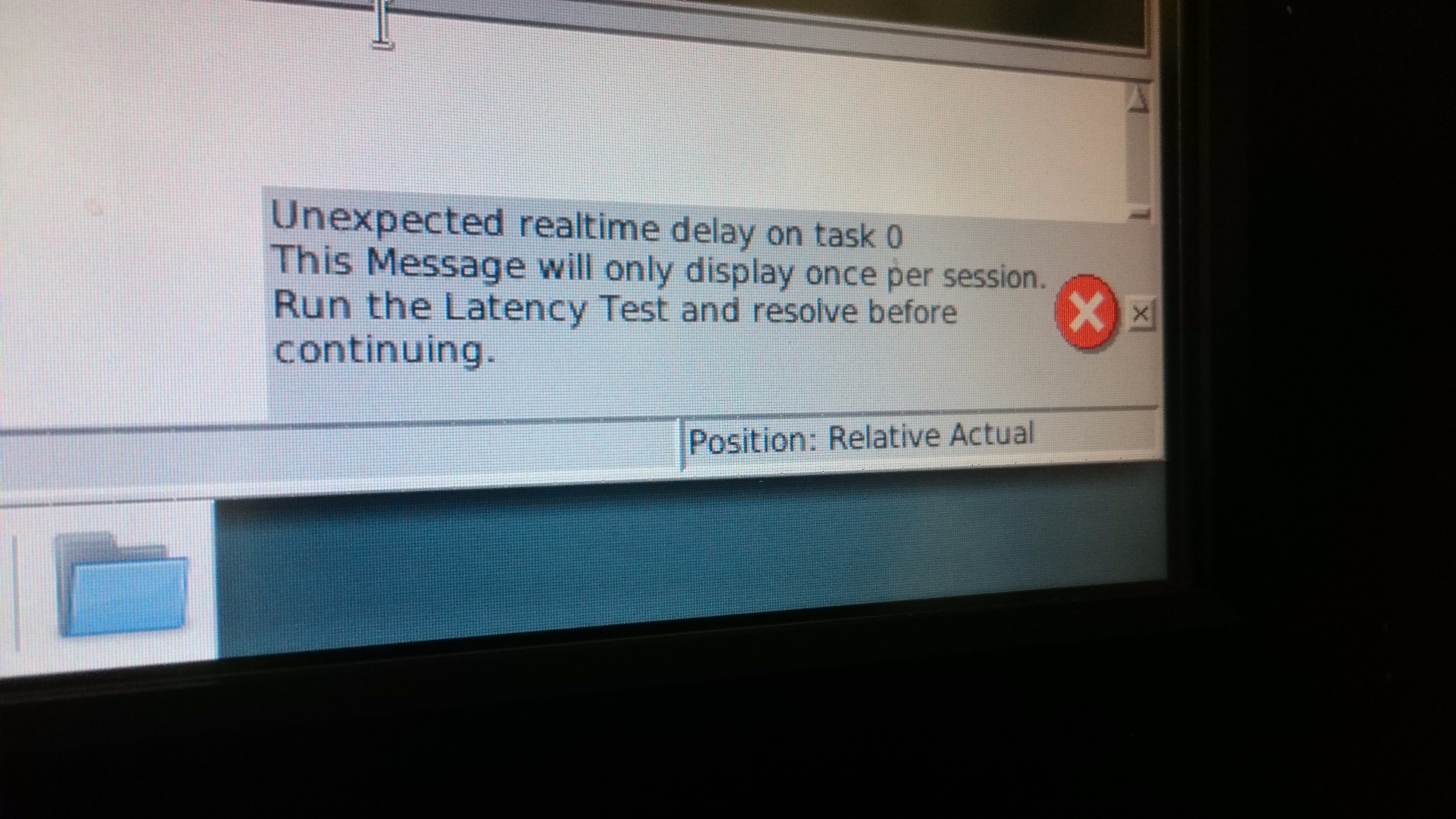

Replied by PCW on topic Time to setup my lathe with 7i76e
Do you get real time error messages from LinuxCNC?
I would check that all power management options are disabled in the BIOS
( disable Cstates > 1 any CPU speed switching or AMD cool an quiet options also )
If you have a Intel mac, disable IRQ coalescing with ethtool

11 Dec 2017 14:37 #102935
by tecno
Replied by tecno on topic Time to setup my lathe with 7i76e
www.jetwaycomputer.com/NC91.html
I do believe that this box is setup the same way as the one in my milling machine,
Above message popped up during running of the pawn.
Right so that means its is not meeting its (1 KHz ?) servo thread deadlines
If LinuxCNC works without error on an identical system I would suspect that the BIOS options or perhaps the
grub options are not the same. If nothing else works I would slow the servo thread down to say 500 Hz

11 Dec 2017 15:09 #102938
by tecno
[EMCMOT]
EMCMOT = motmod
COMM_TIMEOUT = 1.0
COMM_WAIT = 0.010
SERVO_PERIOD = 1000000
Is it here to change the numbers?
EMCMOT = motmod
COMM_TIMEOUT = 1.0
COMM_WAIT = 0.010
Yes for 500 Hz servo thread you would have:
SERVO_PERIOD = 2000000
If you have very bad Ethernet latency you may also need to change the DPLL settings so the
blah-blah-bla dpll.01.timer-us is set to -200 or so usec instead of the default -50 or -100

11 Dec 2017 15:32 #102940
by tecno
Hmmmm Ethernet.... Just realized that there is one big difference on these boxes as I wanted to have USB WiFi to work!
forum.linuxcnc.org/pathpilot/33493-relia...wifi?start=50#101431 and so on....
Maybe it is this that is the trouble, will play some more tomorrow and disable USB WiFi and see if that causes my problems. I can either use WiFi or ETH not both so I need to physically unplug the USB dongle.
I really appreciate your kind help here Peter!
Any hints as regards the VFD? Only M4 and fixed speed working!
WIFI can definitely be an issue for real time though It may be
soluble by running the servo thread slower..
( The disadvantage of running the servo thread slower is larger chord errors during acceleration
but this is not likely to be an issue until you get to quite high accelerations )
Not sure about the VFD, did you post your hal/ini files somewhere?

12 Dec 2017 06:53 #102990
by tecno
Did a test with following
net spindle-enable hm2_7i76e.0.7i76.0.0.spinena
net spindle-vel-cmd-rpm hm2_7i76e.0.7i76.0.0.spinout >>> from -rm-abs
net spindle-cw hm2_7i76e.0.7i76.0.0.spindir >>> from ccw
Only change is that correct button on screen for CW works but still spinning in reverse and fixed speed.

12 Dec 2017 08:40 #103001
I would halmeter the spindle signals involved and simultaneously use a real meter on the 7I76E
spindle interface pins to figure out what's going on...
