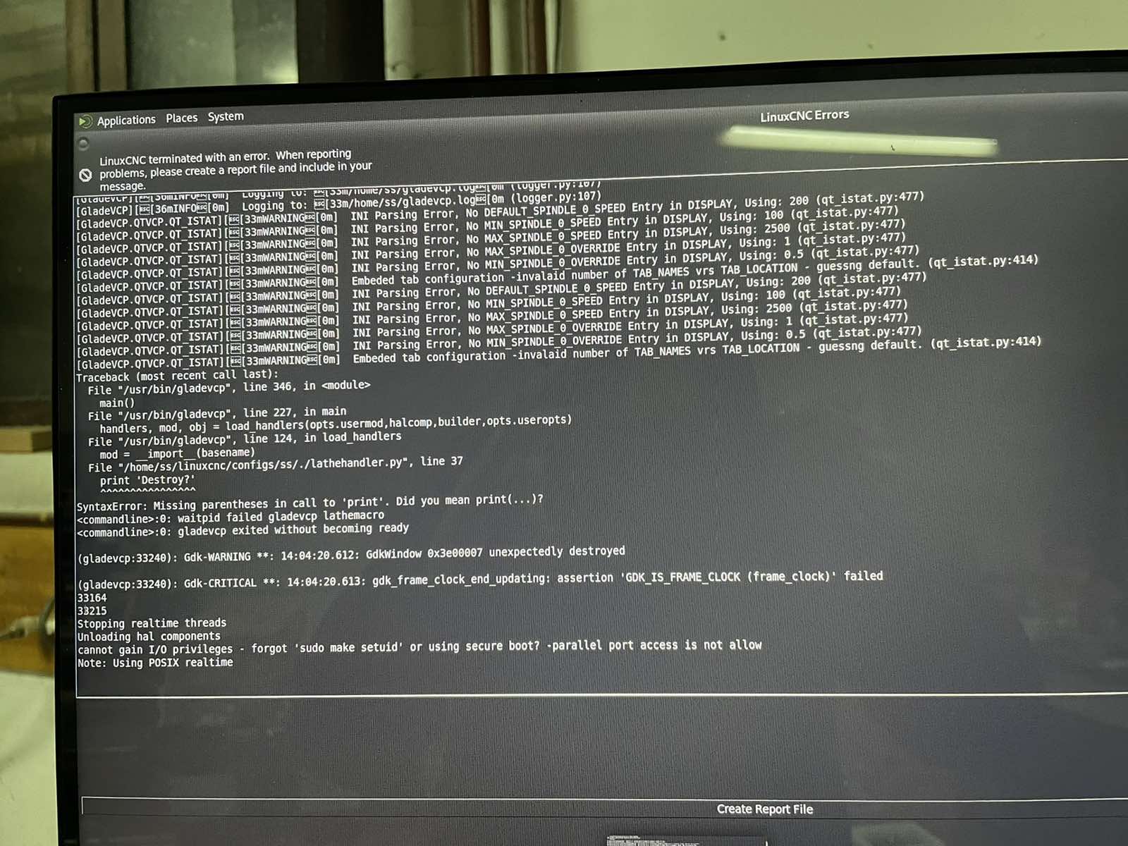

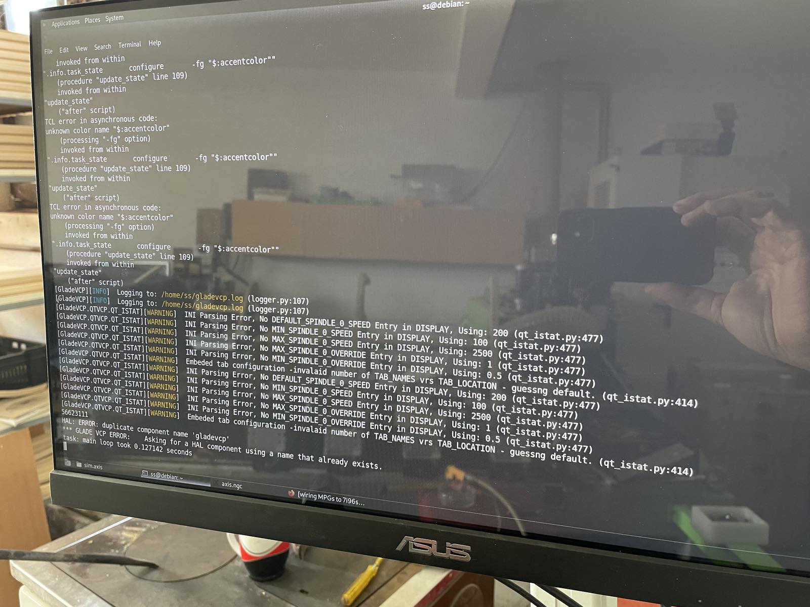

13 Nov 2022 12:03 #256568
by Masiwood123
Replied by Masiwood123 on topic Lathe Macros
13 Nov 2022 16:03 #256581
Replied by andypugh on topic Lathe Macros
OK, you need to change the name of at least one of your GladeVCP panels (In the INI)
See the -Wn option for loadusr:
linuxcnc.org/docs/stable/html/man/man1/halcmd.1.html
So, for example:
So, for example:
EMBED_TAB_COMMAND = halcmd loadusr -Wn lathemacro gladevcp -c lathemacro -U notouch=1 -U norun=0 -u lathehandler.py -x {XID} lathemacro.ui

13 Nov 2022 17:44 #256586
by Masiwood123
sorry but i am stupid with this commands, and cant understand;)
this is the last good config i can open without errors but cycles`` is also blank screen
please modify and back. Thank you
13 Nov 2022 17:48 #256587
Try this INI

13 Nov 2022 18:20 #256590
I think you must be using the old version of the macros?
That's a Python2-to-Python3 thing.

13 Nov 2022 18:31 - 13 Nov 2022 19:01 #256591
by Masiwood123
I used the version from the first page of the post (latheMacros3.zip) will try to replace files..

13 Nov 2022 19:23 #256597
You shouldn't need to be registered.
I have collected all the versions as .zip files here:
github.com/andypugh/LatheMacros/releases
You should expaned the "Assets" of v3.0 and download the .zip file.
