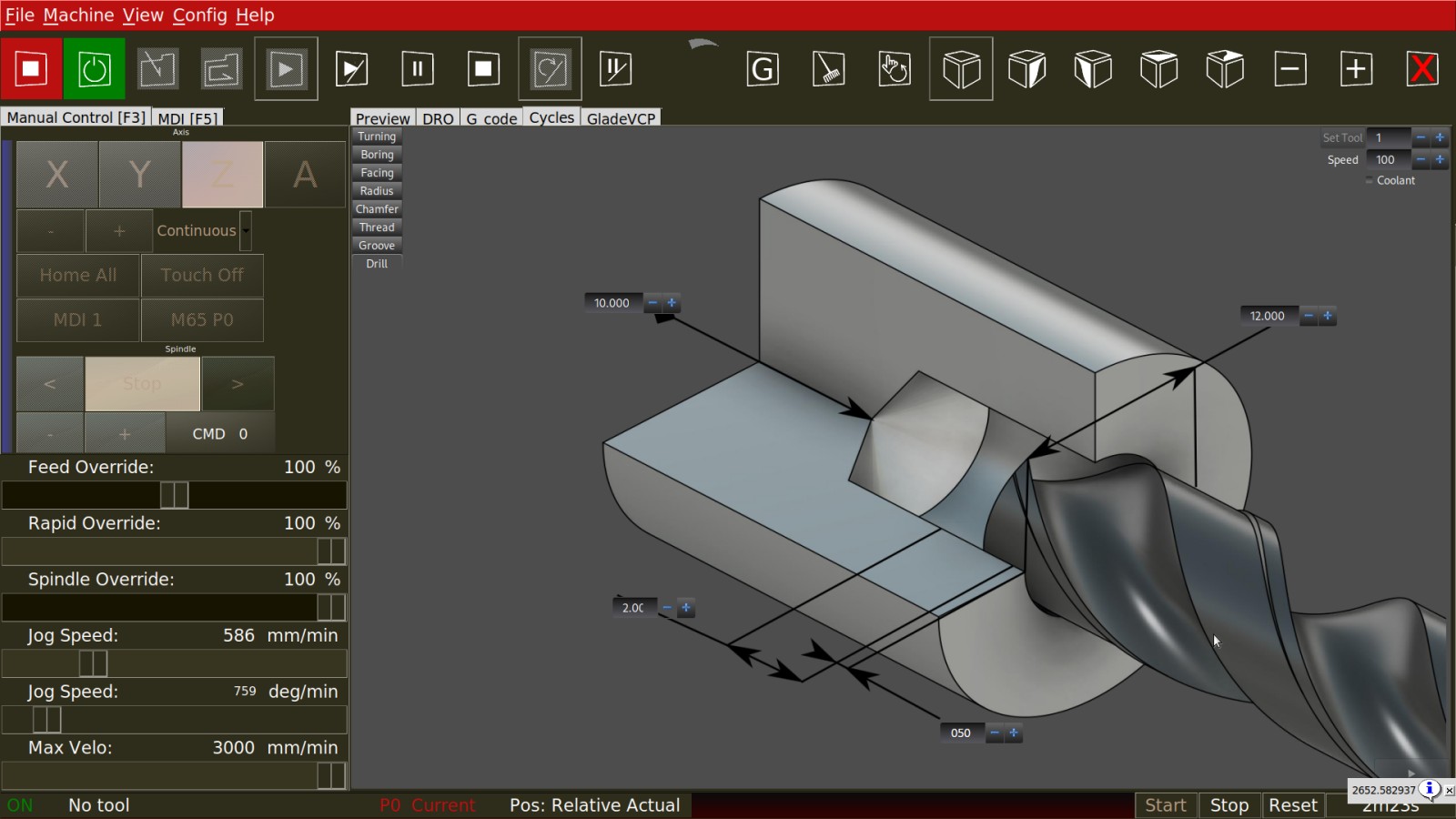

now it works:)) and I really like the interface, unfortunately it won't start the program, it shows in the background that the program is running (and this red line also signals that the gcode is being executed, but the axes don't move) however, I usually edit the start line of the gcode to would the program work or ``run from here'' for some simple program, here I am not able to see the lines of the program.. is there a possibility for linuxcnc to export the gcode through this macro so that I can edit it?

It's all in CSS and feed-per-rev so you need spindle speed feedback or there will be no motion.
Do you have a spindle encoder?
13 Nov 2022 23:04 #256627
Replied by andypugh on topic Lathe Macros
Oh, and 100m/min (the default) is much too fast for a HSS drill, best change that now before it's too late.

ok it's still early, I just tried this without the workpiece, away from the headstock..but the program won't start to execute, i.e. it does something but the axes stand still. on the 7i96s I have an encoder input, but the servo motor connected to the headstock has its own encoder that gives feedback to the driver, so I don't use the one on the card. from the card, I only take the analog output 0-5v to the servo motor driver, the driver also has the possibility of position mode, so I use the head as the A axis, also changing the mode of operation between A and S. there is a DRO on the driver that shows the actual speed of the spindle.. and it is accurate almost in a couple of revolutions. what should I do in order for the macros to work at all?

13 Nov 2022 23:58 #256637
Do you have connections to spindle.0.revs and spindle.0.speed-in?
Check that they show the right numbers with halmeter.

I can check tomorrow on the spot, although I only used the halmeter once to tune the servo motor..this is what I have in Hal as a link. by the way, I only use the spindle in one direction, I think the driver would require a range from -10 to +10v for the reverse M4 (if that is important at all in this case)

14 Nov 2022 00:25 #256646
I don't see anything driving the signals spindle-revs and spindle-vel-fb-rps
Ideally those would be connected to a spindle encoder.
Do you have threading working? I assume not?

in general, everything is still in the final stage of lathe construction, I will use the lathe mainly for some smaller wooden pieces, but since I already have a knife holder on the other side and a slightly stronger motor, I want to perform some basic operations on metal as well(these macros are just ideal for that, because a lot of time is wasted if I had to program everything in solidworks) (I often need some smaller parts of metal) I will also try tomorrow to see if the threading works.. these are good lessons for me to learn, since I didn't know anything, I understand little by little how things fit together:) and thank you very much for your help
