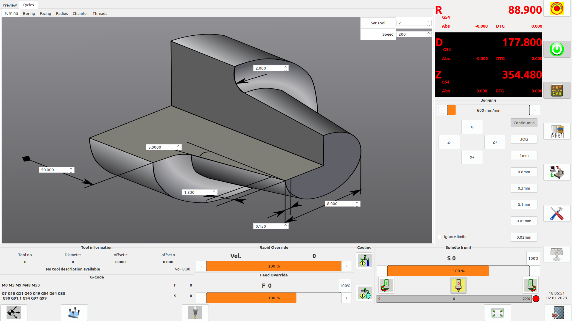

Replied by Muzzer on topic Lathe Macros
Just had another go at updating gmoccapy using the V3.0 files, by pasting the EMBED_TAB_COMMAND line into the HAL file and overwriting the ngc files. I still get the same result:
- No obvious means of generating or running the resulting g code.
- If I click on a scroll box before closing a previous (different) one, the keypad gets lost behind the main window somewhere. I can find it again by using alt-tab to switch windows.
Can anyone see the obvious mistake(s)? I've attached my INI file and a screenshot
02 Jan 2023 19:00 #260784
Replied by andypugh on topic Lathe Macros
Which LinuxCNC version and OS?
It looks like the last-bu-one version of the macros? I have forgotten what it takes to get the run button to show.

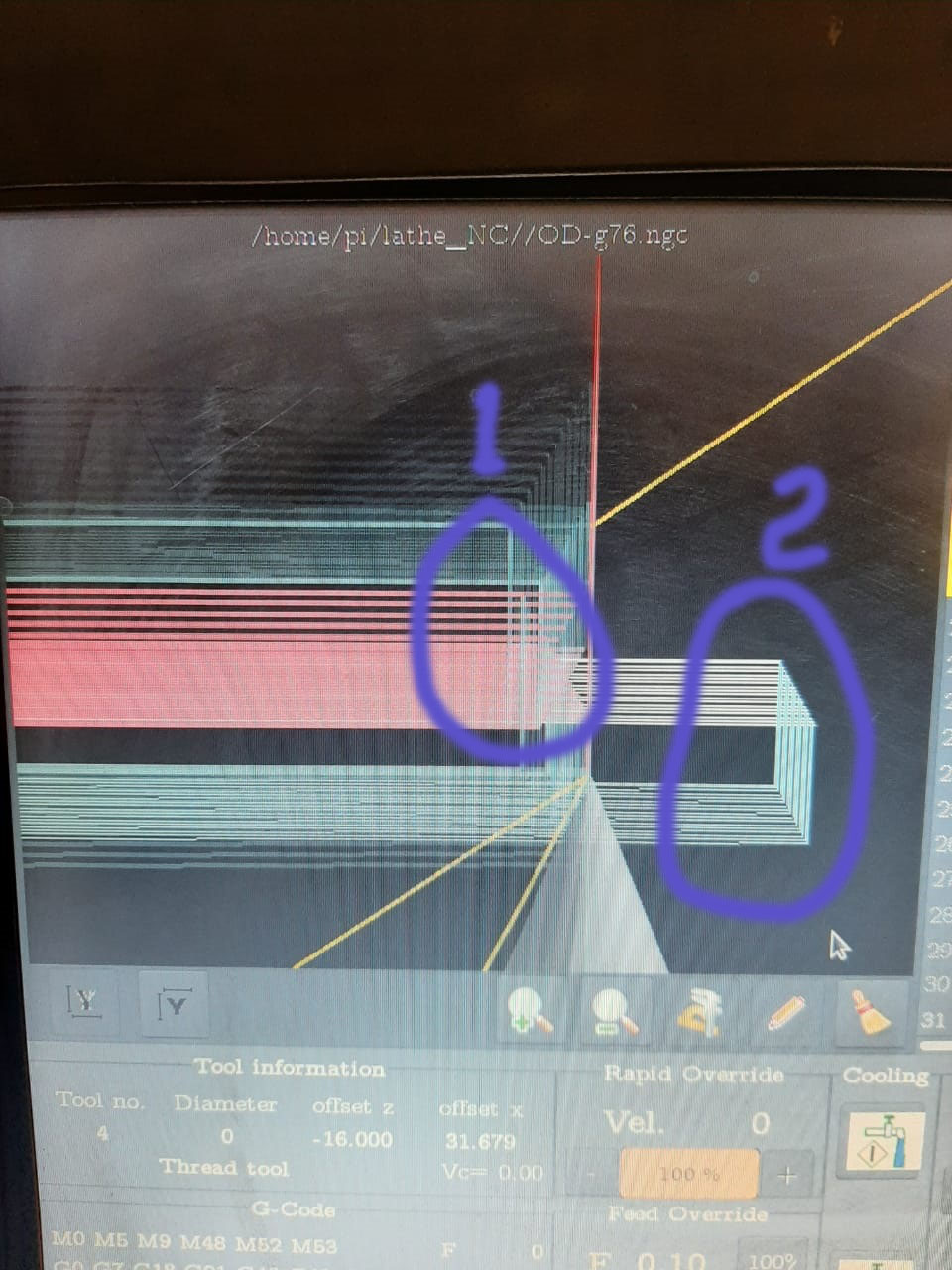

04 Jan 2023 10:42 #260912
by virencq
I am using Lathe macro version 1.
From the picture attached 1 represents threading macro external and internal. Dia 18.5 mm and pitch 2 mm.
Picture 2 represents OD-g76.ngc tool path, it also has same 18.5 mm dia, 2 mm pitch.
both versions have huge differences in depth, what I am doing wrong...........
Replied by virencq on topic Lathe Macros
