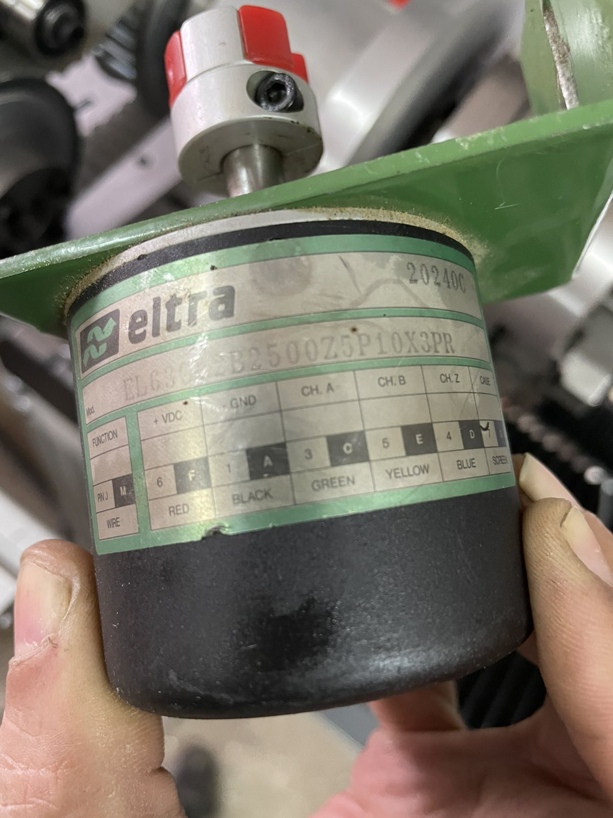

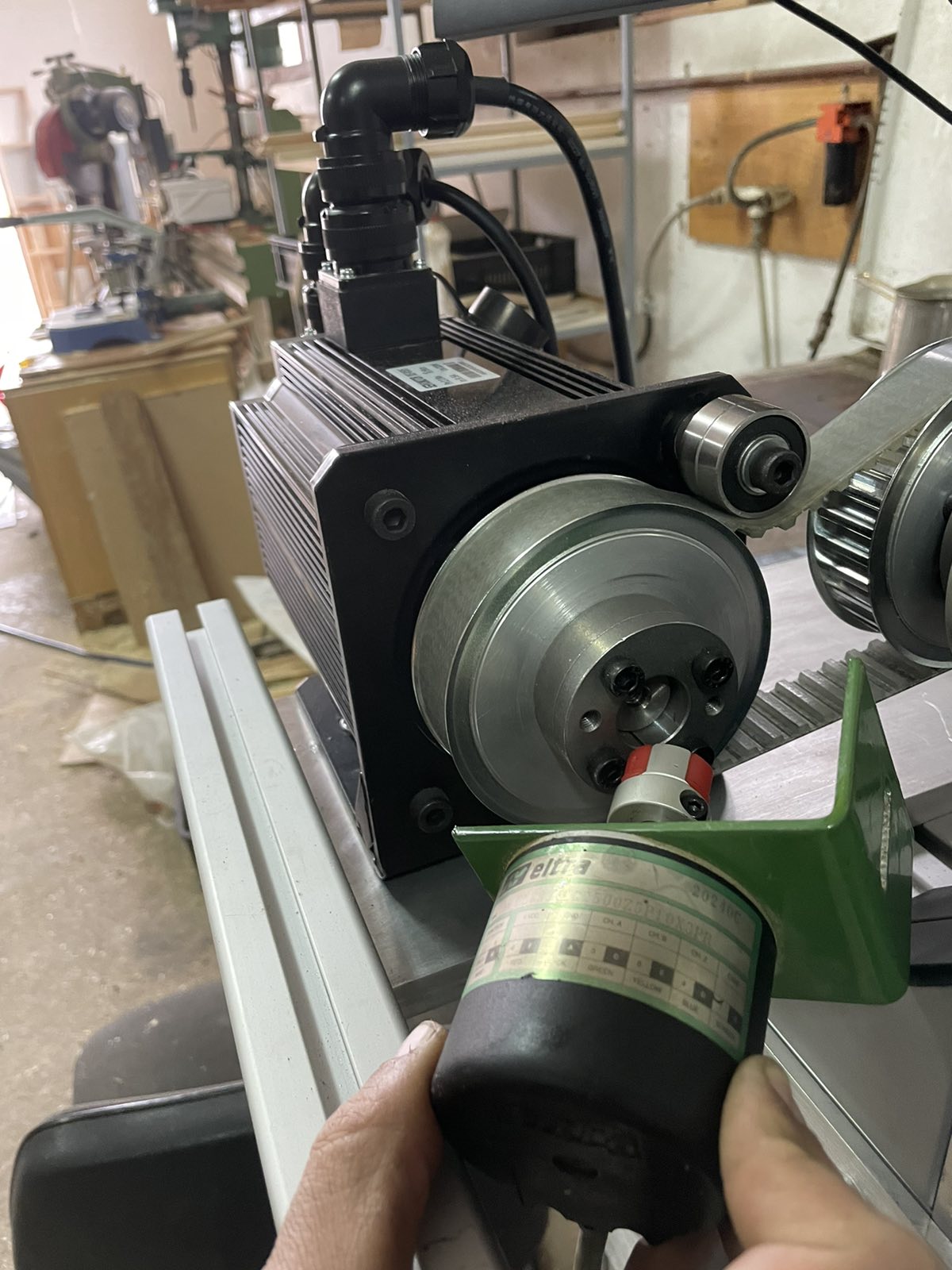

..as I see it, it can't work for me, I should probably connect everything as in the example(linuxcnc.org/docs/html/examples/spindle....#cha:spindle-control), except that I don't have a physical encoder on the head shaft, I only have a closed loop servo with own motor encoder that is connected to the servo motor driver, not to the7i96s card.Now it is difficult for me to install an additional encoder because i primarily made the head to work as an A axis, and the S command only to cut pieces. I am certainly very grateful for the effort and explanations

your ui'' file has nearly 3000 lines, even if I find it, I wouldn't know how to change it... also in routines:) in solidcam I can change feed/rev to feed/min, but that doesn't mean anything to me, in only the A-axis mode, but the macros are also unusable in that case, so I thought that maybe the simplest solution is to insert an additional encoder (in the pictures this one has 2500ppr) which I would physically connect to the card, and programmatically I would again need help from one of you with experience?
16 Nov 2022 12:22 #256849
Replied by andypugh on topic Lathe Macros
Just make the HAL connections that I suggested first. I think that should work.
Then start looking to see if the motor driver outputs quadrature pulses, many do for exactly this sort of situation.
But the HAL connection should work, so give that a try first.
You wouldn't edit the UI file by hand, you can use the Glade editor.
But, again, that shouldn't be necessary.
