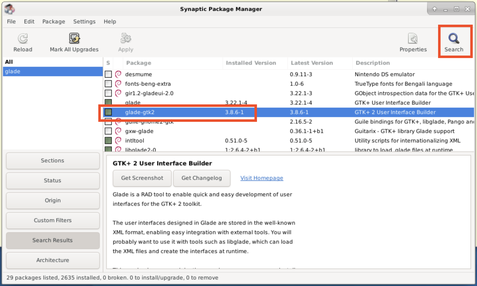

15 Mar 2023 20:08 #266782
by O.R
Replied by O.R on topic Lathe Macros
I have preview, dro and cycles tab's in Axis. I thought that I had Glade installed but, I looked wrong. Is Glade necessary and can something go wrong if it hasn't been installed before?

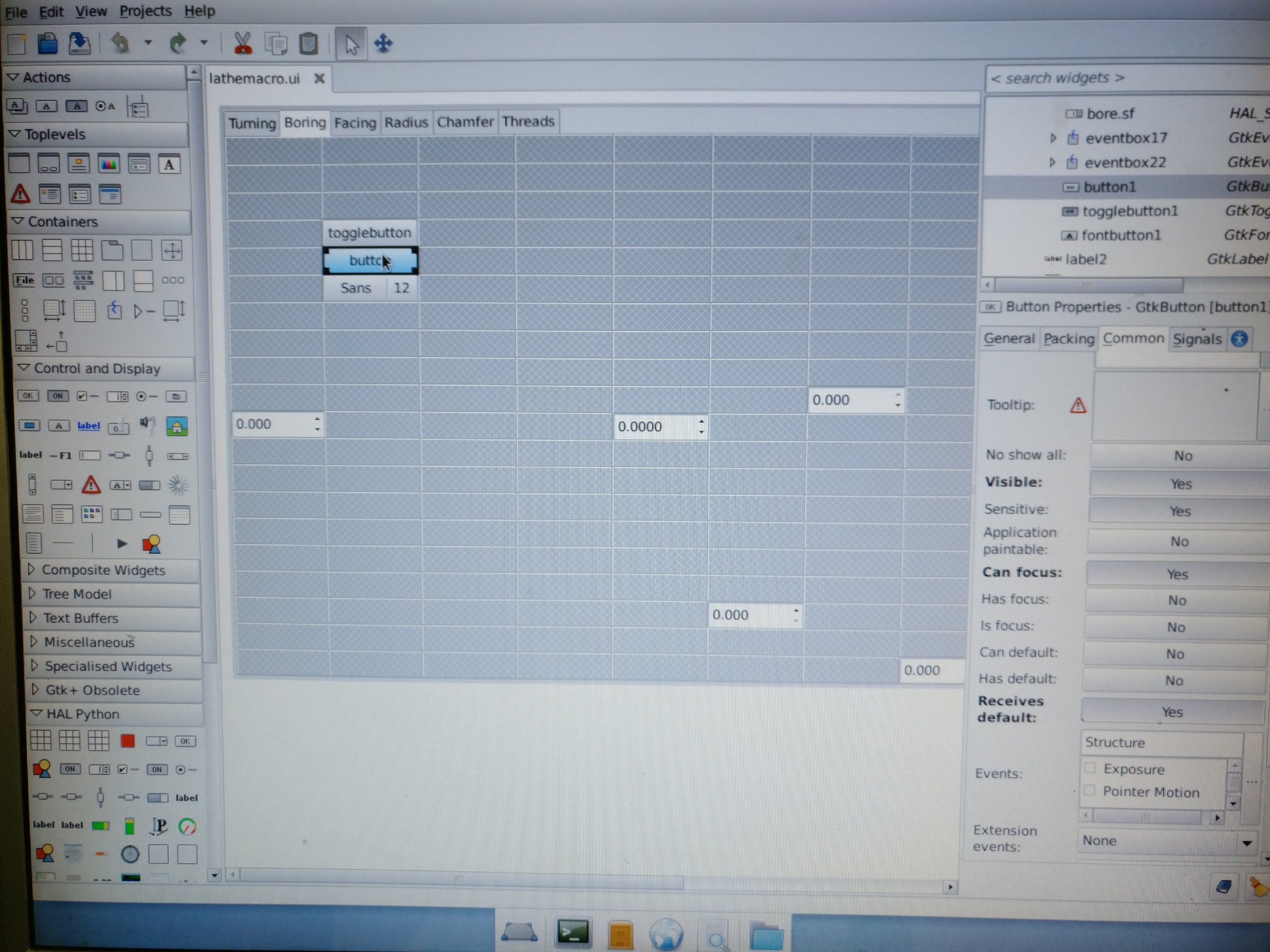

16 Mar 2023 20:07 #266860
by O.R
Ok, now Galde is installed and i can see play button in editor, but can't see that play button in linuxcnc, what I should do next?
17 Mar 2023 00:21 #266870
Replied by andypugh on topic Lathe Macros
I don't know, to be honest. If the button properties are "Visible" and the frame it is in is "Visible" then it should be visible.
I suppose that there is a small chance that your system doesn't actually have the button icon, so you could try changing the button appearance.
Do you see the LinuxCNC widgets in the widgets list on the left?

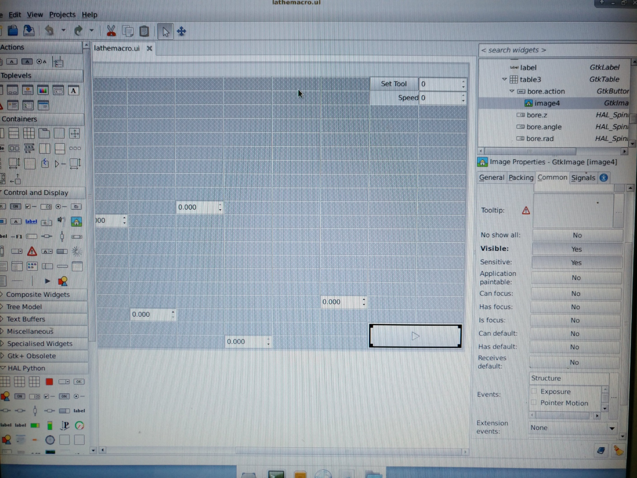

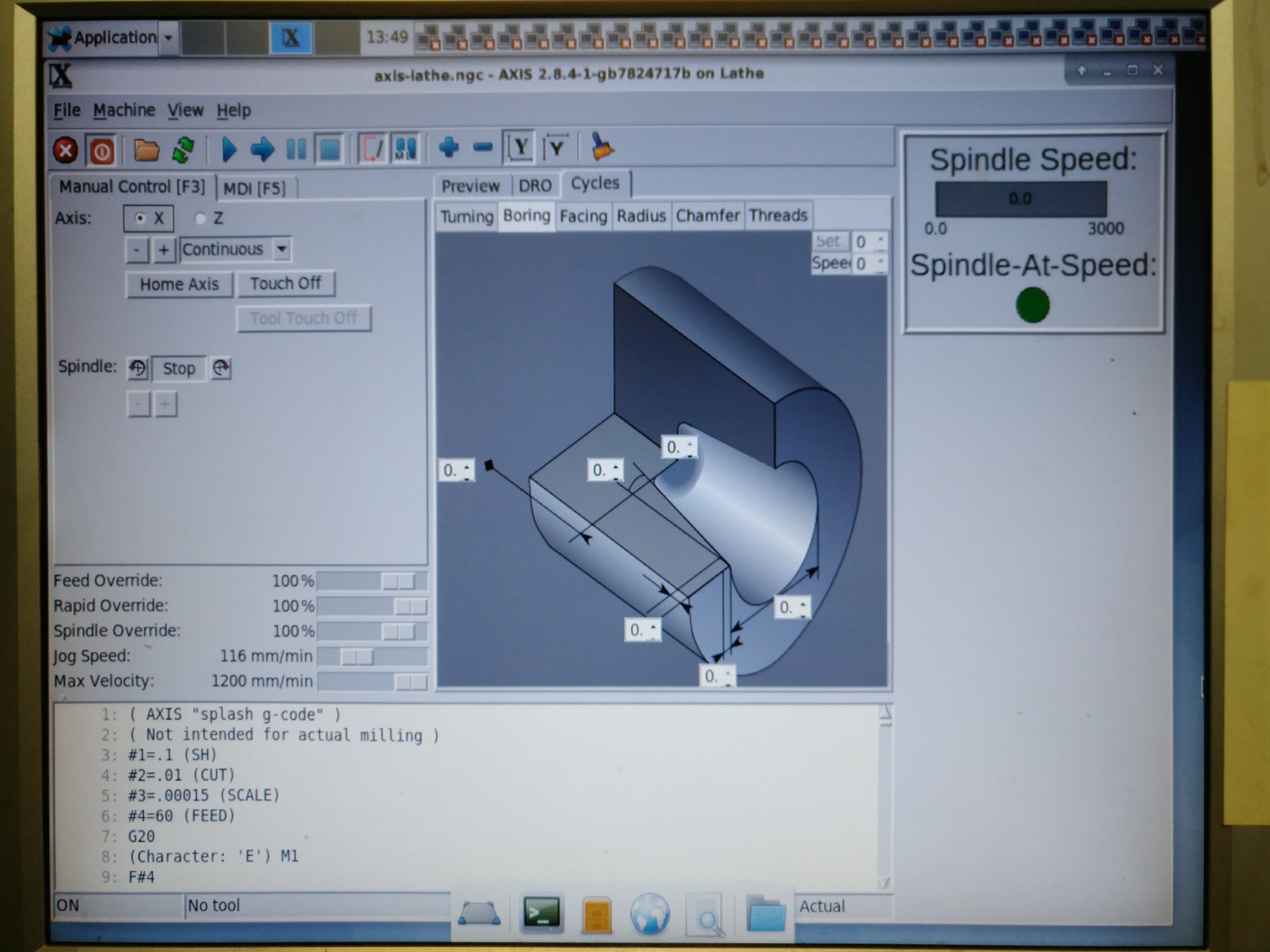

18 Mar 2023 12:22 - 18 Mar 2023 12:54 #266986
by O.R
I tried to change button image and also copy that play button to other place, but cannot see it in linux cnc. I tried add new button, but cannot see. If I copy some spintexbox, I can see that change. If you mean machine control widgets, yes i can see and use those. Here is some attached photos.

18 Mar 2023 12:56 #266994
I think that maybe, for some reason, the button is off the bottom of the screen.
It shouldn't be, the grid is meant to re-size. But maybe the entry boxes are constraining how small the table/grid can be.
Try moving the button to a different cell in the table, see if it then shows, up.

19 Mar 2023 19:26 #267099
by O.R
I moved button different places and tried add different types of buttons, only Hal_LightButton showed up, but i'm not is it suitable for play button.
19 Mar 2023 19:48 #267100
Sorry, I really have no idea what the problem is.
You might have to put the button in a frame, and make the frame visible too. (you can see the object hierarchy on the tree browser on the top right)
The v3 macros might work better. They will work on Buster if you install LinuxCNC 2.9.
